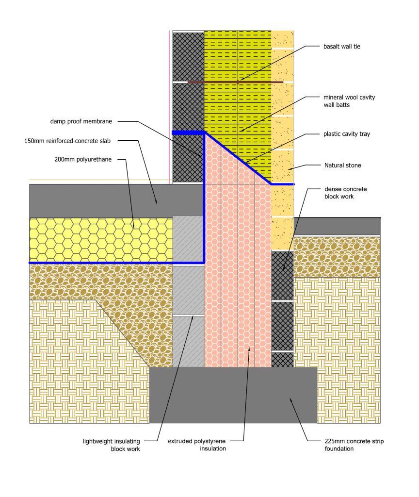

Iceverge Posted May 24, 2022 Share Posted May 24, 2022 13 hours ago, coconutsaregood said: more expensive insulant (not choosing sticky beads) What are you planning on using? Link to comment Share on other sites More sharing options...

coconutsaregood Posted May 24, 2022 Author Share Posted May 24, 2022 46 minutes ago, Iceverge said: What are you planning on using? the cheapest thermal insulation with a tolerance to rain penetration at the time of ordering. Currently it is treated glass wool in batt form or blown-in complete fill (fingers crossed the wider cavity stops the crossover of rain moisture). Link to comment Share on other sites More sharing options...

joe90 Posted May 24, 2022 Share Posted May 24, 2022 35 minutes ago, coconutsaregood said: the cheapest thermal insulation with a tolerance to rain penetration at the time of ordering. Currently it is treated glass wool in batt form or blown-in complete fill (fingers crossed the wider cavity stops the crossover of rain moisture). This is exactly what I used, full fill in a brick/block cavity, BBA certificate, and I know damp does not migrate across it (damp penetration of brickwork, but not across insulation after building) also it’s not a petro chemical product which I prefer not to use (but had to under the concrete floor as rockwall would collapse 😱.) 1 Link to comment Share on other sites More sharing options...

Iceverge Posted May 24, 2022 Share Posted May 24, 2022 5 hours ago, coconutsaregood said: the cheapest thermal insulation with a tolerance to rain penetration at the time of ordering. Currently it is treated glass wool in batt form or blown-in complete fill (fingers crossed the wider cavity stops the crossover of rain moisture). The beads and batts are the best for rain AFAIK. Beads are pretty much standard fit here in Ireland for new builds. Mostly 200mm cavities. I've not heard any horror stories. 1 Link to comment Share on other sites More sharing options...

Mr Punter Posted May 24, 2022 Share Posted May 24, 2022 1 hour ago, Iceverge said: Beads are pretty much standard fit here in Ireland for new builds. Mostly 200mm cavities Really? What do they use for wall ties and lintels? Must be a wider bucket on the digger as well. Link to comment Share on other sites More sharing options...

Iceverge Posted May 24, 2022 Share Posted May 24, 2022 5 hours ago, Mr Punter said: Really? What do they use for wall ties and lintels? Must be a wider bucket on the digger as well. Stainless steel wall tiles. Off the shelf in most BMs here. Seperate precast concrete lintels or steel beams depending on span. Catnics are relatively unusual. Typically a 1050mm foundation. 42" bucket or a 3ft with a bit of extra wiggling. 1 Link to comment Share on other sites More sharing options...
joe90 Posted May 25, 2022 Share Posted May 25, 2022 9 hours ago, Roger440 said: Can i ask what you used? Gosh can’t remember but rockwall insulation batts 100mm x2 staggered. My builder was not sure about full fill but they had a BBA certificate for this. After the build was finished the west wall got soaked through winter rains and when I core drilled fir the ASHP pipes I found the insulation had not absorbed the wet at all even though the bricks were soaked. I have since treated the bricks just in case. 1 Link to comment Share on other sites More sharing options...
joe90 Posted May 25, 2022 Share Posted May 25, 2022 7 hours ago, Iceverge said: Stainless steel wall tiles. Off the shelf in most BMs here. Seperate precast concrete lintels or steel beams depending on span. Catnics are relatively unusual. Typically a 1050mm foundation. 42" bucket or a 3ft with a bit of extra wiggling. Yes longer ties off the shelf, I used concrete internal skin lintels and brick arches for the outer, no thermal bridging. my founds were dug with a standard bucket but driver widened them as required to non standard width. 1 Link to comment Share on other sites More sharing options...
SteamyTea Posted May 25, 2022 Share Posted May 25, 2022 Just now, joe90 said: my founds were dug with a standard bucket but driver widened them as required to non standard width. Is it block and beam your foundation? Link to comment Share on other sites More sharing options...
joe90 Posted May 25, 2022 Share Posted May 25, 2022 Just now, SteamyTea said: Is it block and beam your foundation? No, standard strip founds. Link to comment Share on other sites More sharing options...
SteamyTea Posted May 25, 2022 Share Posted May 25, 2022 2 minutes ago, joe90 said: No, standard strip founds. Right. Don't suppose you have the thermal bridging mitigation details to hand. Link to comment Share on other sites More sharing options...
joe90 Posted May 25, 2022 Share Posted May 25, 2022 Here is a pic from the internet that I followed but, the internal DPC was lowered to floor level as my builder says if it’s still that high it causes a slip plane above the skirting, to mitigate this he inserted a second DPC on the outside skin 15pmm above ground level. The whole house is surrounded by a French drain anyway because of the high water table 1 Link to comment Share on other sites More sharing options...
