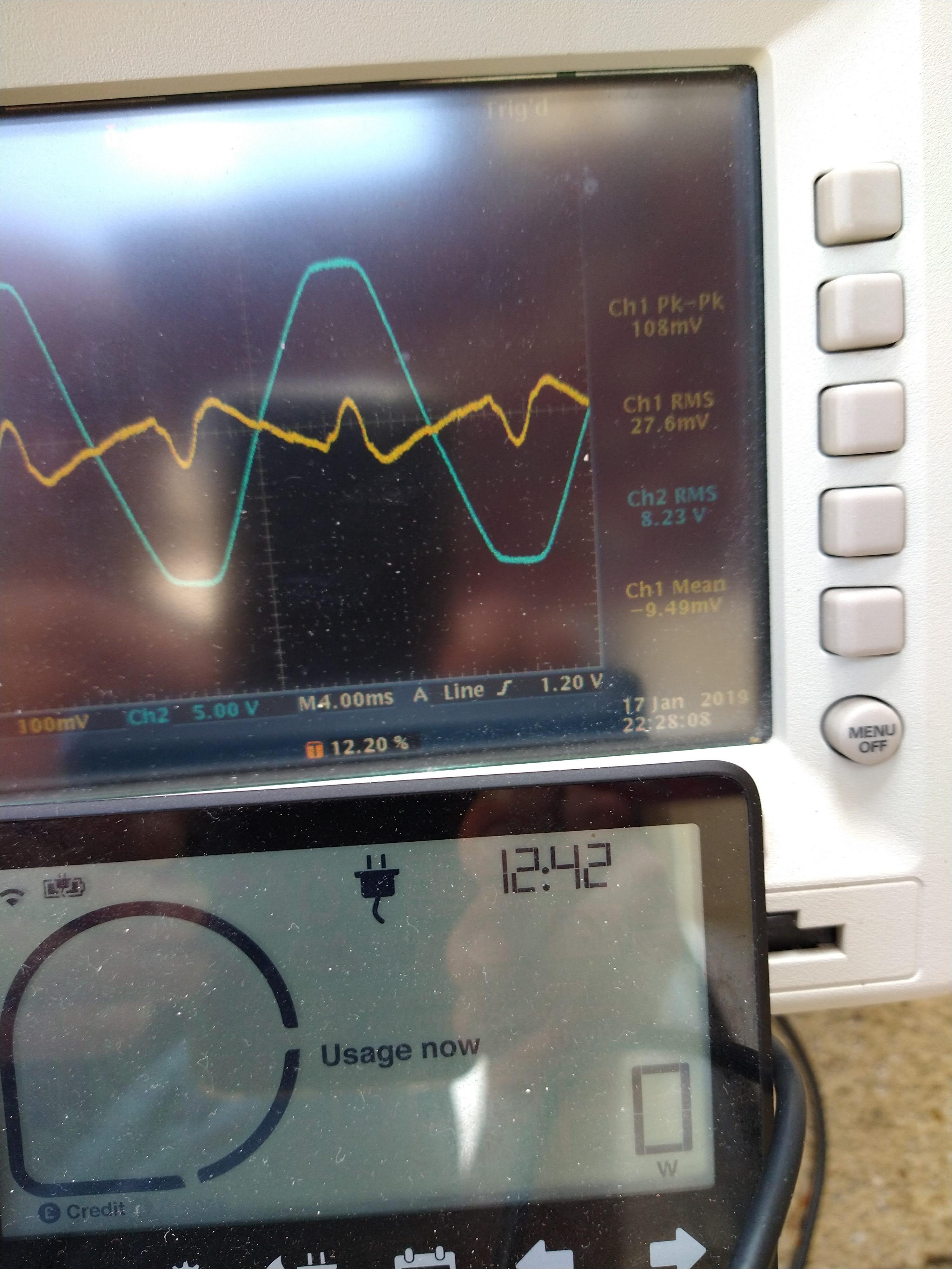

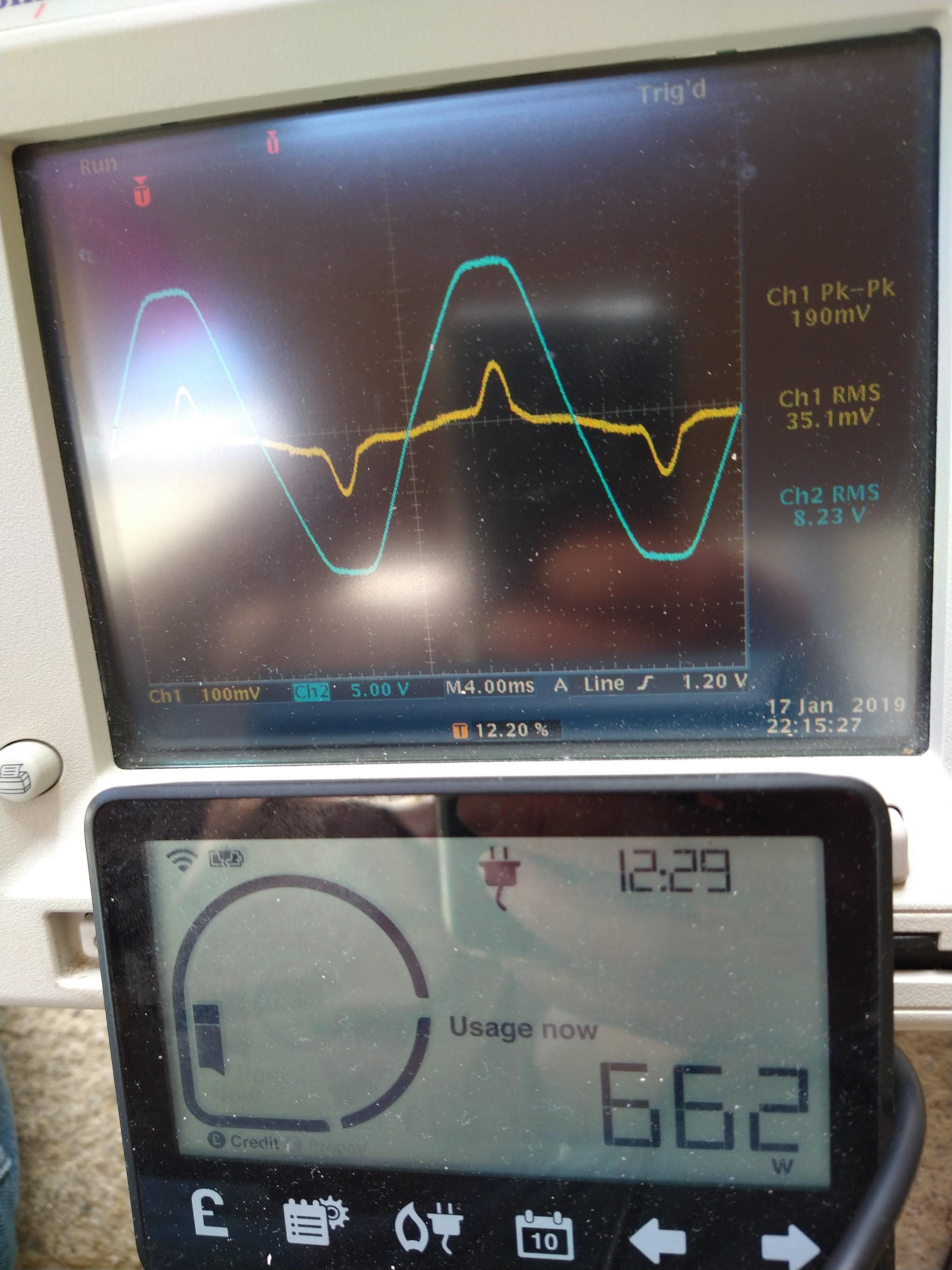

Radian Posted May 16, 2022 Share Posted May 16, 2022 Always feels a bit pretentious starting a thread in Boffin's corner but I guess it's best to keep electronics & coding out of the other sub forums. Anyhow, I'm messing around with a bit of an 'old chestnut' - a device that spots power being exported to the National Grid and intervenes to dump it into something more useful such as a DHW cylinder immersion heater. Being tight, and having a comprehensive store of electronics parts to hand, I feel compelled to roll my own - as has been done by numerous others before me - such as Robin Emley and, I believe, our own @ProDave So far all I have is a small mains transformer, a couple of CT's and a scope looking at what happens when a grid-tied inverter pushes more into the grid than is coming out and I'm already seeing issues. First photo shows relation between voltage and current during base-load 662W import: The voltage waveform (blue) is typical of a small 240VAC transformer saturating (not the ideal way to represent the mains waveform but hey, it's safe). The current waveform (yellow) is 'peaky' in the middle of the cycle showing just how much of my ~700W baseload is capacitive - i.e. lots of switch-mode PSU's rectifying the AC and recharging their reservoir capacitors after partial discharge between cycles. So far so good I guess although I don't like the idea of sampling the distorted voltage waveform. Next photo is when the Sun comes out: Oops, 0 Watts imported, who knows how many exported then? That's my task here now. So the current due to the resistive component of the baseload is starting out from the zero crossing and immediately being cancelled out by the inverter which manages to push the current drawn into negative territory, until it gets overwhelmed by the capacitive loading later in the cycle. The inverter loses the fight near the middle of the cycle and current begins to flow back in from the grid. But on balance, over the whole cycle, more current was going out than coming in hence the utilities smart meter shows zero (it doesn't show export amount but the meter logs it in one of its registers - 1.1kWh so far!). The scheme seems to be to measure the real power, retaining its sign, on every cycle and keeping a running total such that when it reaches a certain (-ve) threshold (before 3600 Joules is reached) it triggers the Immersion heater to 'claw back' the same amount of Joules to keep from tipping the meter into registering an export. Thus filling and emptying a so called 'energy bucket'. Makes sense. But a few questions arise - how quick does the triggering of the Immersion load have to be? Can it be made less critical by setting a lower threshold? I ask because I can't easily wire directly from the meter area to the immersion so I guess a wireless solution is required and these all have a degree of latency. What are the other significant challenges I wonder? 1 Link to comment Share on other sites More sharing options...

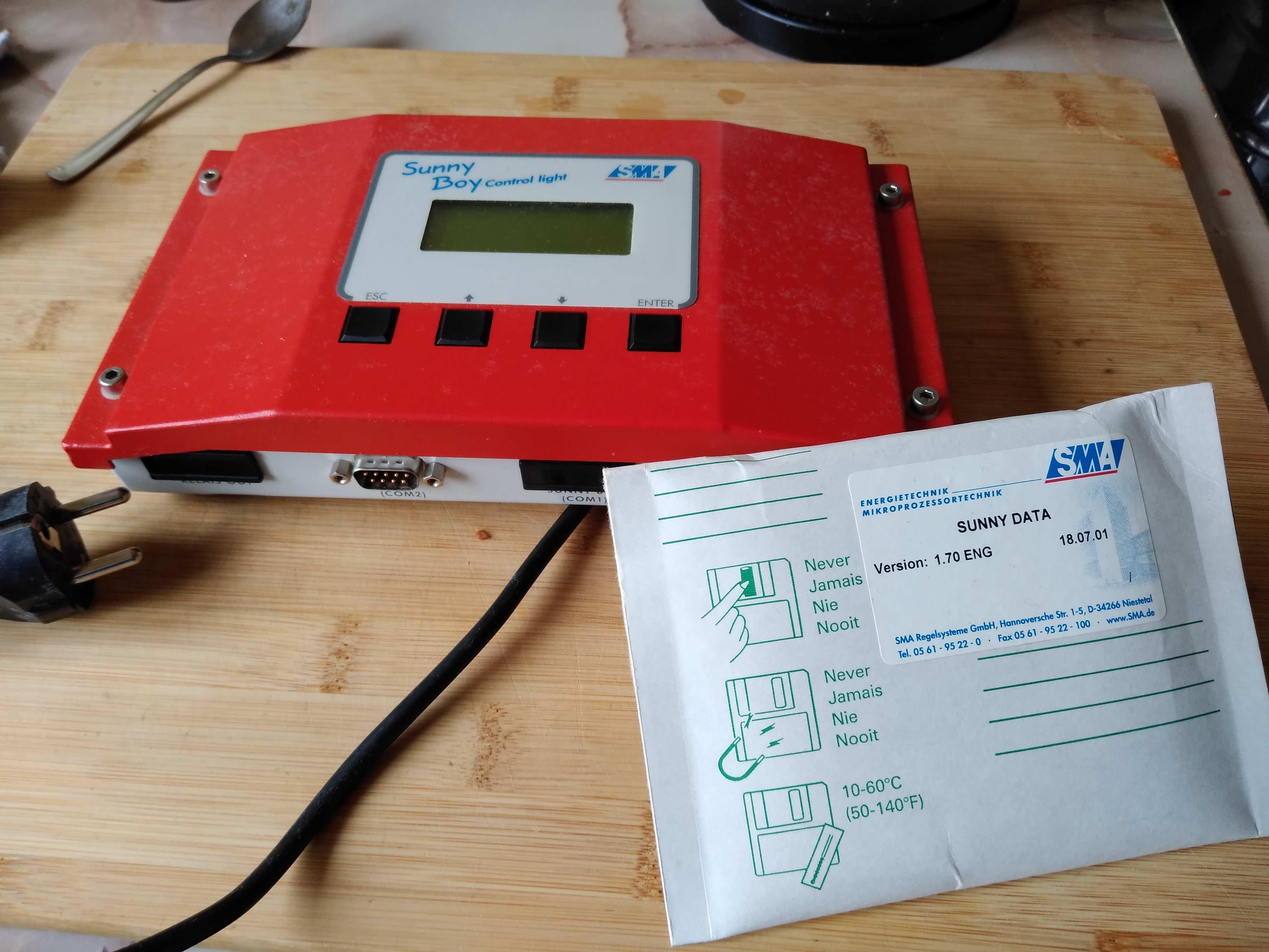

SteamyTea Posted May 17, 2022 Share Posted May 17, 2022 (edited) Had a thought. Can you sense and measure the DC side for generation, then compare to the import AC side. I have one of these that I once thought may be useful, going to dump as it has been in loft for a decade. Can you hack into it, or use it for parts. Can deliver next Monday as i fancy passing my mates tombstone. Edited May 17, 2022 by SteamyTea Link to comment Share on other sites More sharing options...
Radian Posted May 17, 2022 Author Share Posted May 17, 2022 1 hour ago, SteamyTea said: Can you hack into it, or use it for parts. A very kind offer indeed but it'd be a shame to butcher an Iconic bit of 90's renewable energy tech like that! I bet it'd get snapped up on Ebay. Actually it has given me a very useful idea - the Sunny Boy comms uses X10 style mains signalling and that could be a simple low-latency control method to fire-up the immersion (sort of like tagging individual mains cycles for consumption). I dabbled with that in the 90's so could dust down some old kit to try if and when I get that far. Link to comment Share on other sites More sharing options...
SteamyTea Posted May 17, 2022 Share Posted May 17, 2022 (edited) 6 minutes ago, Radian said: t'd be a shame to butcher an Iconic bit of 90's renewable energy tech like that! I bet it'd get snapped up on Ebay. Off to the dump, will be is the skip with an old laptop in an hour. Got a couple of large boxes of PC hardware. Most of that will be going to the dump soon. Don't think many people need 1990s components like graphics cards, sound cards, dial up modems and memory modules up to 1 Mb. Or a 40 Mb hard drive. Edited May 17, 2022 by SteamyTea Link to comment Share on other sites More sharing options...

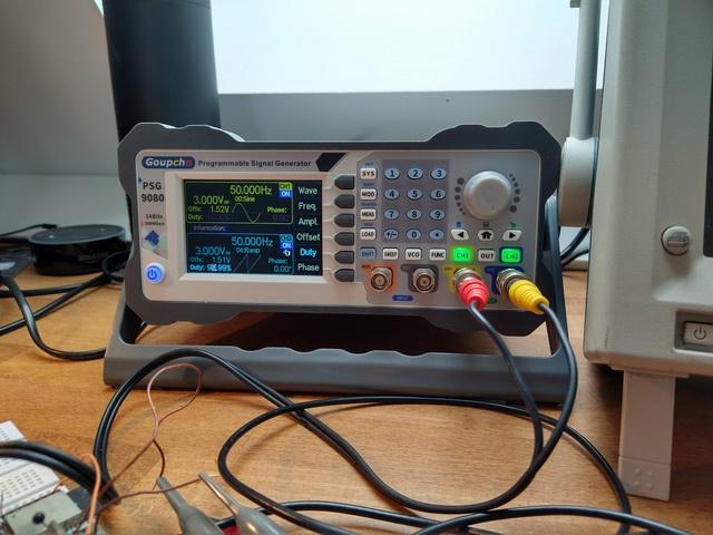

Radian Posted May 20, 2022 Author Share Posted May 20, 2022 Small progress report. Still sticking to the plan regarding choice ESP32 as processor. One of the reasons is the ability to do firmware updates over WiFi so once it's in place I can tweak code from anywhere. This also provides full galvanic isolation so I can measure the 240VAC directly with reference to Neutral and dispense with the sinewave distortion and phase shift inherent in transformer coupling. While there are specialist transformers specifically for this purpose it's a bulky solution. People in parts of the world on 110VAC are lucky as they can cheaply wire transformers with split primary 110V windings in series and get non-staurated AC at half the output voltage for measurement purposes. A series pair of 1meg resistors (for safety) as part of a voltage divider with 10K is all it takes to turn 240VAC into a 3V swing for the ADC. Another benefit of having an embedded web server at the end of a huge huge air gap is that I can create scope-like images of the waveforms in a bitmap (with an arbitrary number of traces) to keep an eye on everything. Example proof-of-concept bitmap just collected from my browser: Oh dear, the ESP32 ADC isn't very linear. That's a pair of test waveforms from this function generator: Still, it's a start. Link to comment Share on other sites More sharing options...
SteamyTea Posted May 20, 2022 Share Posted May 20, 2022 14 minutes ago, Radian said: This also provides full galvanic isolation so I can measure the 240VAC directly with reference to Neutral and dispense with the sinewave distortion and phase shift inherent in transformer coupling ......... 15 minutes ago, Radian said: A series pair of 1meg resistors (for safety) as part of a voltage divider with 10K is all it takes to turn 240VAC into a 3V swing for the ADC. Quite interested in this. Can you post up a diagram. I have some ESP8266 that I can play with. Link to comment Share on other sites More sharing options...
Radian Posted May 20, 2022 Author Share Posted May 20, 2022 14 minutes ago, SteamyTea said: Quite interested in this. Can you post up a diagram. I have some ESP8266 that I can play with. Uh oh! It's live mains we're talking about so I don't know where to stand on this request! I've been wiring things directly to the mains since I was around 16 years old and kind of have a second sense about working around lethal voltages. There's nothing physically wrong with doing it, but given the dangers there's usually a lot of pressure to use alternatives involving transformers or opto isolators. But this is one case where direct connection can be desirable. There are plenty of examples on the web such as this one but using an OpAmp, like the one in that link, is optional for a real bargain basement mess around. My initial test circuit is about as simple as you can get: Anyway, it illustrates the point. Actually, to put things into perspective, I have some Touch Dimmers around the house that use a couple of high-value resistors connecting the touch plate to the phase control circuit at line voltage. You get a little tingling sensation off these things but the uA current through the body to Earth is harmless enough for them still to be sold on the open market. Same thing as above really. Link to comment Share on other sites More sharing options...
