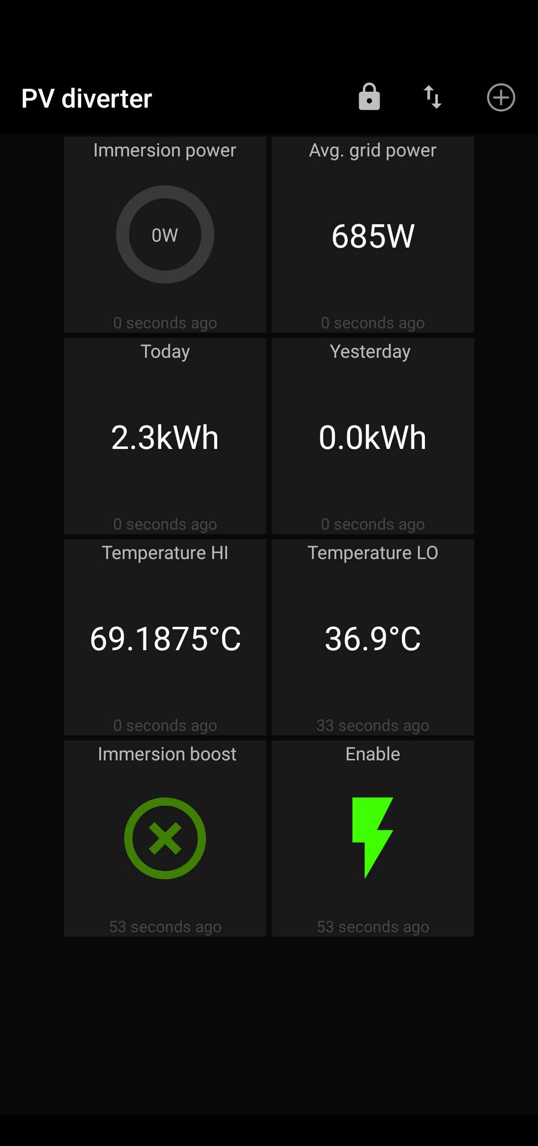

Now we've had some decent Solar and have been diverting useful amounts of energy, I made a control panel for my phone using the MQTT messages sent by the diverter:
Can anyone think of any extra info I could show?

1 hour ago, SteamyTea said:
Decimal place rounding on the Temperature HI.
Isn't it funny. I remember noticing that immediately and thought "gotta round that down" then promptly left it like that.
I really ought to get into the habit of making a to-do list but I've been resisting my entire life. I think I once thought it'd  be better for the grey matter to remember stuff rather than write it down, then persisted in that belief way beyond the time when it might have been appropriate.
Yes me too - now I need a pay it to remind me to make a list.
PS that is some ADC, and sensor combi that can resolve to 4dp over 100 degree range 1 in a million or is this wine getting to me.
Link to comment
Share on other sites
It's somehow morphed from the original value read back from a DS18B20, put in a JSON object, sent over MQTT then turned back into a FP value.😝
