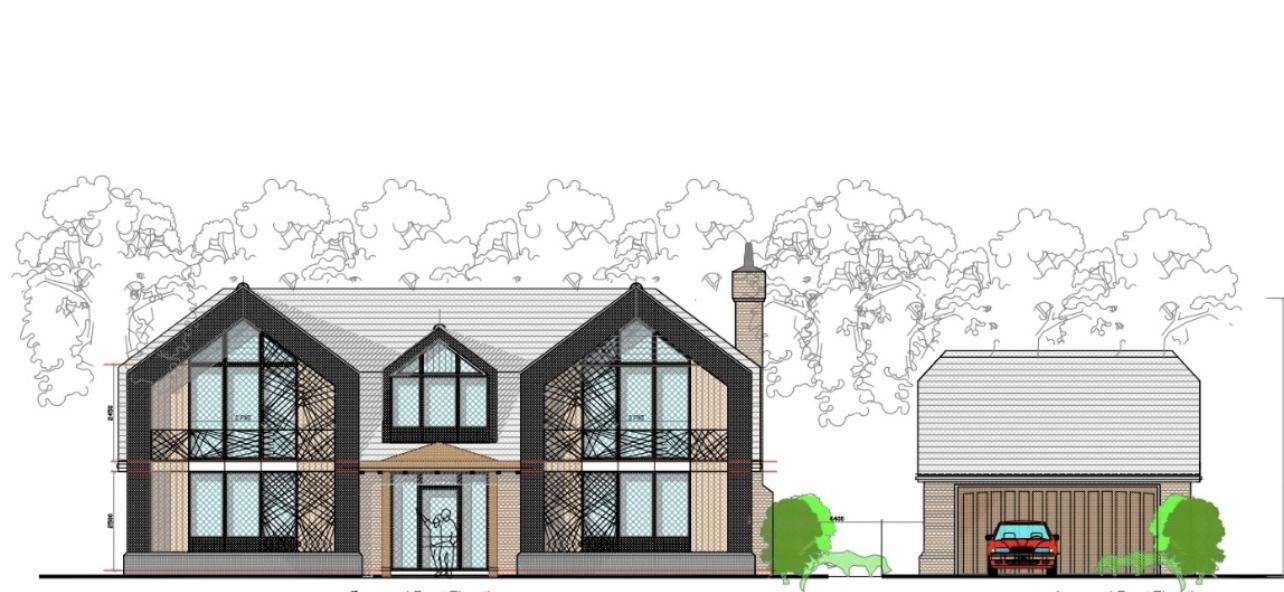

Savills2 Posted May 12, 2022 Share Posted May 12, 2022 Hi, I’m new to this site, we’ve just got planning permission to build a 3200sqf house, after waiting a year. we built a hse 15 years ago so we have a little knowledge about building. just looking for some advice on costing please. we have agreed a price on timber frame. foundation's are our problem. strip foundation block & beam drainage to treatment plant. quotes of 72k am I out of touch or is this expensive Link to comment Share on other sites More sharing options...
Ronan 1 Posted May 12, 2022 Share Posted May 12, 2022 Very hard to tell, is there any leveling to do on site, any muck away? Is the foundations deep? Depth of fill required? Is the ground good or bad? What type of treatment plant? And as discussed here a fair bit Location Location, Location makes a massive difference. P.s really nice looking house 1 Link to comment Share on other sites More sharing options...
nod Posted May 12, 2022 Share Posted May 12, 2022 I’ve just completed our foundations and drainage Muck out stone in All very expensive As on our previous build It’s the only part that you can not accurately predict The only way a company will do a fix quote Is to load the quote 1 Link to comment Share on other sites More sharing options...
Conor Posted May 12, 2022 Share Posted May 12, 2022 I found it impossible to get a fixed cost for my groundworks. Too many unknowns. Ended up doing time + materials with a friend and worked out ok. Less than expected and muck away costs were half of what I'd assumed. 1 Link to comment Share on other sites More sharing options...
Faz Posted May 12, 2022 Share Posted May 12, 2022 There is a lot going on here which may belong in different packages. Looking at the fundamentals - Setting out - £not much Digging the strip - 5.5T digger and a dumper for a week with 2 blokes - £1500 - 2k concrete - depending on the depth at whatever rate you have per cubic m - you are probably going to get through £15k of concrete + at current pricing Then you want to get your brickies in to take it to the beam level Groundworkers or whoever (easy to do yourself) to set the below ground drainage and water duct etc) and take out past the foundation - you don't want to be worrying about the septic tank and soakaway at this point Whoever to do the beam and block (again easy to do with a mate or two). I did 2 x 1,650 sq. ft plots plus my 3,000 sq. ft. house with floorspan E-floor Plus for £6,500 including installation (I couldn't be arsed tbh) Brickies to splash Don't see how that adds up to £75k although someone is offering to take away your hassle at a big markup. 1 Link to comment Share on other sites More sharing options...
SBMS Posted May 12, 2022 Share Posted May 12, 2022 Seems high. Our foundations have just been dug on our build. All contractor managed: House and garage strip foundations excavated and concreted - £17k Build to DPC on house and garage, drains and scaffold mat - £12k Block and beam to house and concrete slab for garage - £10k Services for water and drainage etc were brought to our site at a previous phase but still our groundworks are less than 40k this is for a double garage and 12m x 11m footprint house. 1 Link to comment Share on other sites More sharing options...

Savills2 Posted May 13, 2022 Author Share Posted May 13, 2022 Thank you for shredding some light, I have got some quotes myself for materials, it’s obviously the labour that is the problem 35/45k I think I’m in the wrong trade 🙈 I will keep trying. Link to comment Share on other sites More sharing options...

Bitpipe Posted May 13, 2022 Share Posted May 13, 2022 57 minutes ago, Savills2 said: Thank you for shredding some light, I have got some quotes myself for materials, it’s obviously the labour that is the problem 35/45k I think I’m in the wrong trade 🙈 I will keep trying. Have you done ground investigation and do you have a SE signed off foundation design? Anything tricky about your site - access, slope, ground composition? Have you looked into an insulated raft foundation and compared labour / materials etc? Insulated raft is similar to ICF so you may be able to do some of the work yourself to save on labour costs, or not require as much labour as you're not excavating down. Also, some TF companies like MBC will do an insulated slab as part of their package but will not do preparatory groundworks. 1 Link to comment Share on other sites More sharing options...
DragsterDriver Posted May 13, 2022 Share Posted May 13, 2022 3 hours ago, nod said: Extremely optimistic Ive just finished doing them myself and quickly went through 50 k On good ground Buying the tank and underground drainage has cost 8 k Concrete and stone in as cost 20 k plus Pipe bedding has cost 2 k Muck away would have cost a fortune But I brought a dozer in to bury the clay £500 plus vat per day Don’t underestimate the GE costs Grab lorry’s went up £50 each grab a couple of weeks ago, no more red diesel for plant. The price of rebar is up 30% I think? Just can’t keep up. 1 Link to comment Share on other sites More sharing options...
nod Posted May 13, 2022 Share Posted May 13, 2022 33 minutes ago, DragsterDriver said: Grab lorry’s went up £50 each grab a couple of weeks ago, no more red diesel for plant. The price of rebar is up 30% I think? Just can’t keep up. Yep Muck away is going up daily Massive fines for farmers taking muck away and the plot owner 2 Link to comment Share on other sites More sharing options...
Savills2 Posted May 14, 2022 Author Share Posted May 14, 2022 21 hours ago, Bitpipe said: Have you done ground investigation and do you have a SE signed off foundation design? Anything tricky about your site - access, slope, ground composition? Have you looked into an insulated raft foundation and compared labour / materials etc? Insulated raft is similar to ICF so you may be able to do some of the work yourself to save on labour costs, or not require as much labour as you're not excavating down. Also, some TF companies like MBC will do an insulated slab as part of their package but will not do preparatory groundworks. Link to comment Share on other sites More sharing options...
Savills2 Posted May 14, 2022 Author Share Posted May 14, 2022 Yes we’ve had a ground investigation done, nothing unforeseen, flat site We are now trying to look into other options. fingers crossed we have better luck. Link to comment Share on other sites More sharing options...
