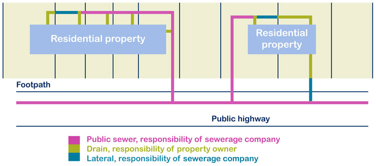

When I bought this place I took out a one off insurance to cover the shared sewage pipe that crosses my land.
A few years back I had notification that SW Water had taken over responsibility of all the sewage pipes.
Never got any of my money back from the insurance company.
Hi Steamy, even taking over private sewage?
seen this on the SW website,  image.thumb.png.6cf1728b28adbbebadb4f4151f525171.png
Well I think this is the whole thing.
The pipeline was private, though connected to public sewers.
No idea if the final sewage treatment is private, with only the pipework crossing your land.
I would give the local water company a call and ask.

Have you a link for your image - my neighbor has a similar issue, as @Mike_scotland, which by the looks of that diagram they don't if you get my drift.
If the pipe is the property of the sewage company does that mean no easements are needed?
15 hours ago, Temp said:
Would not all the properties without connection running into the public highway sewer not need easements across all the properties. SO the left most property above will need 4 easements, the next 3 and so on?
