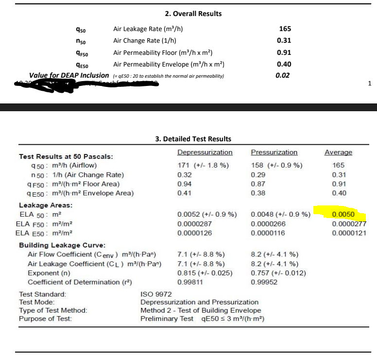

Iceverge Posted May 2, 2022 Share Posted May 2, 2022 (edited) 20 hours ago, Helen2 said: We are not looking for passive house type standards of airtightness but do want to make the most of our MVHR system. Why not? It's achievable with a little forethought. Watch the Denby Dale videos on youtube. Here's the first one. 20 hours ago, Helen2 said: without chasing after full <1 ach PH standards (which would not be affordable or achievable). We did all our own airtightness with no training or prior experience, wet plaster and block built. Materials were probably under €1000 including membranes for the ceiling. Key point, swere having a very exact plan from the outset and attention to detail but we got 0.31Ach. Beware the " close enough is good enough" method with this as missing just a few key details will leave you disappointed. Forget @SteamyTeas expensive suggestions. He must be made of money!! This taped into a sheet of osb sealed into an opening, connected to your car battery with cable and crocodile clips will depressurise your house to a level that far exceeds a blower door. Then ram a candle into a length of electrical conduit and you have a £3 super sensitive leak detector. Edited May 2, 2022 by Iceverge Link to comment Share on other sites More sharing options...

Iceverge Posted May 2, 2022 Share Posted May 2, 2022 3 hours ago, MikeSharp01 said: So where were the leaks that were still left? I don't know. I suspect it was an aggregate of pin holes in the scratch coat of wet plaster in the external walls. I couldn't find any more leaks myself. I'd be interested to redo it since the final layer of sand cement and skim was applied. Also one shower tray was just open to the insulation below as it hadn't been installed. The 400mm of cellulose pumped into the attic since should help also. Also there is a small leak from the corner of the window that I had the DIY blowerdoor installed as I couldn't pretest that. Link to comment Share on other sites More sharing options...
MikeSharp01 Posted May 2, 2022 Share Posted May 2, 2022 26 minutes ago, Iceverge said: I couldn't find any more leaks myself. I'd be interested to redo it since the final layer of sand cement and skim was applied. Also one shower tray was just open to the insulation below as it hadn't been installed. The 400mm of cellulose pumped into the attic since should help also. That's interesting, what I was wondering then is how big a hole is .31ACH? Link to comment Share on other sites More sharing options...
MikeSharp01 Posted May 2, 2022 Share Posted May 2, 2022 13 minutes ago, MikeSharp01 said: how big a hole is .31ACH? I guess the 0.31 is the passive house methodology eg air change rate h-1 @ 50 Pascals. Link to comment Share on other sites More sharing options...
Iceverge Posted May 2, 2022 Share Posted May 2, 2022 It depends on the size and shape of the house. For us it was 50cm2, slightly more than the size of a credit card. If you look at leakage areas below you'll see the ELA F50 at 0.0000277m2/m2. This equates to a 6mm diameter hole drilled per m2 of building envelope or 1 part per 36000. If you had a less square building with more surface area but the same volume and floor space this number allowed per m2 would drop. Typically large buildings with low amount of external surfaces are easiest to get good ACH figures on mathematically (and practically). Small ones with complex forms are the worst. Link to comment Share on other sites More sharing options...
MikeSharp01 Posted May 2, 2022 Share Posted May 2, 2022 So is your building 532m3 ? Not sure how the shape of the building make any difference to the maths but I can see why it makes a big difference to the build challenges. Our build is 465m3 so next stop is to work out what our holes can add up to Link to comment Share on other sites More sharing options...
Iceverge Posted May 3, 2022 Share Posted May 3, 2022 Correct. 532m³ I don't know if the leakage scales proportionally. If it did I guess you would be about 80cm2 for 0.6ACH Link to comment Share on other sites More sharing options...
