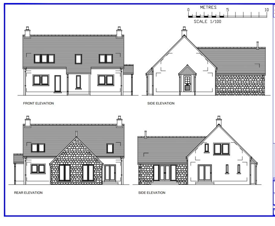

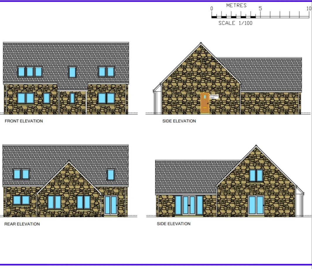

Amateur bob Posted May 1, 2022 Share Posted May 1, 2022 Im trying to pick a render which will help the application look less like a town house in the countryside my designer has come up with two options, a full sandstone option and a white render/stone option he recons with full sandstone it wont work out much dearer as its one trade as opposed to 2, what do people think of them looks wise and cost, thanks! Link to comment Share on other sites More sharing options...
ProDave Posted May 1, 2022 Share Posted May 1, 2022 I would say go with what matches the local vernacular. Remind us where you are? Up here it would be the white render, but whatever you do that is not going to be mistaken for a town house. Link to comment Share on other sites More sharing options...
CharlieKLP Posted May 1, 2022 Share Posted May 1, 2022 I quite like the mix, but those windows (especially on the side) are all over the place. In the first one that had some rationality to them, did the planners ask you to make the windows more random like a barn? Link to comment Share on other sites More sharing options...
nod Posted May 1, 2022 Share Posted May 1, 2022 I run a render company and WE can’t make up our minds We went for sharp lines on our first But my wife wants a K roughcast It’s probably worth doing a couple of different test panels Then at least you can decide what you don’t like Link to comment Share on other sites More sharing options...
Amateur bob Posted May 1, 2022 Author Share Posted May 1, 2022 3 hours ago, ProDave said: I would say go with what matches the local vernacular. Remind us where you are? Up here it would be the white render, but whatever you do that is not going to be mistaken for a town house. im in central Scotland, rural area, the house is quite visible from the main road which was an issue in the previous application which was 2 storey and all white render, with lowering ridge height in this design and some stone cladding i was hoping to reduce the visual impact? Link to comment Share on other sites More sharing options...
Amateur bob Posted May 1, 2022 Author Share Posted May 1, 2022 2 hours ago, CharlieKLP said: I quite like the mix, but those windows (especially on the side) are all over the place. In the first one that had some rationality to them, did the planners ask you to make the windows more random like a barn? no that was just the stock design but my designer has altered it in the first one to simplify the design, this could easily be done on the mix one thanks 1 Link to comment Share on other sites More sharing options...

CharlieKLP Posted May 2, 2022 Share Posted May 2, 2022 18 hours ago, Amateur bob said: no that was just the stock design but my designer has altered it in the first one to simplify the design, this could easily be done on the mix one thanks They have done a really nice job! I do like the first one, full stone could be nice depending on what stone you are going to use. Did you have a Google for one yet? Link to comment Share on other sites More sharing options...

Amateur bob Posted May 2, 2022 Author Share Posted May 2, 2022 1 hour ago, Iceverge said: When figuring this out for our house I looked no further than some old farm buildings. Sand cement sponged finish. It's lasted 70 years with zero maintenance or paint on a cow stall grandad built. No cracks and still as level as the day it was applied. Also materials are hella cheap. €2k buys a tremendous amount of plastering sand, cement and lime. Some planting near the house softens up the look nicely thereafter. interesting, what do you think of cladding a whole house in sandstone as proposed? will it make the house look smaller? Link to comment Share on other sites More sharing options...
Iceverge Posted May 3, 2022 Share Posted May 3, 2022 I discounted stonework very early on at its close to €100/m2. I couldn't say really re the size Link to comment Share on other sites More sharing options...
Amateur bob Posted May 4, 2022 Author Share Posted May 4, 2022 14 hours ago, Iceverge said: I discounted stonework very early on at its close to €100/m2. I couldn't say really re the size im told though it saves and blockwork and render though so saves 2 trades? Link to comment Share on other sites More sharing options...
Simplysimon Posted May 4, 2022 Share Posted May 4, 2022 On 02/05/2022 at 13:12, Amateur bob said: interesting, what do you think of cladding a whole house in sandstone as proposed? will it make the house look smaller? depends, the sandstone, is it going to be stone or a manufactured one, dressed or random or a mix? the render, smooth or roughcast? Link to comment Share on other sites More sharing options...

Amateur bob Posted May 10, 2022 Author Share Posted May 10, 2022 On 06/05/2022 at 18:31, Simplysimon said: if all sandstone i would be looking at a mix of dressed and random, i feel all random is too much. roughcast especially is a traditional look if self coloured saves painting! at the end of the day it's your property and choice. Im on a farm and have plenty old sandstone dykes some of which have been removed to widen gateways so i have plenty spare sandstone on site, would it be possible for me to get a professional to cut these to size and apply to house or would thisbe an expensive route? Link to comment Share on other sites More sharing options...

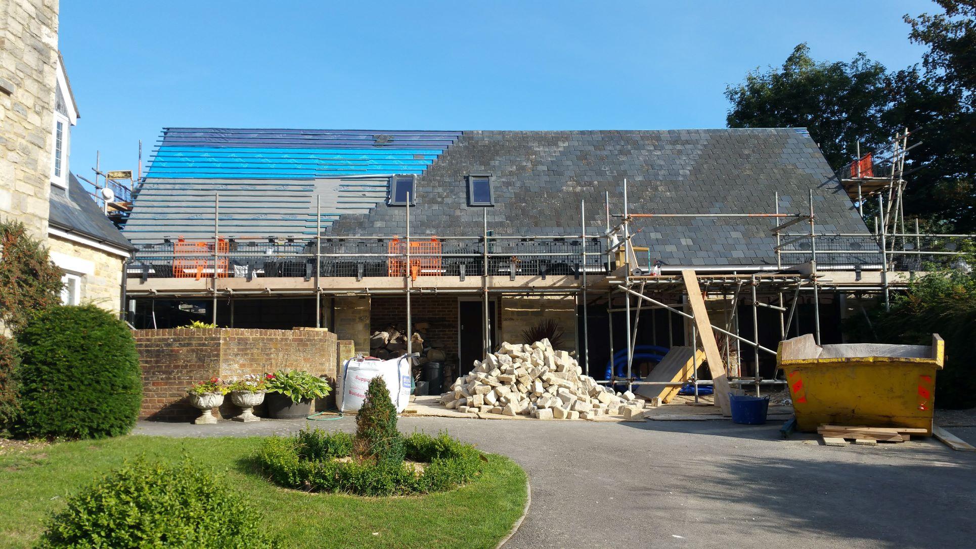

Radian Posted May 10, 2022 Share Posted May 10, 2022 Areas of your elevations are reasonably modest - I'd go with full sandstone. Not sure how your farm stone would clean up though. I was buying cropped walling stone from Purbeck which comes in random sizes but all fairly close to 120mm deep. Was £150/ton delivered the year before last and does about 4m2 per ton. Lay with a ginger sand and hideously expensive white cement or if you have a very strong orange sand you can get by with OPC (still looks buff coloured). 1 Link to comment Share on other sites More sharing options...
AliG Posted May 11, 2022 Share Posted May 11, 2022 In central Scotland a mix of render and sandstone would look much more normal although in a rural area the more rustic look might fit in. The all stone pictures probably don't do it justice so I am maybe biased by that. I would be very surprised if stone was cheaper. Best thing to do is get some quotes and see rather than speculate. You will need some stone anyway. Ultimately it is probably a few thousand pounds either way as there is not that much wall. So I would also consider what you prefer and whether the planners are happy with any render or not. Link to comment Share on other sites More sharing options...
Amateur bob Posted May 11, 2022 Author Share Posted May 11, 2022 3 hours ago, AliG said: In central Scotland a mix of render and sandstone would look much more normal although in a rural area the more rustic look might fit in. The all stone pictures probably don't do it justice so I am maybe biased by that. I would be very surprised if stone was cheaper. Best thing to do is get some quotes and see rather than speculate. You will need some stone anyway. Ultimately it is probably a few thousand pounds either way as there is not that much wall. So I would also consider what you prefer and whether the planners are happy with any render or not. thanks i think for the sake of a few thousand sandstone might be the way togo Link to comment Share on other sites More sharing options...
Amateur bob Posted May 11, 2022 Author Share Posted May 11, 2022 19 hours ago, Radian said: Areas of your elevations are reasonably modest - I'd go with full sandstone. Not sure how your farm stone would clean up though. I was buying cropped walling stone from Purbeck which comes in random sizes but all fairly close to 120mm deep. Was £150/ton delivered the year before last and does about 4m2 per ton. Lay with a ginger sand and hideously expensive white cement or if you have a very strong orange sand you can get by with OPC (still looks buff coloured). thanks did it save you on blockwork over the timber frame having the sandstone? do you have any pics of it completed/ Link to comment Share on other sites More sharing options...
Radian Posted May 11, 2022 Share Posted May 11, 2022 37 minutes ago, Amateur bob said: thanks did it save you on blockwork over the timber frame having the sandstone? do you have any pics of it completed/ The photo is WIP on a recent extension to our garage. This was done with blockwork. Most of the stone went into landscaping retaining walls to match the building. I posted it as it was the only photo I had showing the pile of cropped walling stone as delivered. 1 Link to comment Share on other sites More sharing options...
