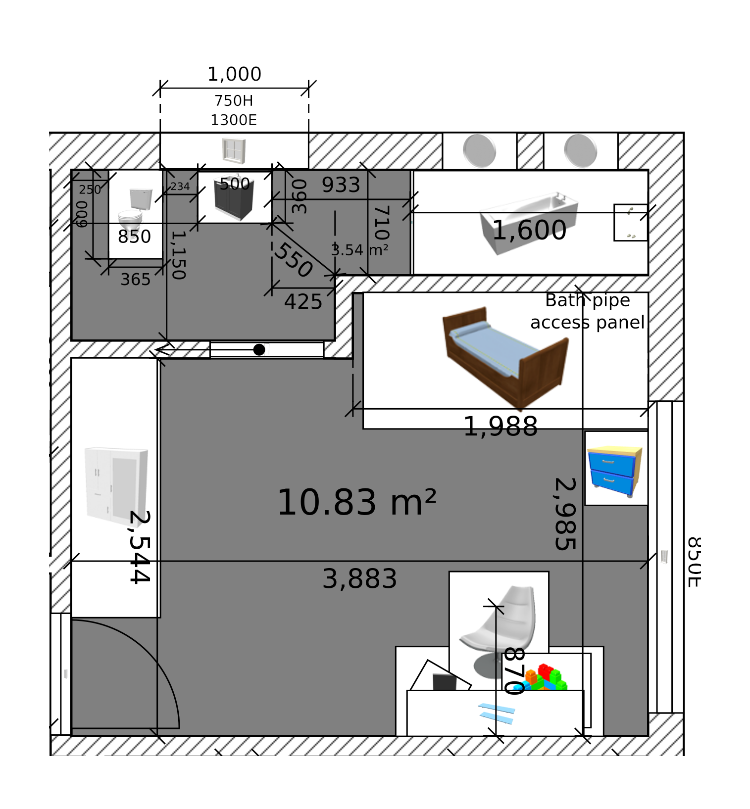

I am designing my sons bedroom, and want to make an en-suite, he spends hours in the bath reading so I want to put a bath instead of shower however I don't want to make his room too small so am thinking to put the width of the bath between 2 walls, I have searched and searched could not find any reference to anyone who has done this, is it a problem to do it this way? (regarding the tap and waste pipes I will make an access panel in the bedroom to reach it (it's noted in the sketch below)
(The entrance is a pocket door)

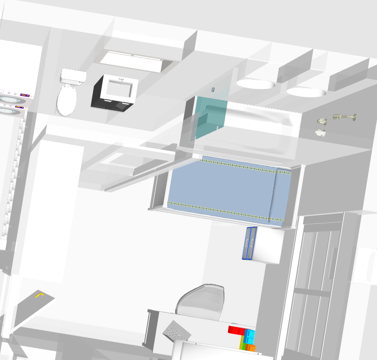

The 3d image below is the best angle I was able to extract (all the walls are transparent so it looks weird).

I would sit the Bath very low nearly touching the floor, and step in overt the taps , will work fine
Bath taps can come out of the wall, they do not need to be attached to the tub.
Be careful which way around the tub is fitted, the angles are different.
Wall mounted taps (you can’t create an intention trip hazard by having to step over taps). Good extractor and plenty of lights.
Move the bed 300mm closer to the desk. Give yourself some room at the side of the bath.
It’s an ideal shape for a shower, but not ideal for a bath in honesty.
If you must have the bath ( can’t you just give him a shower and he soaks in the master bathroom ?! ) then grab handles for getting in and out would be sensible. The risk of personal injury here is very high with your current layout.
Or, rotator the bed 90 degrees across the window. Move desk over. Put bath opposite end, move that corner tight to the bed and put the WC at the end of where the bath is shown. Basin etc to best suit residual space.
If you’re gaining the use of a second (?) WC by creating this room, just ask him to shower there, soak in master, and the family can use that new loo when the master is engaged.
If this is under BRegs radar they may have issue with that room. You’d need to ask, or do the room ‘off the radar’ as many others have done / are doing.
Think the bath is an accident waiting to happen, you would stepping in to the sloped part of the bath.  Think he may spend his time reading in a bed recovering from a slip/fall, instead of the bath.

it has, the 3d image was crap

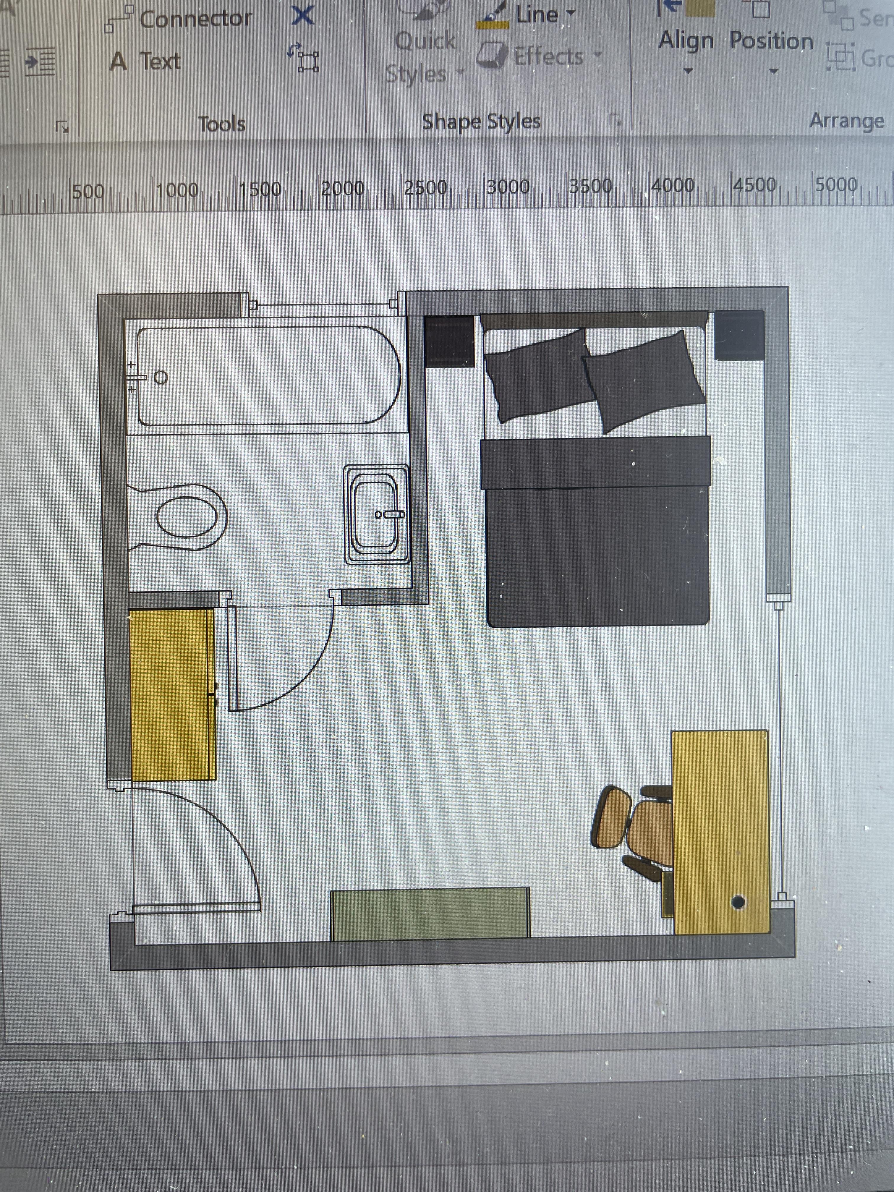

3 hours ago, PeterW said:
@sruk here you go - all standard stuff and gives him a double bed too (assuming your dimensions are accurate)

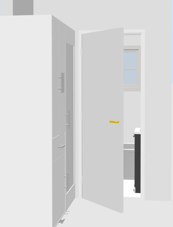

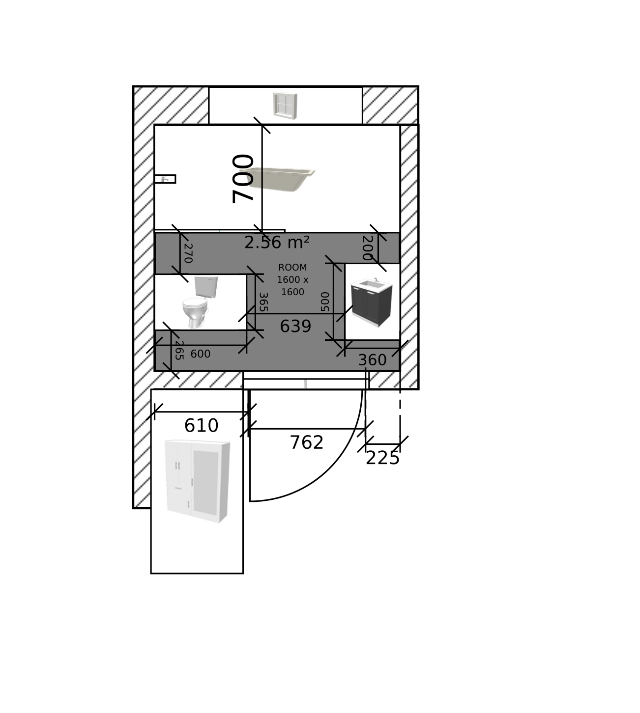

many thanks for that, i originally tried that but didn't really work for me, what width door are you using? if i want to put a 600mm deep wardrobe behind the door (door width 762mm) then the vanity unit obstructs part of the opening.
see sketch and images below.
Once again many thanks for your help.
Just use a standard 686mm door - will fit easily. Otherwise put the wardrobe opposite the en-suite and the book case behind the door.
Could the bath go on the toilet wall?
Then toilet and sink on the right wall - this would give window access and allow a shower above the bath.
not really, it would leave maximum leg room between toilet and bath of 300mm
A sliding pocket door would work

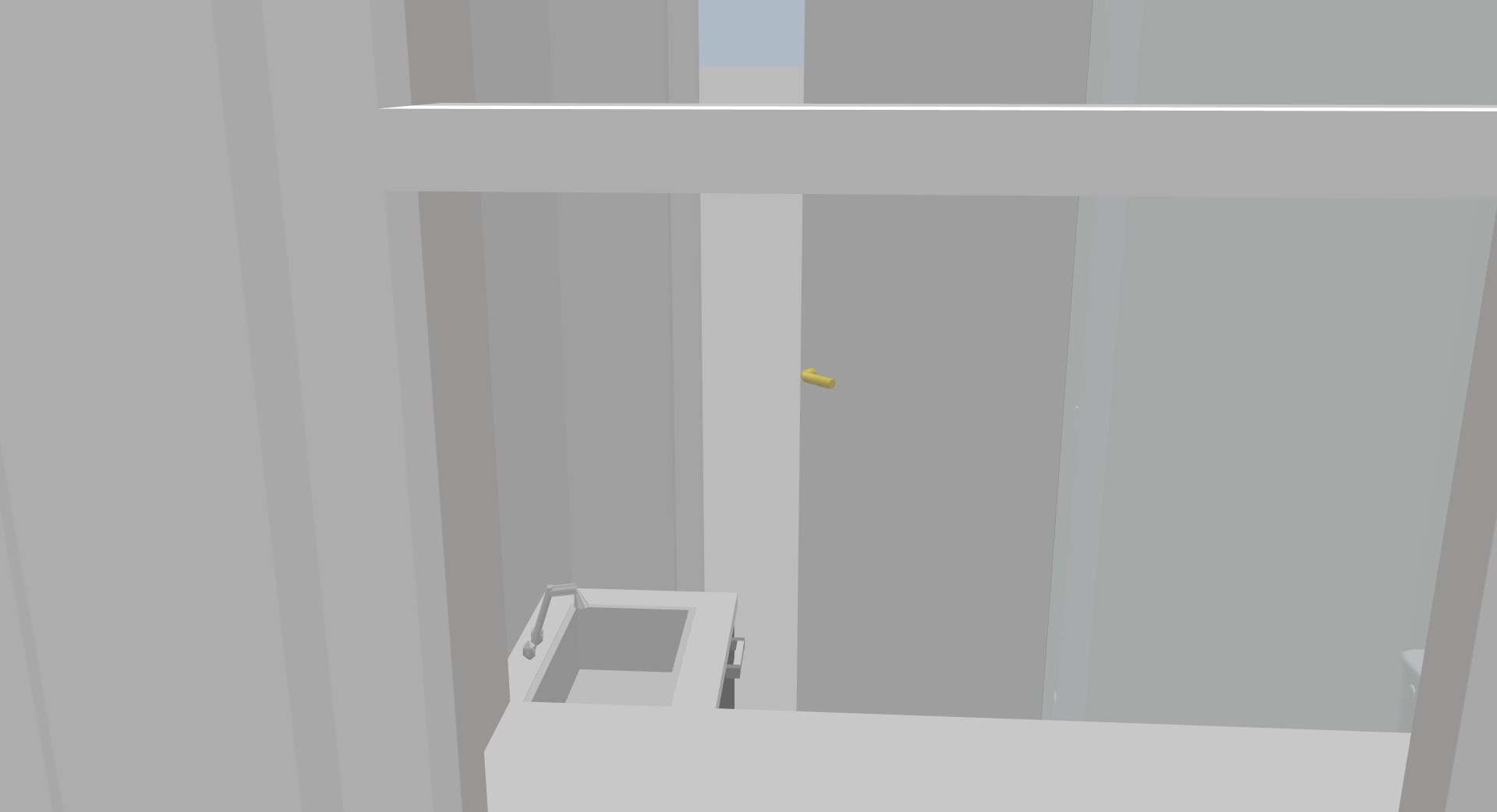

for a pocket door of 686mm i need 704mm wall space for the pocket, i am struggling with 610.
Reduce the right hand side of the door from 225 to 73mm or less and you are sorted.
You could turn the bath through 90 degrees and put it on the left hand wall so you dont have a window over the bath.

in this case almost half the entrance will be obstructed by the sink.
