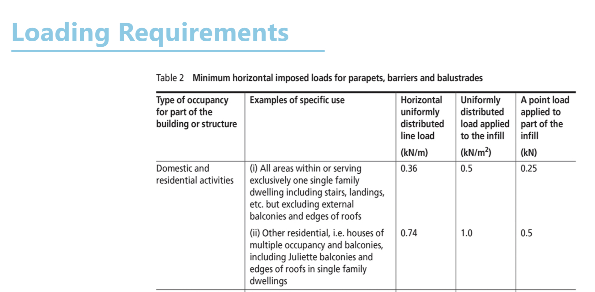

Dan F Posted April 24, 2022 Posted April 24, 2022 All our first floor windows have sills at 450mm meaning they are considered "critical locations" for building regulations. Also, because these are on the first-floor, they are supposed to confirm to "guarding" requirements too. Our BCO is asking for "The design loadings that conform to BS 6180", but so far I haven't been able to get hold of anything that shows this. Have others had this requirement, and if so, what type of documentation have you provided in response? - Loadings. - BS 6180 approval - EN 12600 category. (pendulum test) - other The windows in question are triple-glazed with all three panes thoughened 4ESG-18-4ESG-18-4ESG.

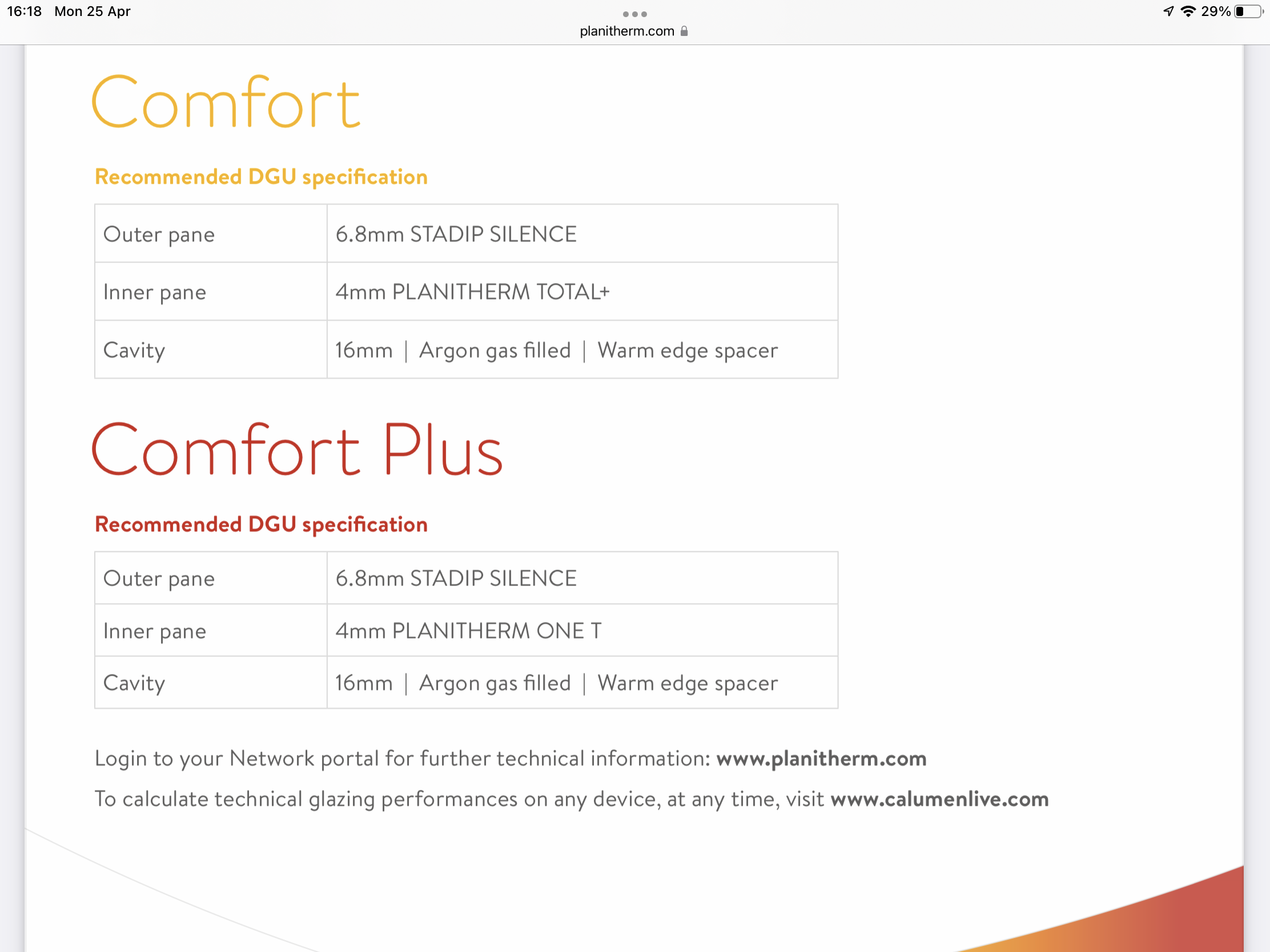

Nick Laslett Posted April 24, 2022 Posted April 24, 2022 (edited) Two useful docs for BS6180: https://techhub.uk.saint-gobain-building-glass.com/sites/default/files/document-files/Guards %26 Barriers 5A - SGBG Guidance for Low Risk Design - 19-09-2018.pdf https://www.fhbrundle.co.uk/files/pdf/co1/Technical/Glass Loading Data Sheet 7.2.pdf BS EN 12150 kite mark for thermally toughened safety glass The majority of our upstairs windows are 250mm from floor level. They are all 6.8mm laminated and 4mm toughened DGU. I suspect your units would pass the test, but have not be subjected to them, so there is no certificate. Edited April 24, 2022 by Nick Laslett

Dan F Posted April 25, 2022 Author Posted April 25, 2022 (edited) The complication seems to be that our BCO wants BS6180 loadings for first-floor low-level windows, in same way they would would require them for a balcony ballustrade, as technically low-level first-floor windows also come are considered "guarding". The EN12600 pendulum test certifies impacts resistence, but doesn't give any loadings. I've sent through the EN12600 (class 2) certification regardless though and we'll see what happens. Edited April 25, 2022 by Dan F 2
Nick Laslett Posted April 25, 2022 Posted April 25, 2022 (edited) 1 hour ago, craig said: The inner and outer pane should match in thickness (as close as possible) and your 4mm should be 6mm. The frames will only take a 28mm DGU, (Sadly, SWMBO aesthetic requirements trump U-values). A 6mm inner pane would make it 28.8mm in total. These are Guardian Glass SN 70/30 units, the 6.8mm-16mm-4mm sizing looks like the default according to their website. https://www.guardianglass.com/gb/en/our-glass/sunguard-superneutral/sn-70-35 I see Saint-Gobain Planiterm Comfort Plus DGU has the same specs. https://www.planitherm.com/media/5598/422757-sgg-planitherm-a4-info-leaflet.pdf What are the draw backs to not having the panes the same thickness? Is it condensation? Edited April 25, 2022 by Nick Laslett
craig Posted April 25, 2022 Posted April 25, 2022 Nothing as far I know, other than the specs dictate inner and outer should be the same size for barrier loading.

Dan F Posted April 29, 2022 Author Posted April 29, 2022 @craigOur BCO is not insisting on further documentation on this occasion, but he is right that EN12600 is only about "safe breakage" and not "containment" and that documentation should be available to show that design-loadings comply with BS1680, in the same way that this is required for balconies. The complication is that BS1680 is a UK-only standard and the design loadings required are also UK-specific so it's not easy to get this from european manufacturers. There is generic guidance, which @Nick Laslett linked to, but none of this covers triple-glazed units directly so isn't suitable. The one thing I was able to use to make BCO a bit happier was the AGC Glass Europe online "glass thickness calculator" which uses EN 16612 to calculate loadings/delfection and shows that a 4Tc+4T+4Tc does meet requirements BS1680 point/line/unform loadings for the size of our glass units. Our glass is Saint Gobain, not AGC, but toughened glass is pretty much the same whoever makes it. 1
