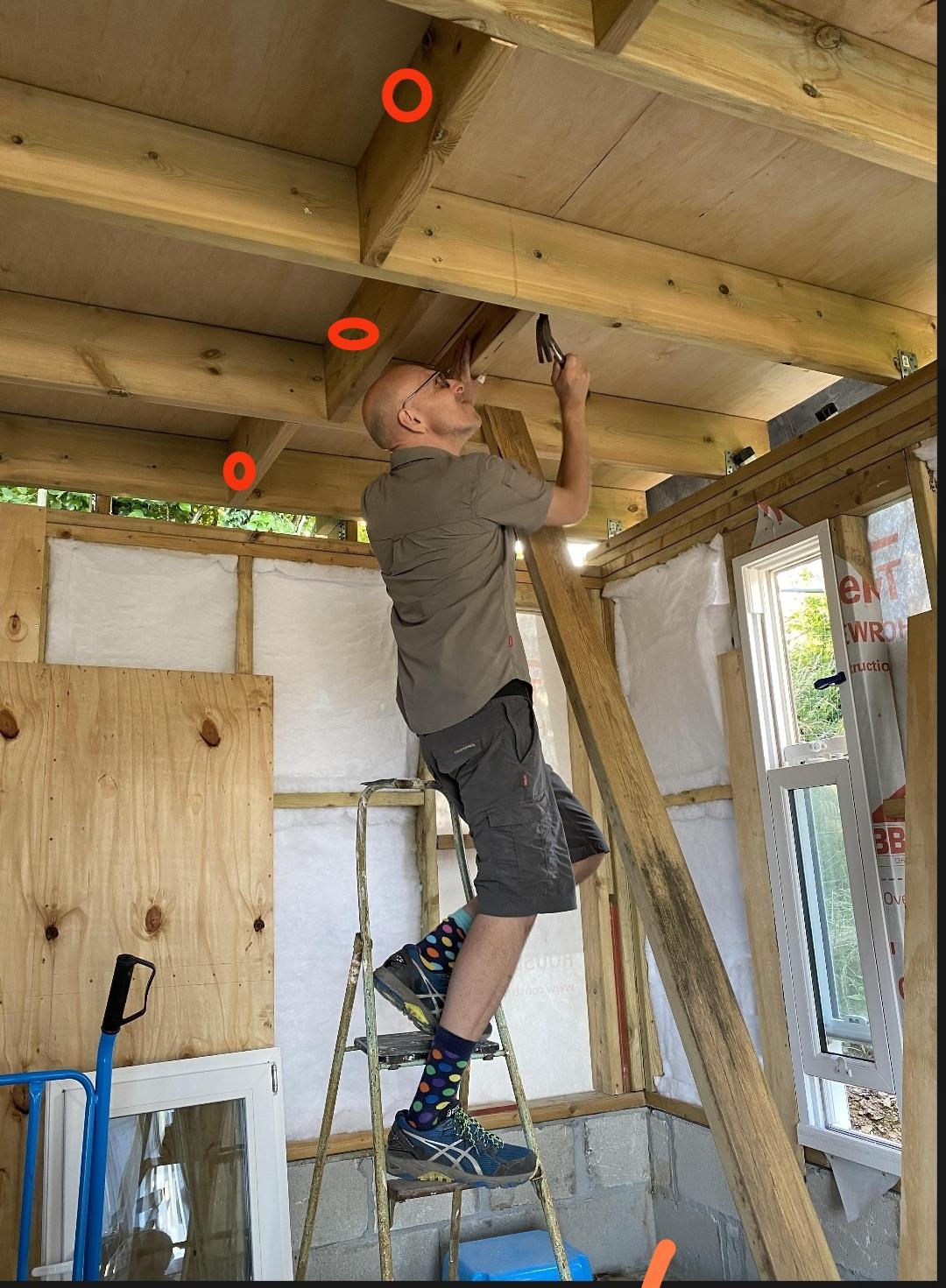

Omnibuswoman Posted April 15, 2022 Share Posted April 15, 2022 Hi peeps, further advice needed on workshop build, this time on the roof insulation. We’ve built a cold roof design - EDPM on top, 18mm marine ply, joists/noggins. No ceiling finish up yet. We’re planning to put on a plasterboard ceiling with recessed LED lights, but need to work out the best way to insulate between the plasterboard and the ply. Do I need to leave a ventilation gap between the ply roof and the insulation? Then another gap between that and the ceiling? How will the electric cables through the joists affect any insulation decision? Might insulated plasterboard be a better option? All suggestions most welcome! Thanks! M Link to comment Share on other sites More sharing options...

Radian Posted April 16, 2022 Share Posted April 16, 2022 11 hours ago, Omnibuswoman said: Do I need to leave a ventilation gap between the ply roof and the insulation? If you don't want problems with condensation, then I would say yes. But your nogs seem to be the full depth of the joists so when you panel over for the ceiling there's a whole lot of closed-off spaces. Think of what happens to the water vapor in the warm inside air when it gets up to the cold underside of the ply. A vapor barrier may help but they're hard to make perfect when you bore through for LEDs and cabling. Cold roofs generally require a howling draft throughout to be foolproof. 2 Link to comment Share on other sites More sharing options...

Iceverge Posted April 17, 2022 Share Posted April 17, 2022 (edited) You could drill holes where the circles are shown. Say 50mm diameter to have a cold roof with continuously ventilation between the ply deck and the insulation. 100mm mineral wool, airtight membrane. 50mm battened and insulated service cavity. Plasterboard. Alternatively warm deck. Get some seconds PIR and sandwich it between the edpm and the ply. Probably the best option and leave the inside just as it is with conduits for electrical fixings. Also, then you can make use of the joists for hooking things up to. Very useful in a workspace. Edited April 17, 2022 by Iceverge Link to comment Share on other sites More sharing options...
TonyT Posted April 17, 2022 Share Posted April 17, 2022 Probably better not to have full depth noggins/dwangs in as you are only getting airflow from outside air to them, beyond then there will be no air movement. Link to comment Share on other sites More sharing options...

Radian Posted May 2, 2022 Share Posted May 2, 2022 The problem with unheated workshops is that throughout the year there are times when the internal temperature is considerably below the outside temperature - unless it is deliberately ventilated (think slatted cow sheds). Then the relatively higher humidity of outside air condenses on relatively colder internal surfaces, tools etc. So yes, insulation can have a detrimental effect if it delays the two reaching equilibrium. I think you were initially considering the reverse of this situation - where internal warm/moist air would condense on cold surfaces on the other side of the insulation. This would be non-negotiable in a normal living space but for an outbuilding you can consider increasing ventilation all round. It's somewhat frustrating I'll agree. My own workshop is insulated and marginally heated by a dehumidifier and small electric convector. The dehumidifier is a compressor type that consumes around 250W and consequently raises the room temperature by a degree or two. Thus it serves two purposes. If I had to replace it I would get an electric Desiccant Dehumidifier which works better at cold temperatures but has the same positive heating effect. Even a marginally heated workshop is proving to be a luxury though so I'm looking at other options. 2 Link to comment Share on other sites More sharing options...
Nickfromwales Posted May 2, 2022 Share Posted May 2, 2022 20 minutes ago, Radian said: If I had to replace it I would get an electric Desiccant Dehumidifier which works better at cold temperatures but has the same positive heating effect Thanks for that. 1 hour ago, Omnibuswoman said: The first thing that occurred to me is that the building will not be heated, so in theory there will be no warm air to condense on the underside of the roof ply… in which case, is it worth insulating at all (like a standard shed)… We could just fit plasterboard to the underside of the joists (having first drilled a 50mm hole through each noggin to allow side to side airflow from vented soffits). In this case, it would be neither a warm roof nor a cold roof, but just a ‘same temperature as room’ roof. If this is just a shed, why are you spending ( wasting ) any more money with plasterboard / other finises? I painted my ceiling rafters with the same grey floor paint, and all looks perfectly fine to me. Maybe time to stop now, and stop making any more problems to solve. Certainly do NOT fit recessed lighting!! Surface mounted for sure with low profile trunking. Will be plenty neat enough. 2 Link to comment Share on other sites More sharing options...
Nickfromwales Posted May 2, 2022 Share Posted May 2, 2022 Oh, and get rid of the full height noggins! Replace with ones 25-50mm lower, ventilating at the top and bottom of the runs. I bought metal racking which came with MDF shelves ( crappy 9mm POS ) but they have been the only thing to harbour moisture and grow mould. The OSB3 shows zero signs of this, so will be what I replace these crappy shelves with. 1 Link to comment Share on other sites More sharing options...
Omnibuswoman Posted May 2, 2022 Author Share Posted May 2, 2022 Thanks peeps. I’ll have a chat with HWMBO about leaving the ceiling as-is and fitting low profile lights instead. Looking at the extra cost of plasterboard etc it seems wasteful to make it any fancier than it needs to be, especially with prices going the way they are. I can’t see anything wrong with the idea of painting the rafters and making a feature out of them. ☺️ Link to comment Share on other sites More sharing options...
