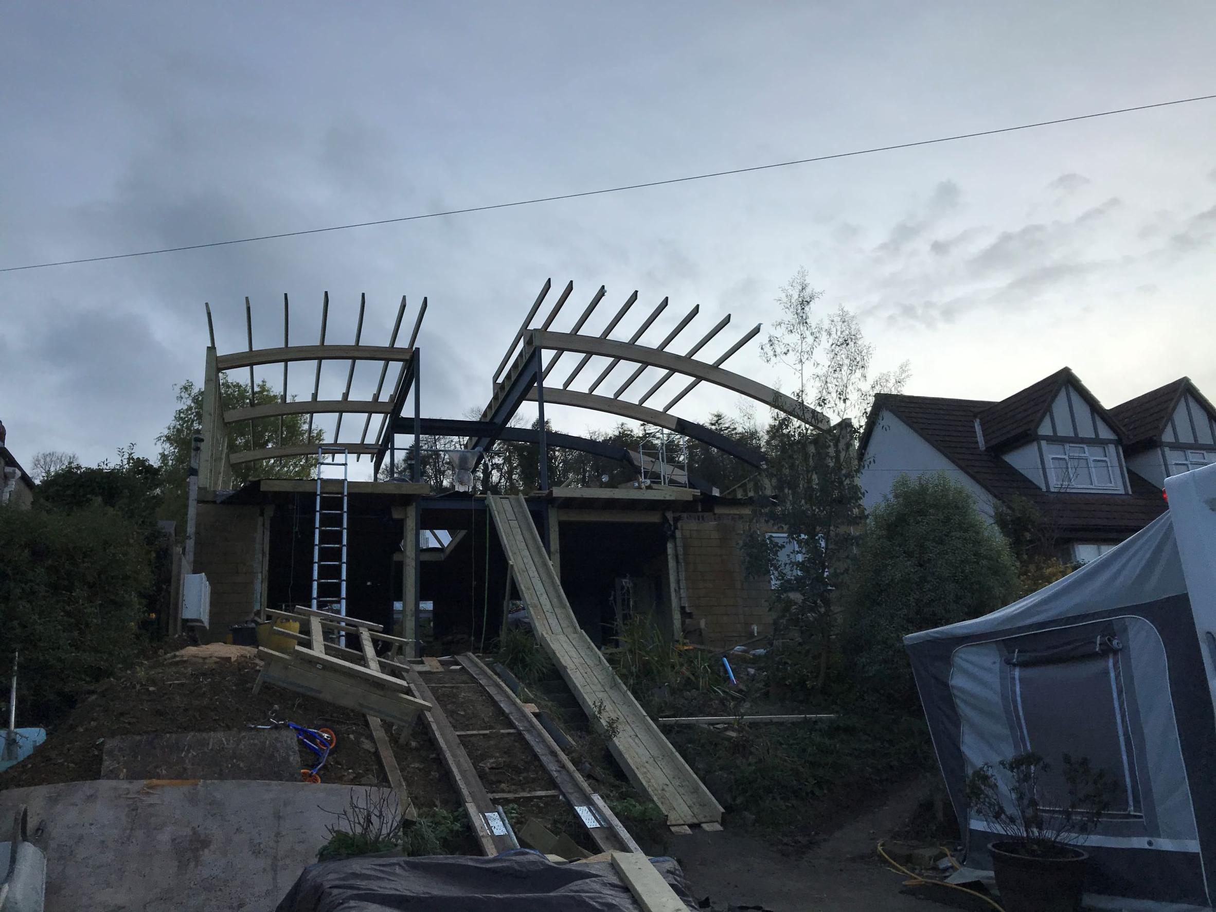

SimonD Posted April 15, 2022 Share Posted April 15, 2022 I reckon a ramp and pulley/hoist are your best ideas. It's surprising how only a small angle ramp reduces the effective weight of the material being lifted. Also gives you more control. You could also get some castor wheels and create a dolly for the EPDM roll, or as already suggested load it onto some plywood or OSB to slide along the ground. All my materials went up that way including the glulam beams either on my own or with one person helping. I bought a hoist that had enough cable to reach to the bottom of the driveway so could pull materials up from the roadside. It looks a bit weird and unconventional, but it worked and saved a shed load compared to hiring in lifting machinery. 1 Link to comment Share on other sites More sharing options...

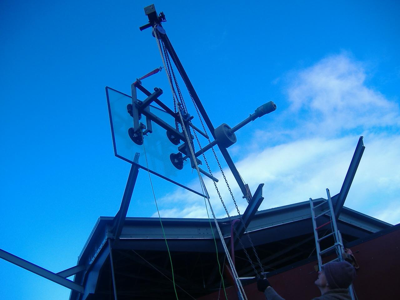

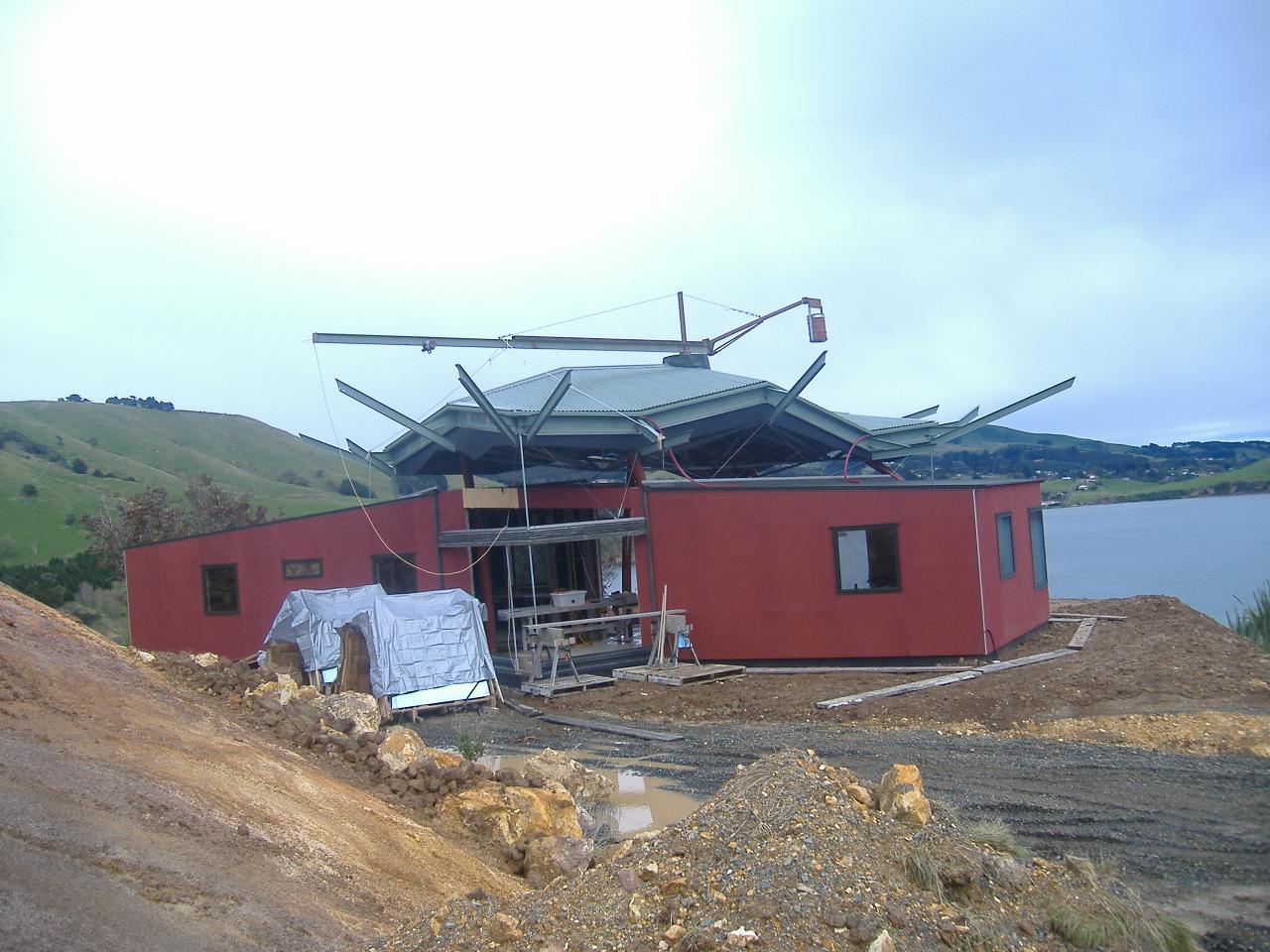

Onoff Posted April 15, 2022 Share Posted April 15, 2022 Chap I know from working with an NZ firm for a bit built his own crane when he built his place there: 1 Link to comment Share on other sites More sharing options...
Bitpipe Posted April 15, 2022 Share Posted April 15, 2022 I would genie lift it to roof 3 (onto a temp ply base) and then have a small ply ramp to get from roof 3 to roof 2. Using a wheeled dolly for that last bit, as suggested above) could work well. I had to get two 180kg stone baths to the first floor of our build, did not trust the temp MSF stairs to hold (given they were secured with a few screws). Luckily we had an atrium through which the genie could lift them and I roped in a few mates, just to be safe. Was a quick job in the end. Link to comment Share on other sites More sharing options...
Tony K Posted April 15, 2022 Author Share Posted April 15, 2022 Some interesting ideas here, thanks. The idea is to fix the ply deck in place, and get the epdm up and at least resting in place all as one operation if possible, so as to minimise the time the ply is exposed to the risk of rain. I'll have at least one other person with me when I do all this, so I reckon I'll hire a genie for the day, and possibly a block tackle kit, then work my way through the various options. My concern about using the joists to winch the roll up, especially if I use a counter weight, is the amount of stress I'm placing on the joists. The whole of the joists are resting on a wall plate at one end (only on the inside leaf), but at the other end (above the steel) only the top chord of the joist is resting, and I may be taking a risk relying on that to take the weight. 1 Link to comment Share on other sites More sharing options...
