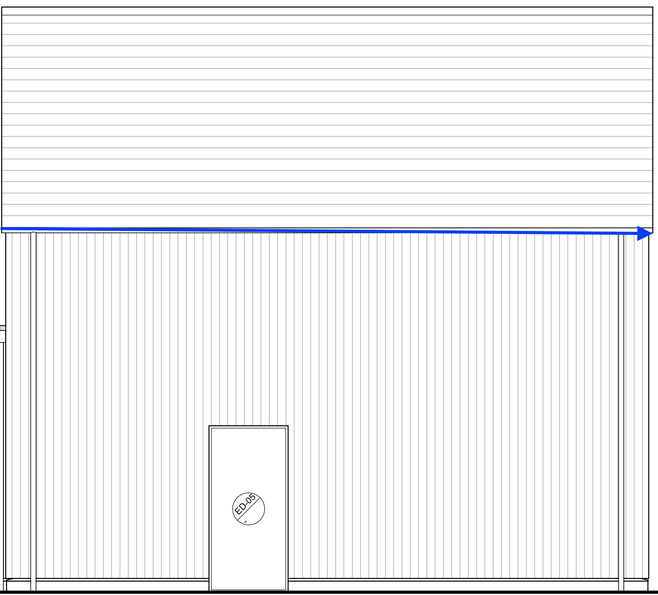

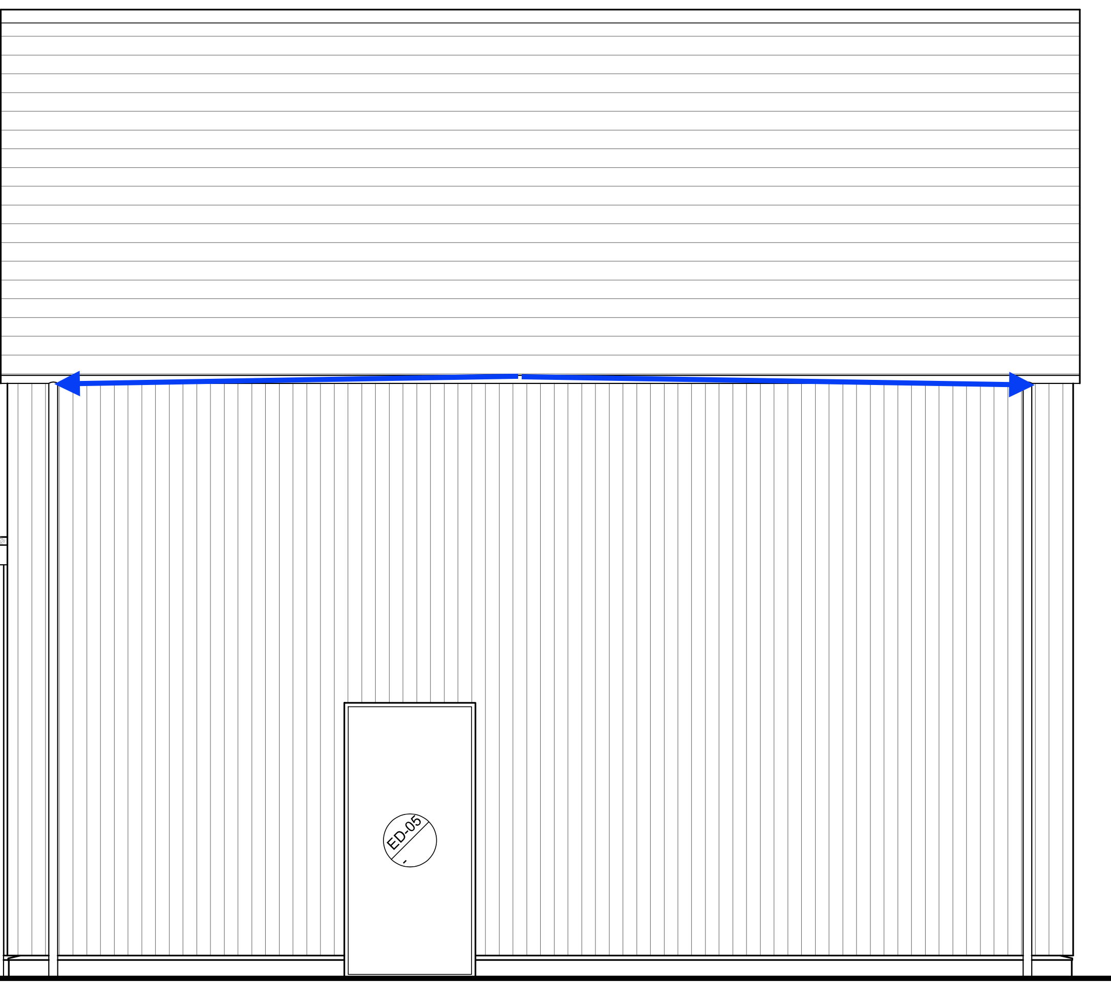

Thorfun Posted April 22, 2022 Author Share Posted April 22, 2022 next question on guttering......the fall.... I have a roof with downpipes at either end. do I lay to fall from the middle of the roof so the water runs evenly to each end or do you start at one end and run to fall to the other end. e.g. or Link to comment Share on other sites More sharing options...
markc Posted April 22, 2022 Share Posted April 22, 2022 If you have DP’s at both ends then high point in the middle yes 1 Link to comment Share on other sites More sharing options...
Thorfun Posted April 22, 2022 Author Share Posted April 22, 2022 1 minute ago, markc said: If you have DP’s at both ends then high point in the middle yes thanks. it did indeed seem logical to me but sometimes it's best to ask before jumping in! 🙂 Link to comment Share on other sites More sharing options...
markc Posted April 22, 2022 Share Posted April 22, 2022 2 minutes ago, Thorfun said: thanks. it did indeed seem logical to me but sometimes it's best to ask before jumping in! 🙂 Absolutely, I have seen it done the other way … down pipes at each end and low point in the middle … and looked more like a roller coaster than a gutter 1 Link to comment Share on other sites More sharing options...

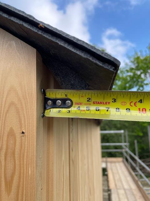

Temp Posted April 22, 2022 Share Posted April 22, 2022 Main thing is to make sure the guttering projects far enough as water can shoot off the end of tiles rather than drip off the end. Link to comment Share on other sites More sharing options...
Russell griffiths Posted April 22, 2022 Share Posted April 22, 2022 Modern gutters require so little fall it’s not worth worrying about. Mine is perfectly flat. 1 Link to comment Share on other sites More sharing options...
Thorfun Posted April 22, 2022 Author Share Posted April 22, 2022 4 minutes ago, Temp said: Main thing is to make sure the guttering projects far enough as water can shoot off the end of tiles rather than drip off the end. yeah. cheers. we're looking at 125mm wide gutters with a deep profile. the timber cladding that the gutters will be fixed to are about 70mm from the edge of the slates: so I'm currently chatting with the guttering supplier to ensure that the fascia brackets allow the guttering to protrude sufficiently to do as you say. Link to comment Share on other sites More sharing options...
Thorfun Posted April 22, 2022 Author Share Posted April 22, 2022 Just now, Russell griffiths said: Modern gutters require so little fall it’s not worth worrying about. Mine is perfectly flat. yeah, that's what I've heard. especially with the deep metal guttering I'm looking at. I've read some manufacturers for this guttering are suggesting a 1:600 fall so that's 3mm over 1m which is nothing really. Link to comment Share on other sites More sharing options...
