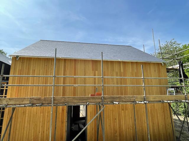

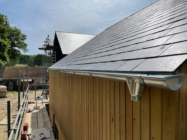

so we decided to go with Zinc guttering using a dry fix system (it's Zambelli) from Rainclear who did take-off for me and had a massive 30% off with next day delivery! couldn't be happier with them and their service. and I've done the first elevation. laid level without a fall as suggested by @Russell griffiths and confirmed by Rainclear due to the large and deep profile of the zinc guttering. And as @Roundtuit said, it is easy to fit and cut with a hacksaw and tin snips. even managed to fit our outlets without drama. all in all, it is easy and my worries were unfounded.
IMG_3021.jpeg.b974350bd4a3b6620ec3f610227768e8.jpegIMG_3026.jpeg.5e3c2426a2a222d67003fd7d3f14c179.jpeg
and it looks fab! 🥰
