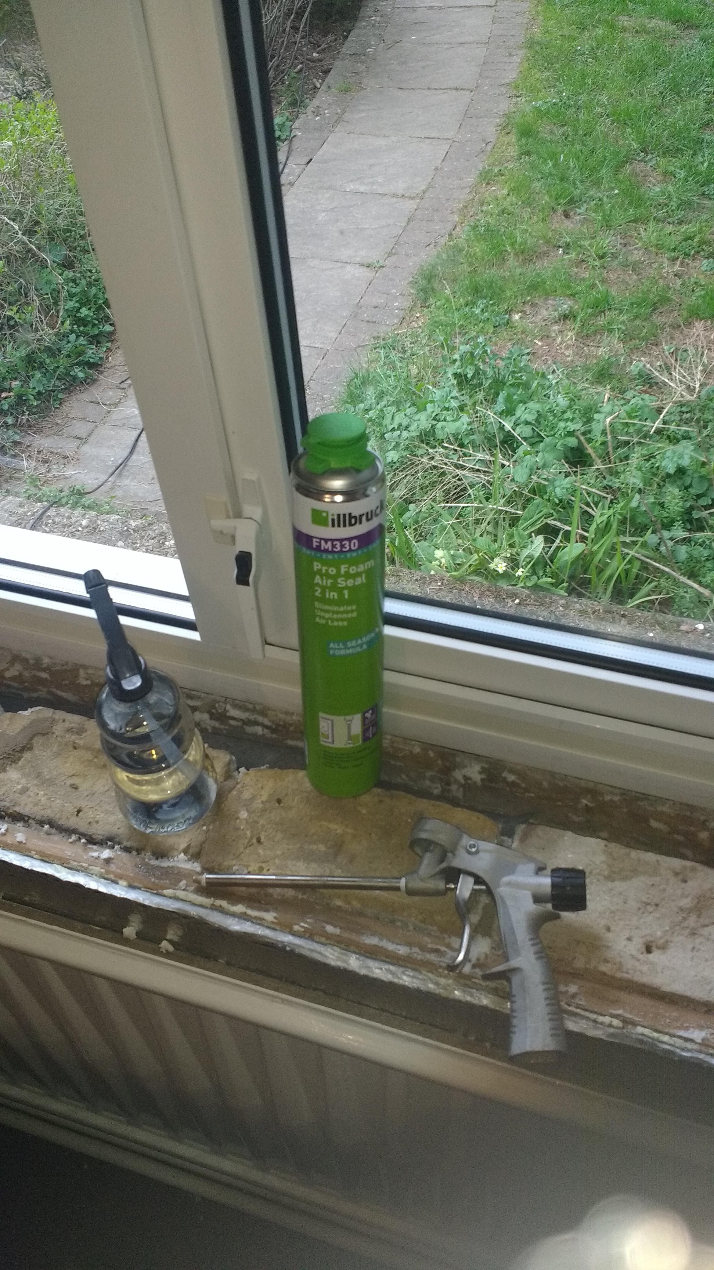

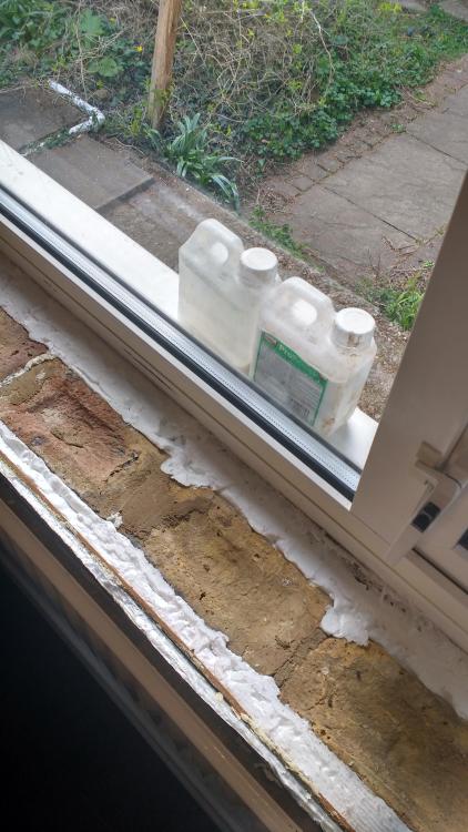

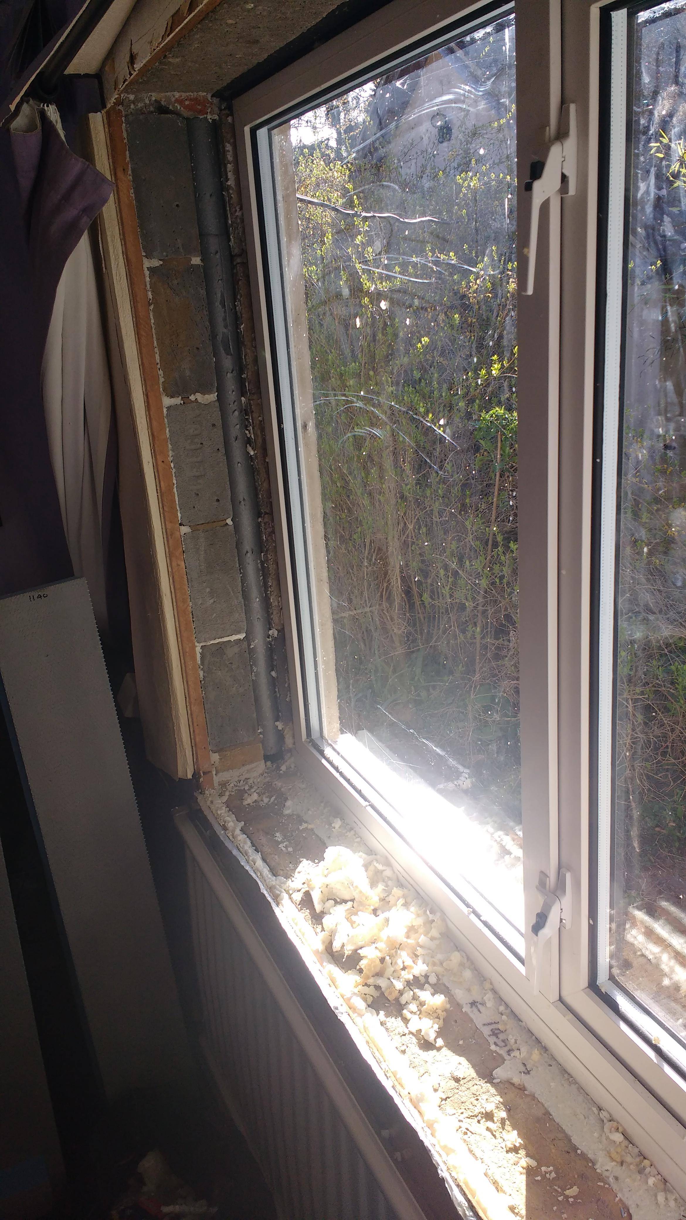

Onoff Posted April 7, 2022 Author Posted April 7, 2022 7 minutes ago, Marvin said: Progress seems to be going backwards. Either direction is movement! Right, the Illbruck can says spray with water not PVA. Just dug the old foam out and it was still wet behind it where I'd sprayed before. PVA would have stayed wet. Imvho! Kind chap that I am I gave the new gun to the guy who's gun I borrowed on the quick. Just had to strip and rebuild his old gun here! I'm going in!
Radian Posted April 7, 2022 Posted April 7, 2022 1 hour ago, Onoff said: Just had to strip and rebuild his old gun here! Oh those things are a PITA. Even after soaking in cellulose thinner overnight a thin film seems to remain in all the inaccessible places.
Onoff Posted April 7, 2022 Author Posted April 7, 2022 4 minutes ago, Radian said: Oh those things are a PITA. Even after soaking in cellulose thinner overnight a thin film seems to remain in all the inaccessible places. Tbh I like doing them. Sometimes they're a goner if the central shaft is PTFE coated and it's worn through though. This one's back together, silicone greased up and working a treat. 1
Radian Posted April 7, 2022 Posted April 7, 2022 16 minutes ago, Onoff said: Sometimes they're a goner if the central shaft is PTFE coated and it's worn through though Oopsey! Is that what that 'film' was? 😄
Onoff Posted April 7, 2022 Author Posted April 7, 2022 1 minute ago, Radian said: Oopsey! Is that what that 'film' was? 😄 Well it's been black like on a frying pan the ones I've done. This one I just rescued had a shiny steel shaft with no apparent coating.

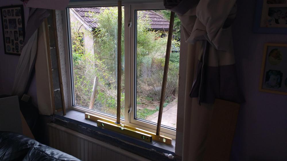

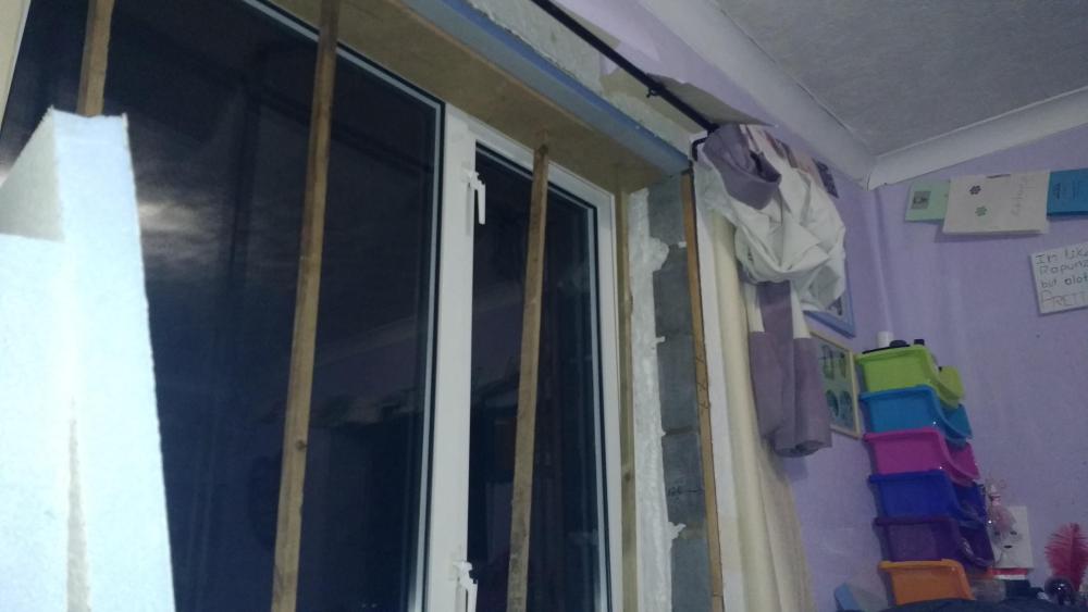

Onoff Posted April 8, 2022 Author Posted April 8, 2022 @Nickfromwales, what's the score then with using this Illbruck FM330 to stick the Marmox boards on? I was thinking: - Dry fit the boards and masking tape the upvc frame. - Measure and cut some batten cross braces to wedge the boards into position - Water spray both surfaces Then the main one: - Foam the 4 edges of each board will meet the wall and some lines in between at say 300mm centres? Aiming to go soffit, sill then sides. I'll shim the battens as required to tweak things plumb. When done, sharp blade to cut through any foam and the masking tape. On the assumption this foam is airtight I won't need a membrane around the reveal I'm thinking?
Nickfromwales Posted April 8, 2022 Posted April 8, 2022 1 hour ago, Onoff said: @Nickfromwales, what's the score then with using this Illbruck FM330 to stick the Marmox boards on? I was thinking: - Dry fit the boards and masking tape the upvc frame. - Measure and cut some batten cross braces to wedge the boards into position - Water spray both surfaces Then the main one: - Foam the 4 edges of each board will meet the wall and some lines in between at say 300mm centres? Aiming to go soffit, sill then sides. I'll shim the battens as required to tweak things plumb. When done, sharp blade to cut through any foam and the masking tape. On the assumption this foam is airtight I won't need a membrane around the reveal I'm thinking? A1 reverend. 😎. I’d be priming the surfaces but you don’t want the PVA, so use tile adhesive primer or SBR maybe. Foam will adhere to what is behind, if that’s friable then it’ll be shart. 1
Onoff Posted April 8, 2022 Author Posted April 8, 2022 5 hours ago, Nickfromwales said: A1 reverend. 😎. I’d be priming the surfaces but you don’t want the PVA, so use tile adhesive primer or SBR maybe. Foam will adhere to what is behind, if that’s friable then it’ll be shart. Wet, tacky or dry?

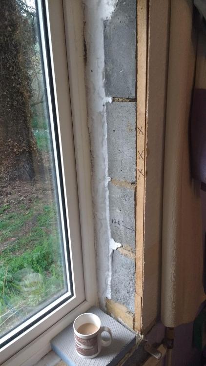

Onoff Posted April 8, 2022 Author Posted April 8, 2022 OK I concede. Illbruck FM330 is whole different can of foam! To trim the excess I struggled to cut it with my normal fine toothed hand saw or the couple of old bread knives that are my usual goto. Resorted to the 18V Fakita multi tool. It's weird. Not like the crunchy run of the mill expanding foam. This stuff is like rubberised merengue...but in a good way. Not sure if when you cut into the shiny top skin you bugger the airtightness properties? I suspect not. It's bloody tough stuff! 1

SteamyTea Posted April 9, 2022 Posted April 9, 2022 14 hours ago, Onoff said: Not sure if when you cut into the shiny top skin you bugger the airtightness properties? I suspect not. Called 'integral skin'. Similar chemistry to those black, foam armrest on office chairs and your car steering wheel. Generally if you cut it, it absorbs water, so you will loose some of the airtightness.
