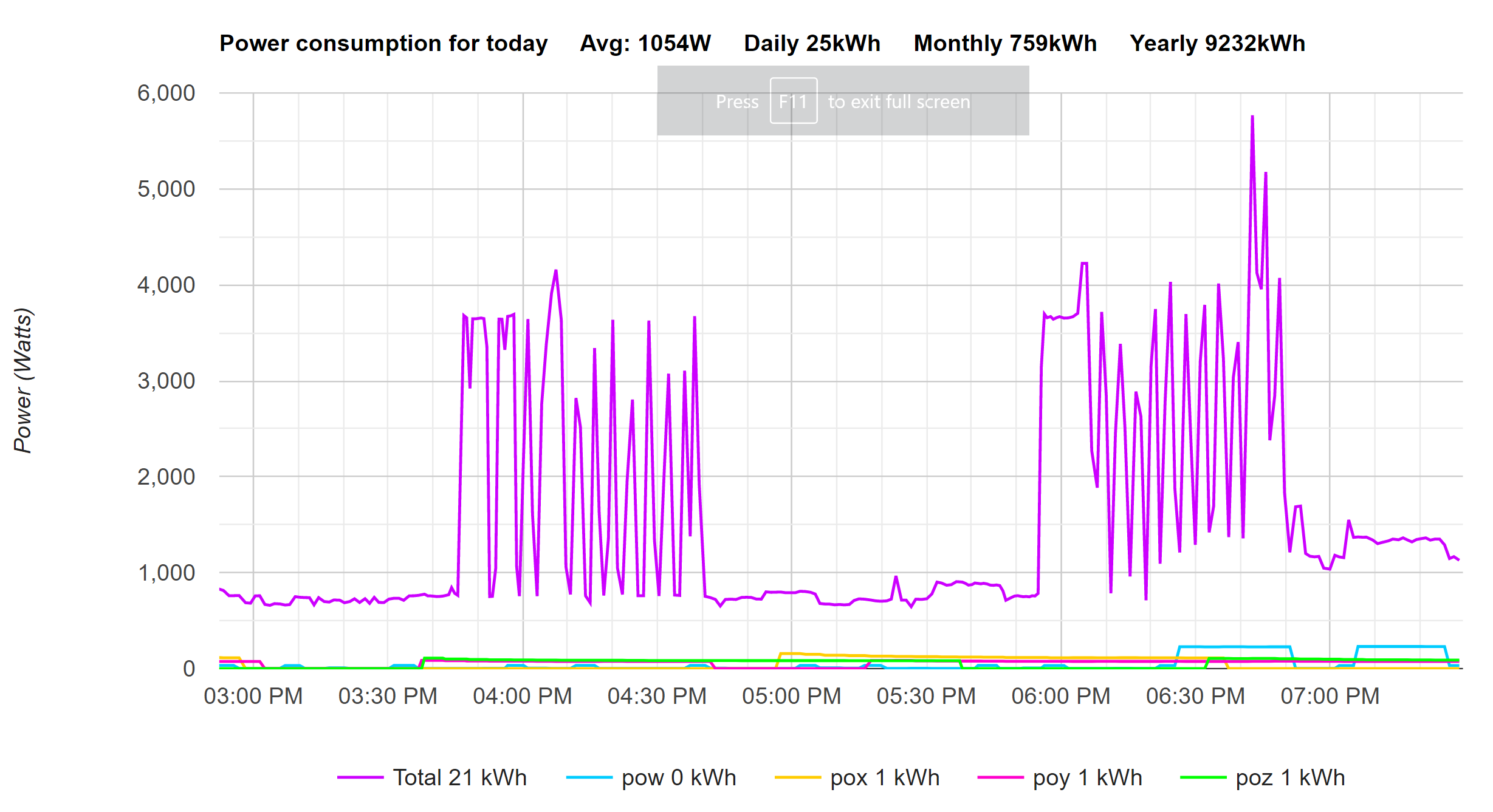

Clipped from today's power usage. Started baking cakes around 3:30PM  then cooking pies in oven around 6 ish. Looks like 2.5kW element in fan oven. Microwave kicked in at around 6:30 for some veggies.
