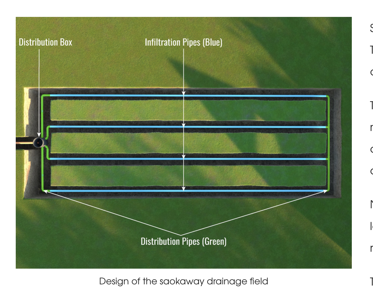

Nestor Posted March 25, 2022 Posted March 25, 2022 3 minutes ago, joe90 said: My run from plant to ditch was 12m, 2 m ordinary pipe then 10m perforated pipe in a 400mm wide trench, 200mm stone below and 100mm above, plastic on top then top soil, all the way to the ditch. Make sure you put a grid on the ditch end, I got a rat in my plant which blocked the pump (it started to smell) but all well now I fished it out. It is an open ended system not sealed like the enclosed image above?
saveasteading Posted March 25, 2022 Posted March 25, 2022 16 minutes ago, joe90 said: perforated pipe You can use expensive pipe, (either the brown drain pipe with slices cut in it, or ready made black perforated pipe) that is lovely and smooth on the inside. this is what the Building Inspector would like you to use. Or cheap coiled agricultural stuff (a fraction of the cost). Theoretically the crinkles will fill with crud on the bottom and it won't work so well, but you could always use the next size up if that is a concern. The only real issue is keeping it running to a fall, but perfectly possible,
joe90 Posted March 25, 2022 Posted March 25, 2022 1 minute ago, saveasteading said: You can use expensive pipe, Yes, I was gobsmacked when I saw the bill, i would have bought plain pipe and drilled loads of holes, I was told not to use ribbed flexible as it tended to hang on to “stuff” (then again it should be clean by then 🤷♂️ 19 minutes ago, JamesP said: It is an open ended system not sealed like the enclosed image above? Yes, just ran out to the ditch.

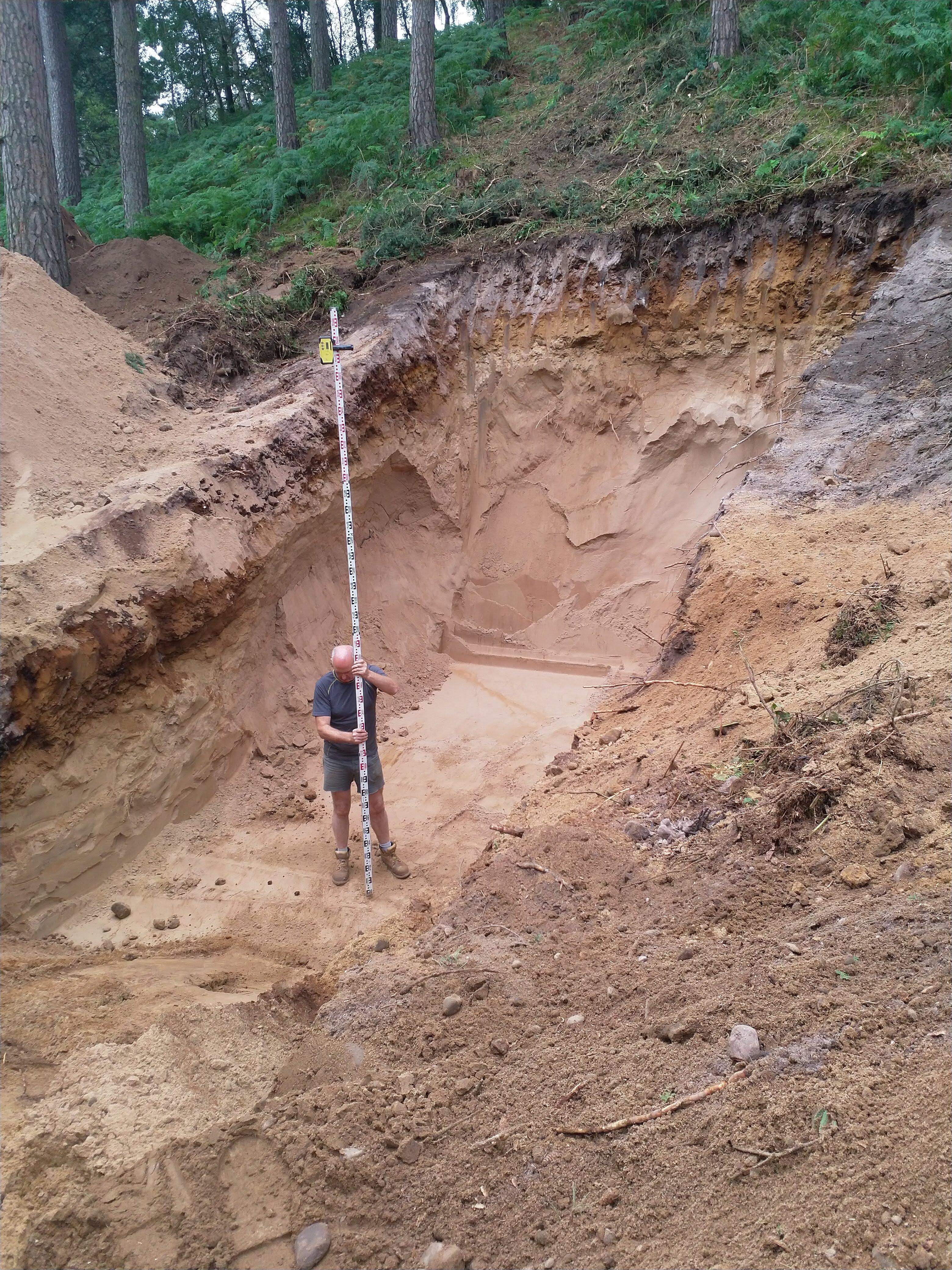

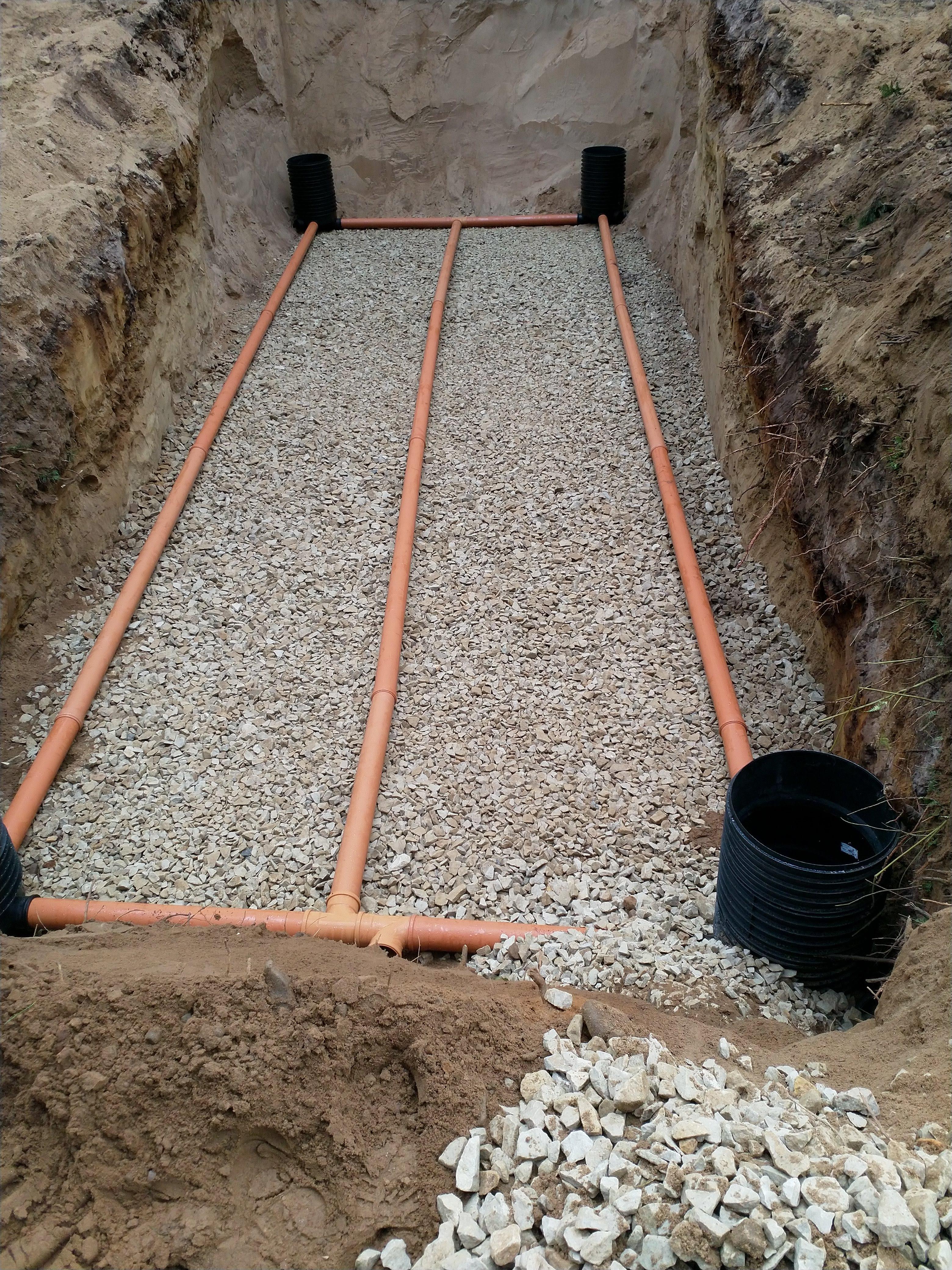

JohnMo Posted March 25, 2022 Posted March 25, 2022 Were next to a Loch of special scientific interest, had to go though lots of hoops even to get planning. Our treatment plant is near house we then have to pump the outfall 100m to the soakaway to an area, outside the area of influence of the loch. Our percolation test also fails the normal test, as we are on an old sand dune. So I think we have the biggest hole for a soakaway ever. This is it part way through digging out.
ToughButterCup Posted March 25, 2022 Posted March 25, 2022 Fookin' Ello! 'Owmanee peepl's in your place? A football team?
saveasteading Posted March 25, 2022 Posted March 25, 2022 Fails because percolation is too fast through the sand?
JohnMo Posted March 25, 2022 Posted March 25, 2022 3 bed. The stupidity of the SEPA rules. They have a limit high/low for the water to soakaway during the test. Above or below that limit is classed as fail. So if you are on bedrock or sand you end up with a huge over sized soakaway. Good thing is it should never clog up. Doesn't look quite so bad with the piping and the lower stone bed. 1
saveasteading Posted March 25, 2022 Posted March 25, 2022 The Scottish 'too fast' fail is a higher rate than the English fail....fair enough perhaps because of the water quality on average. So what is the solution here? Taken below the level that might reach the loch, or into a denser stratum?? Fortunately ours passed in sand, so is ideal. Ours is glacial sand yours ancient dunes?
nod Posted March 25, 2022 Posted March 25, 2022 42 minutes ago, joe90 said: I don’t see why not, just make sure you’re plant says to discharge to a ditch like my Vortex does. Thanks Joe
JohnMo Posted March 25, 2022 Posted March 25, 2022 35 minutes ago, saveasteading said: So what is the solution here? Taken below the level that might reach the loch, or into a denser stratum?? Think it's a combination of distance and partly elevation, but mostly distance. Ours big a really deep hole because the hill is really steep at the only place we could site the soakaway.
