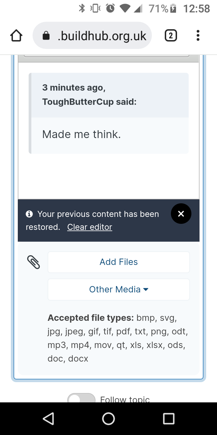

SteamyTea Posted March 29, 2022 Share Posted March 29, 2022 4 minutes ago, bassanclan said: How do I delete an accidental quote On an ordinary browser use Ctrl+a to select everything in the text box, the del to get rid of it. Not found a way to do it in my Android phone except by closing the thread, then going back to it and starting a new reply. The misquote will appear with the option to clear the editor. 1 Link to comment Share on other sites More sharing options...
