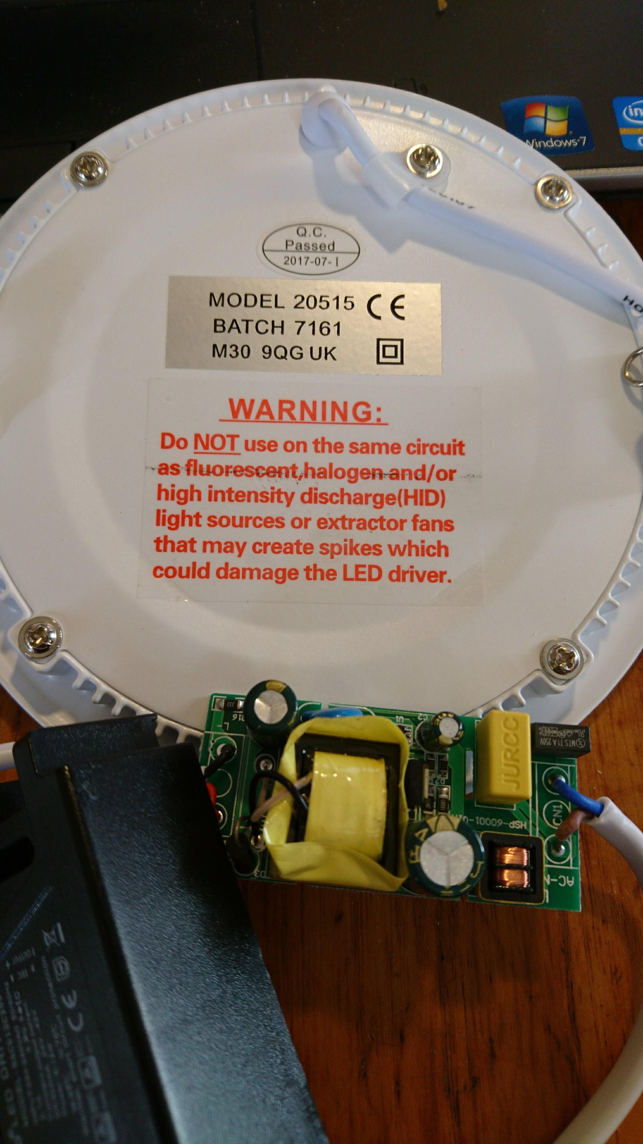

Auchlossen Posted September 29, 2016 Share Posted September 29, 2016 I am just testing some led Flat Panel lights as discussed above, bought from led.me and in soft white 3W and 6W. I am most impressed with the quality and output of the lights. The wee plastic box housing the transformer unit is as shown by Stones above. I laughed when I realized that the screw heads on the box were not screws at all but simply plastic impressions thereof. Inside the box is a wee printed circuit board: the issue I am really concerned about is that the input wires are too small to be pinched and held securely by the casing, so the input wires depend on the flimsy soldered connection of two small wires that connect to the PC board, which is floating about freely in the box. Great care would need to be used on installation, if that is not too big an ask on a building site. On the plus side, I think the 6W version gives out excellent light, both colour and quantity with a good spread, and I plan to use 4 or 6 of them in a room. Link to comment Share on other sites More sharing options...

Miek Posted February 1, 2018 Share Posted February 1, 2018 Some very useful info on this thread about slim LED downlights I bought a few of these from Ebay to test out but i am a bit concerned with the sticker on the back which says "do not use on the same circuit as fluorescent, halogen, HID light sources or extractor fans as they may create spikes which could damage the LED driver" The light and fitting design is great but is this warning a caveat for crap quality components? seems crazy to have a driver which can be damaged by other lights on the circuit. That's basically useless IMHO Anyone else seen this? or have an opinion? Mike Link to comment Share on other sites More sharing options...
chrisb Posted April 9, 2018 Share Posted April 9, 2018 I've not seen that on any of the 15 or so various flat panel fittings that I've bought over time. That said, all my drivers have about 10% of the components of the one in your picture! Link to comment Share on other sites More sharing options...
Jeremy Harris Posted April 9, 2018 Share Posted April 9, 2018 Sorry, missed this earlier. The solution would be to fit a surge suppressor in the feed to these drivers, so they don't see any spikes from anything else. Not hard to do, just fit the suppressor in a wago box across the line and neutral, in line with the feed to the lights. Something like this would do the job I expect: http://uk.farnell.com/roxburgh/xe0475/rc-network-250v-0-5uf-47r-pcb/dp/2336100 . Link to comment Share on other sites More sharing options...
