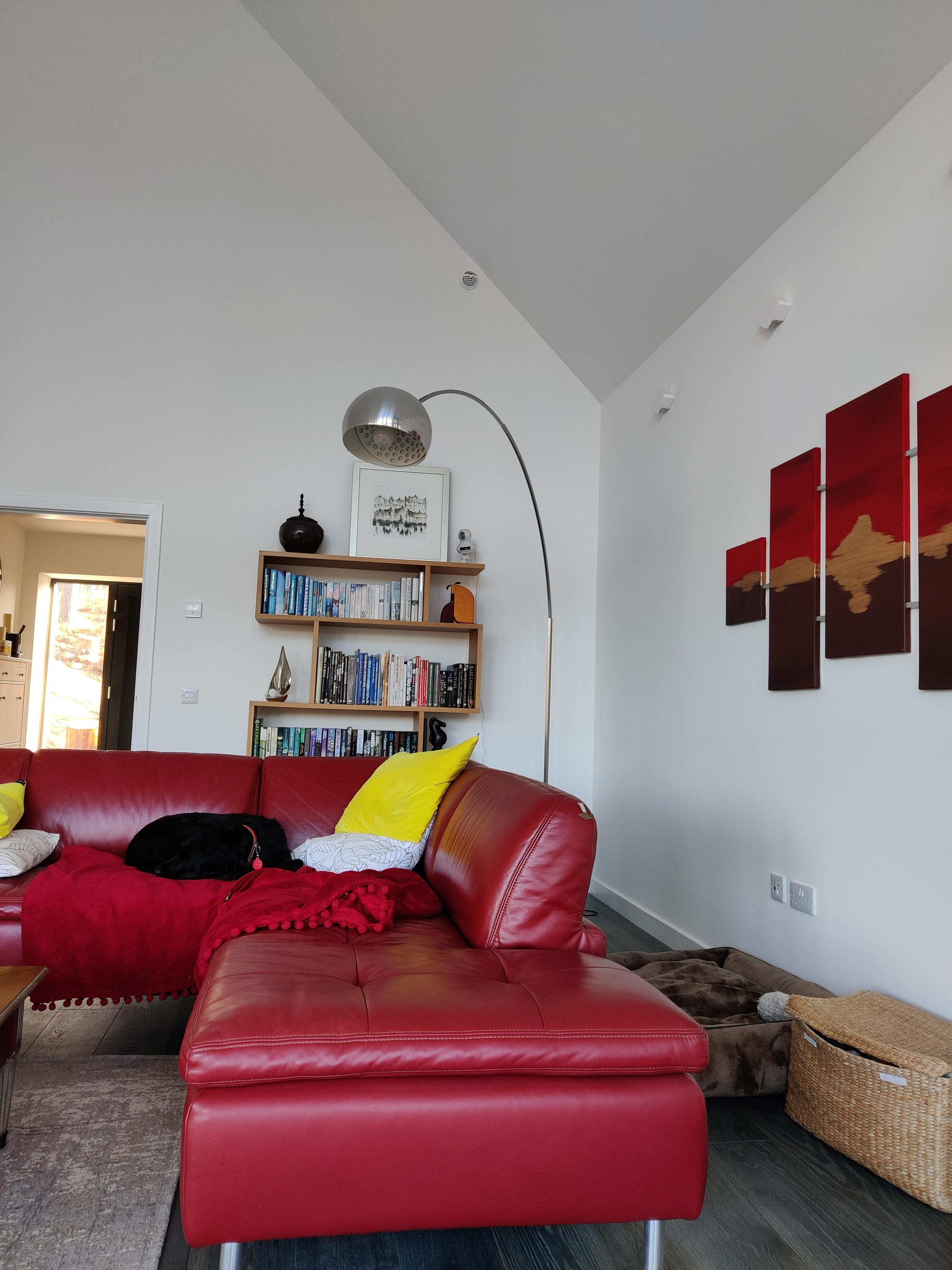

patp Posted March 19, 2022 Posted March 19, 2022 After it is all marked up go around the house and imagine switching on lights etc. Ours is an L shaped bungalow and as you leave the main living room you enter the angle of the L. The hall light switch has been placed about three or four paces away. It is very annoying if not unsafe. It was put there to be near the external door but nevertheless I would have asked for two if I had known. Has anyone solved the problem of siting all living room furniture in the centre of a large lounge and then lighting that area using lamps? Bit annoying to not have a reading lamp of some sort in the centre unless you trail a lead.
JohnMo Posted March 19, 2022 Posted March 19, 2022 1 hour ago, patp said: Has anyone solved the problem of siting all living room furniture in the centre of a large lounge and then lighting that area using lamps? Bit annoying to not have a reading lamp of some sort in the centre unless you trail a lead. Heavy marble base in corner of room, light about 2m into room
