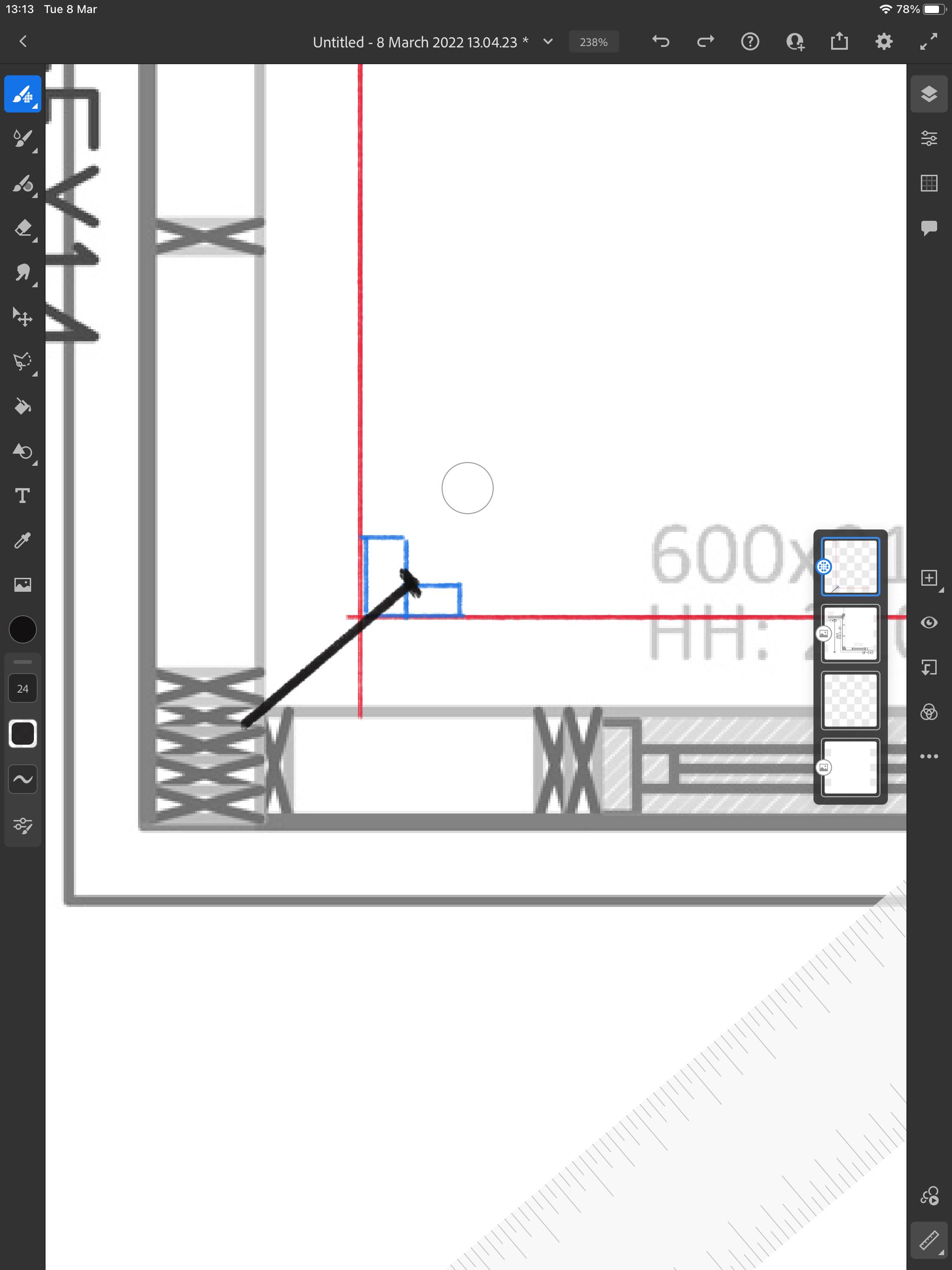

Thorfun Posted March 8, 2022 Share Posted March 8, 2022 hello, I'm wondering how others with timber frame houses have fixed service cavity battens to the studs in the corners when you have internal PIR? we have 80mm internal PIR covered with an AVCL so in the corners it's not possible to straight fix to the timber studs so do you simply screw at an angle and hope that you hit the stud? e.g. or is just attaching at bottom and top plate enough? Link to comment Share on other sites More sharing options...
cwr Posted March 8, 2022 Share Posted March 8, 2022 You could attach more batten to the side of the existing batten. Link to comment Share on other sites More sharing options...
Thorfun Posted March 8, 2022 Author Share Posted March 8, 2022 3 minutes ago, cwr said: You could attach more batten to the side of the existing batten. too late for that I'm afraid! the walls are already full of mineral wool and the PIR is already attached to the studs (and in one room the VCL is already fixed). if there's no other option then I can potentially do that but it's a ball ache. 😉 Link to comment Share on other sites More sharing options...
Thorfun Posted March 8, 2022 Author Share Posted March 8, 2022 4 minutes ago, cwr said: You could attach more batten to the side of the existing batten. and I presume you mean 'studs'? so add extra studs to the TF walls making them 80mm wider so it is past the PIR? that's a LOT of extra timber. plus a lot less insulation in between the studs. Link to comment Share on other sites More sharing options...
Thorfun Posted March 8, 2022 Author Share Posted March 8, 2022 like this @cwr? 1 Link to comment Share on other sites More sharing options...

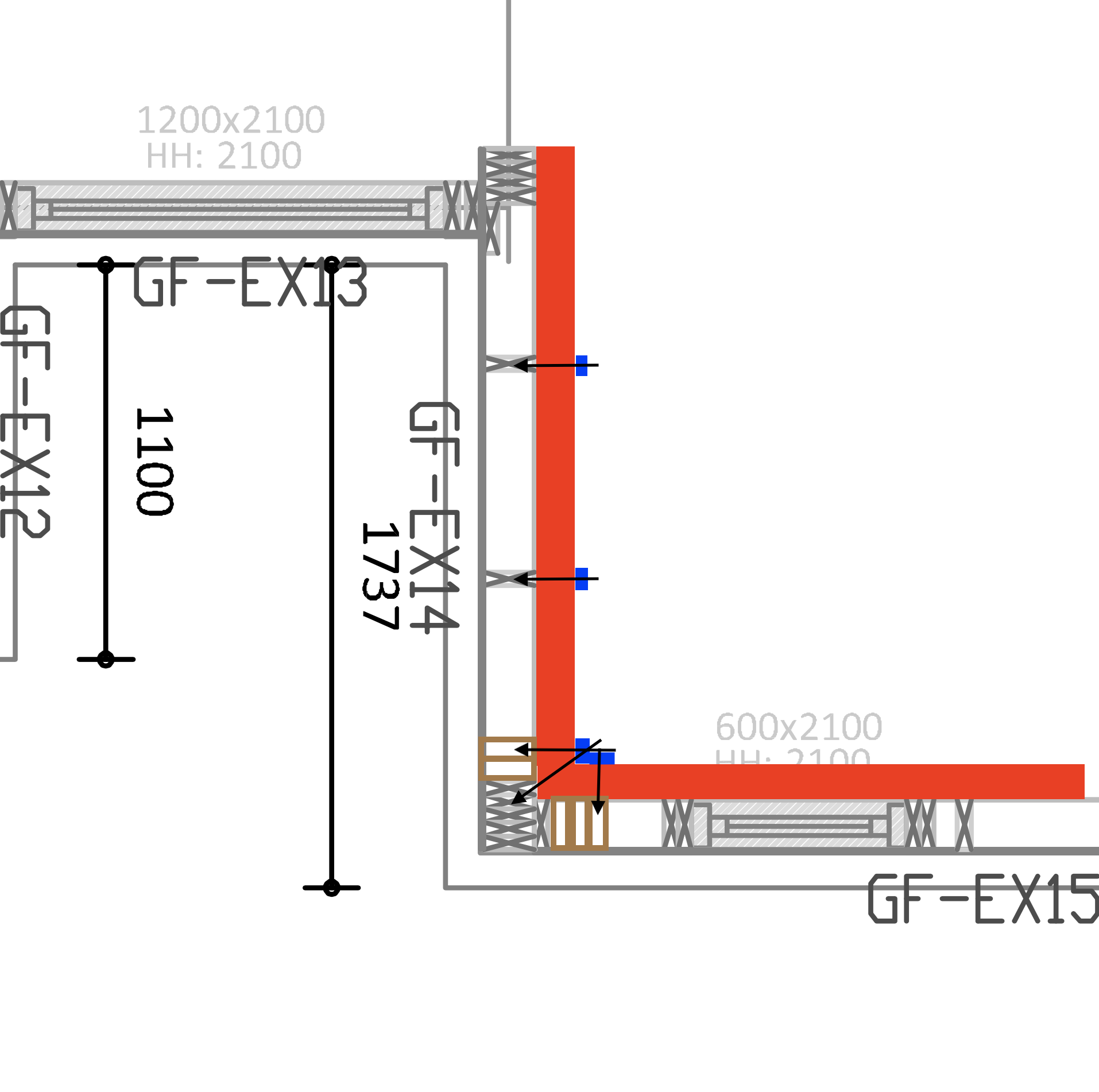

Thorfun Posted March 8, 2022 Author Share Posted March 8, 2022 so, basically, this? 1 Link to comment Share on other sites More sharing options...
Mr Punter Posted March 8, 2022 Share Posted March 8, 2022 Will be OK. Make sure to plasterboard the shorter side first. 1 1 Link to comment Share on other sites More sharing options...

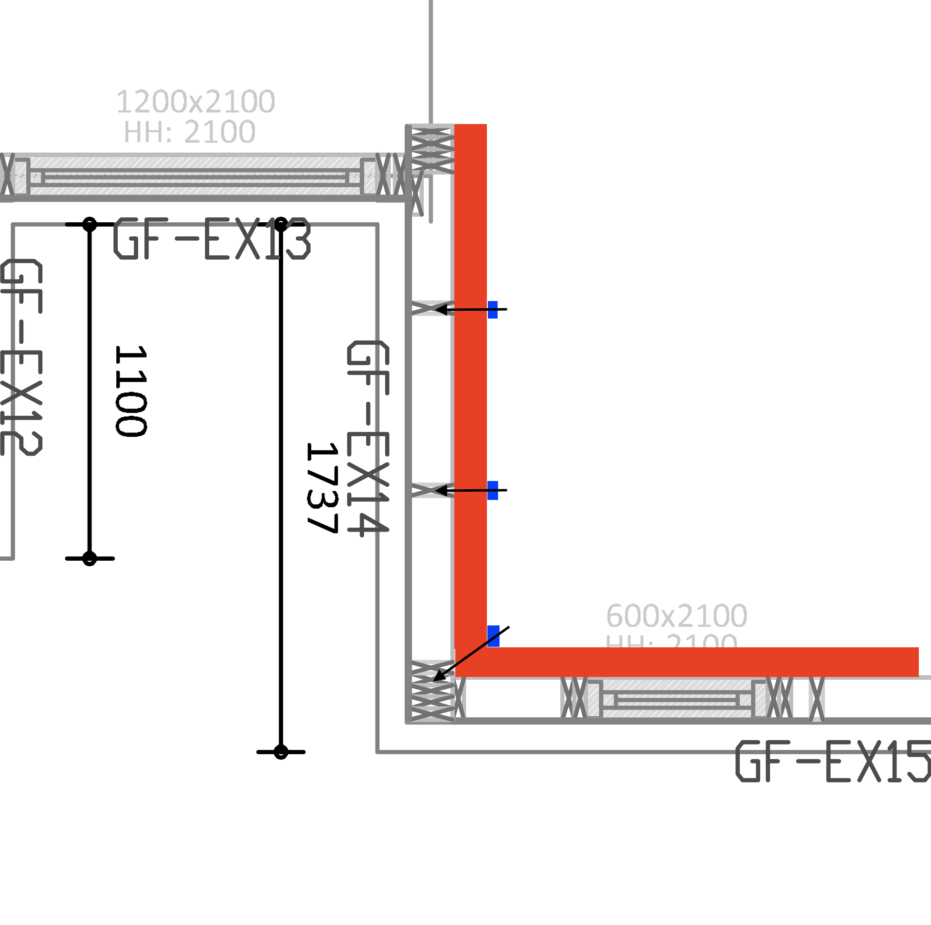

Simplysimon Posted March 8, 2022 Share Posted March 8, 2022 6 hours ago, Thorfun said: so, basically, this? yes, but i would put a wide piece where the one horizontal on the page first and screw it to the one vertical on the page then fix diagonally into studs Link to comment Share on other sites More sharing options...
Thorfun Posted March 8, 2022 Author Share Posted March 8, 2022 13 minutes ago, Simplysimon said: yes, but i would put a wide piece where the one horizontal on the page first and screw it to the one vertical on the page then fix diagonally into studs sorry. I don't understand this at all! but it has been a long day. Link to comment Share on other sites More sharing options...
Simplysimon Posted March 8, 2022 Share Posted March 8, 2022 34 minutes ago, Thorfun said: sorry. I don't understand this at all! but it has been a long day. 1 Link to comment Share on other sites More sharing options...
Thorfun Posted March 8, 2022 Author Share Posted March 8, 2022 49 minutes ago, Simplysimon said: Ok. That makes sense. Thank you. Link to comment Share on other sites More sharing options...
