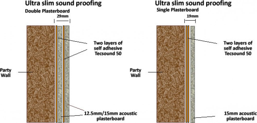

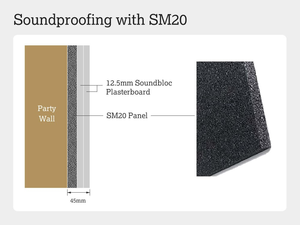

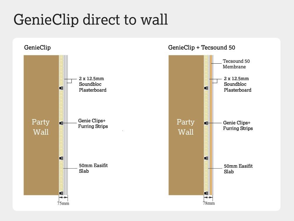

ashthekid Posted March 4, 2022 Author Posted March 4, 2022 @nod Thank you So a gypsum sound coat could be applied directly to the blockwork and then perhaps an 12mm timber batten and 12.5mm acoustic plasterboard on top? I could even squeeze in a layer of Gypliner wall and ceiling isn't a viable option sadly. Has anyone used the SM20 rubber panels between the wall and plasterboard? Or GenieClips? Or Tecsound 50 (2mm layer)?

ruggers Posted March 14, 2022 Posted March 14, 2022 On 04/03/2022 at 22:24, ashthekid said: @nod Thank you So a gypsum sound coat could be applied directly to the blockwork and then perhaps an 12mm timber batten and 12.5mm acoustic plasterboard on top? I could even squeeze in a layer of Gypliner wall and ceiling isn't a viable option sadly. Has anyone used the SM20 rubber panels between the wall and plasterboard? Or GenieClips? Or Tecsound 50 (2mm layer)? All of them are good examples but I'd expect the genie clip with tech sound 50 to work very well as theres less contact patches. Sound struggles to travel through different layered materials with varying thicknesses. So on double glazed windows, if you can have the inner and outer panes of glass at different thicknesses it stops the frequency travelling through so easy. The same applies to the walls when your decoupling the plasterboard with the rubber sheet or using two different types of plasterboard. You might want to also decouple the stud work from the floor walls and ceiling but it depends how far you want to go. Staggered twin stud walls work best with rockwool in both.
