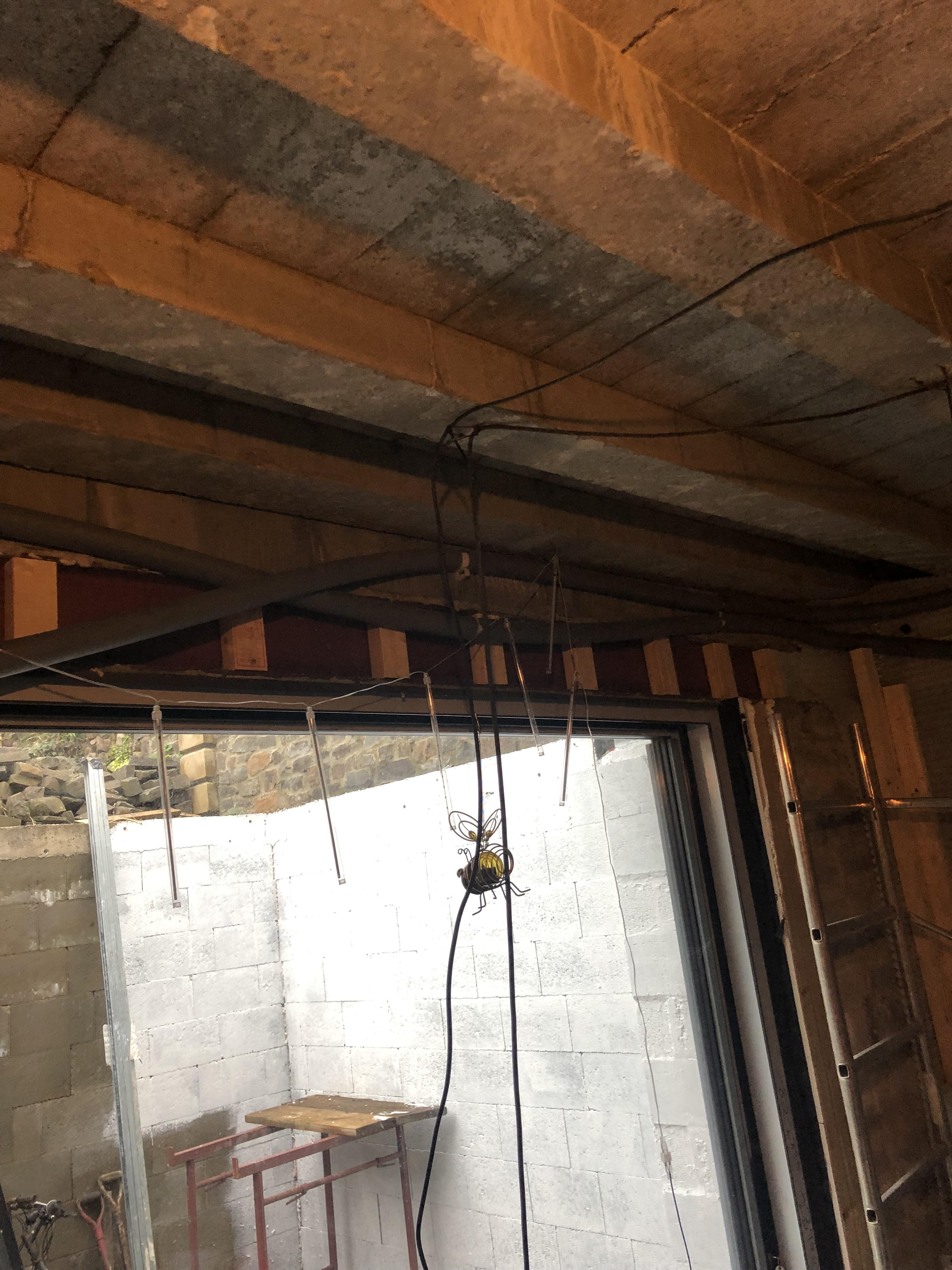

Struggling with timber to steel
I had loads of these to do. Well in excess of a hundred. I bought a bulk pack of mixed drill bits from screwfix. Then used the 5mm ones to make the pilot hole. 2 or 3 holes and its blunt, but they are dead cheap. Then use those self tappers and it works a treat. I just used my cordless drill and it was fine.

I screwed a wall plate to a 254 x 146 x 143 UB which had a flange thickness of 12.7mm. I used these which have a long enough cutting end bit to go through material of that thickness and possibly a bit more - I have the box somewhere and I'm sure it listed the max material thickness

Hilti gun warning. For 15mm steel you need the strongest bullets. I took a shot for interest. Even with a warning the recoil was a shock  and if let go would be very dangerous. I always specced screws where possible....and you know they are fixed.
Speak to a proper fixings supplier and tell them what you are fixing. A box of very good screws is cheaper than hilti nails too, let alone hire charges.

1 hour ago, pocster said:
As in that video I linked .
teq drill bits . Wd40 , Jack . Give that a try tomorrow 💪💪💪🇺🇦
Even water helps, but tbh it wasn't too hard with the pilot bit first. Not for me anyway.....

15 minutes ago, pocster said:
I’m guessing my current drill bits aren’t man enough . Even trying to get a decent pilot hole is hard work .
I just used cheap as chips multi pack from screwfix,    ERBAUER STRAIGHT SHANK HSS DRILL BIT TRADE PACK 150 PIECES, 30quid for 450 pieces. Couple of holes and chuck it in bin.

How big a hole do you need to drill as a pilot?
No.1 use decent bits. DeWalt Extreme are superb.
Use a cutting compound. Dip the drill end in before you start then periodically as you drill.

Glued those noggins in the steel - they ain’t going anywhere.
Regarding this method with drill , timber and clamp ….. It will work but … when I properly workout how many holes I have to do and access to the steel then it’s not going to be much fun . Also ( sad to say ) my Dewalt drill died ; smoke ; splutter ; dead 😞
So had to order to new one .
Realising as usual a man fails whilst trying to save pennies I also ordered a cheap mag drill . Not Dewalt ; but it’s yellow 💪
