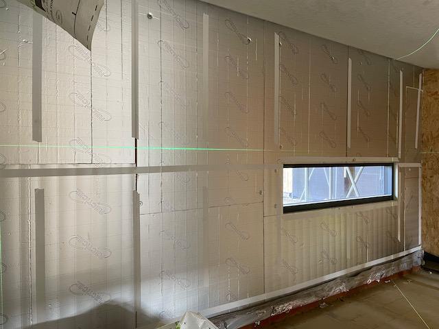

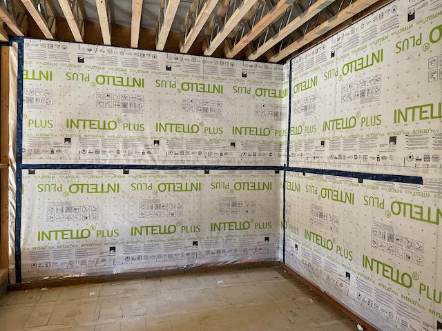

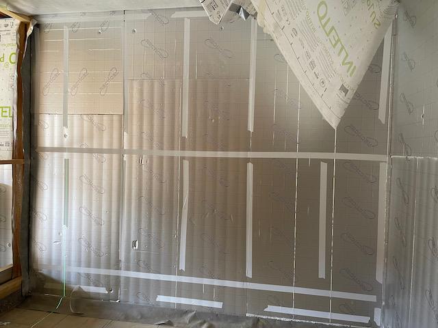

Thorfun Posted March 7, 2022 Share Posted March 7, 2022 @DragsterDriver I have started down the double-sided tape route and it is working well so far! but I haven't tried to yank it off the wall yet (and I'm not going to!) but it is staying put for now and I'm sure it'll be ok until I can get the battens up to hold it all in place securely. 2 Link to comment Share on other sites More sharing options...
DragsterDriver Posted March 10, 2022 Author Share Posted March 10, 2022 On 07/03/2022 at 11:56, Thorfun said: @DragsterDriver I have started down the double-sided tape route and it is working well so far! but I haven't tried to yank it off the wall yet (and I'm not going to!) but it is staying put for now and I'm sure it'll be ok until I can get the battens up to hold it all in place securely. Looking good! 1 Link to comment Share on other sites More sharing options...
Mr Punter Posted March 10, 2022 Share Posted March 10, 2022 On 07/03/2022 at 11:56, Thorfun said: @DragsterDriver I have started down the double-sided tape route and it is working well so far! but I haven't tried to yank it off the wall yet (and I'm not going to!) but it is staying put for now and I'm sure it'll be ok until I can get the battens up to hold it all in place securely. Why did you use the intello plus? You have foil faced PIR underneath. I thought Intello was mostly for vapour permeable and / or blown in insulation. Polythene would surely have been fine, or ali taped joins? Link to comment Share on other sites More sharing options...
Thorfun Posted March 10, 2022 Share Posted March 10, 2022 49 minutes ago, Mr Punter said: Why did you use the intello plus? You have foil faced PIR underneath. I thought Intello was mostly for vapour permeable and / or blown in insulation. Polythene would surely have been fine, or ali taped joins? coz i'm a sucker for marketing. 😉 I wanted some kind of barrier to reduce off-gassing from the PIR in to the house and using polythene sheeting just didn't 'feel' right to me so I wanted something with technology that could potentially help in it. and after shopping around I found I could get the bee-knees stuff from Germany for cheaper than a cheaper AVCL so figured why the heck not! I don't know if it'll make a difference but if I didn't use it I'd always be thinking 'I wonder if using Intello plus would've been better?' Link to comment Share on other sites More sharing options...
