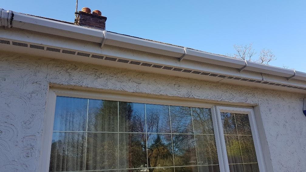

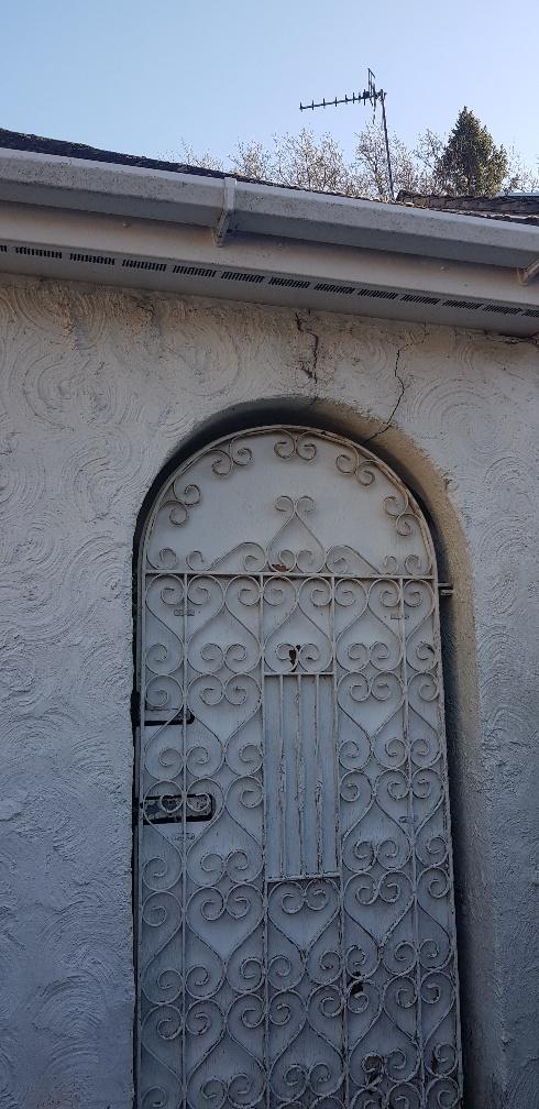

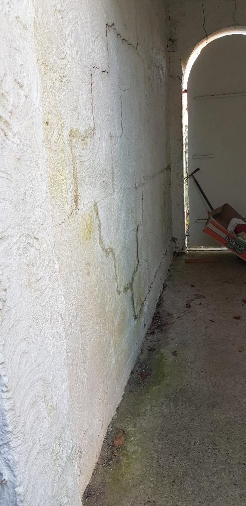

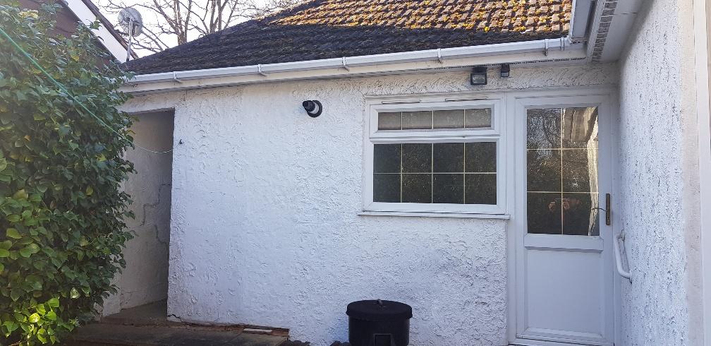

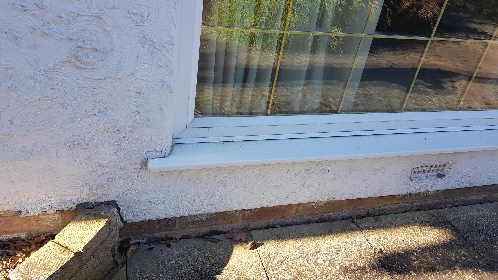

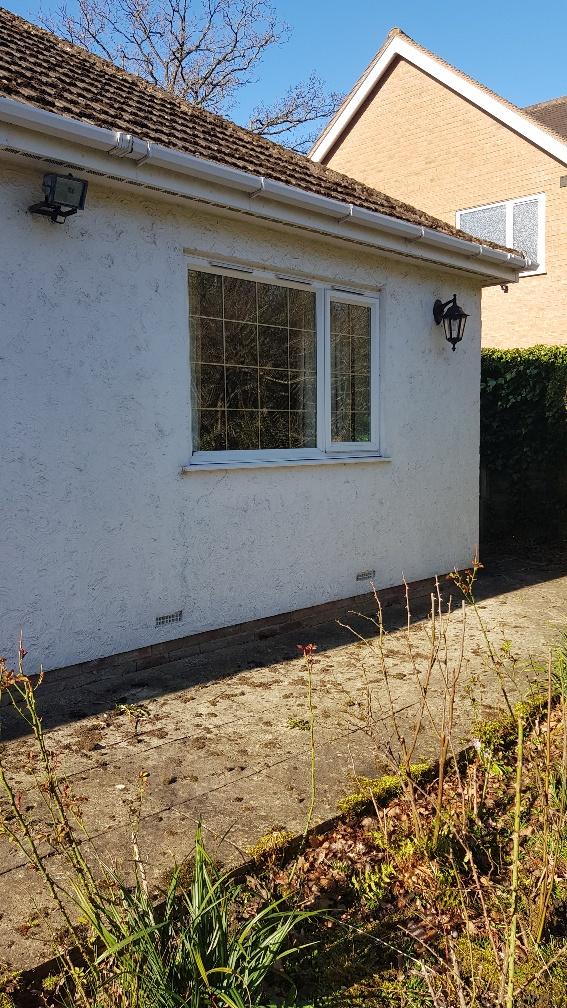

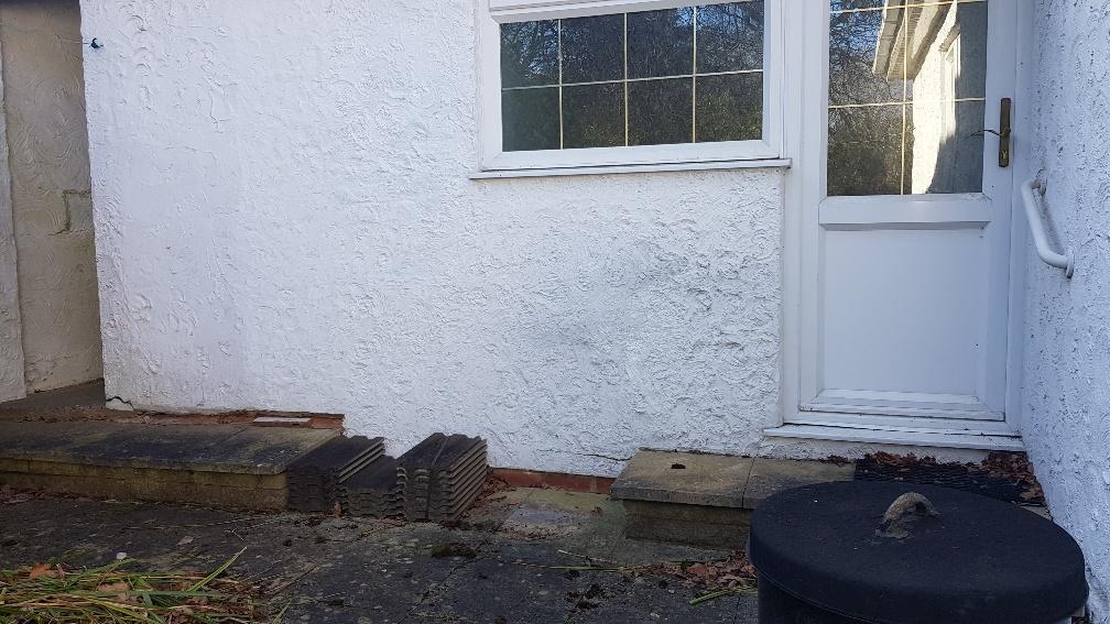

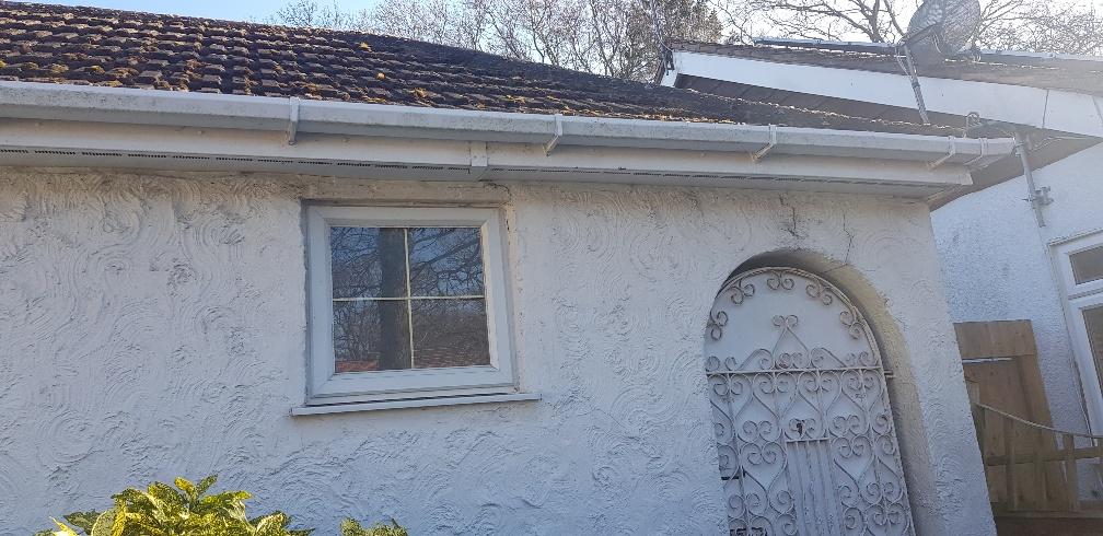

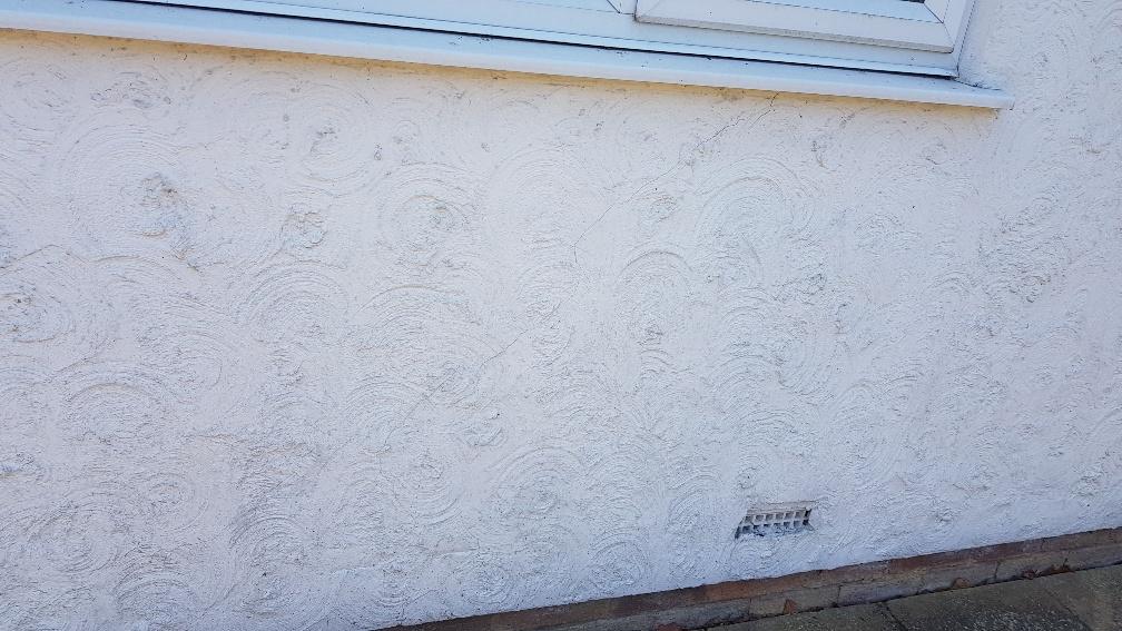

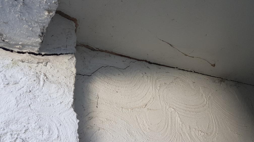

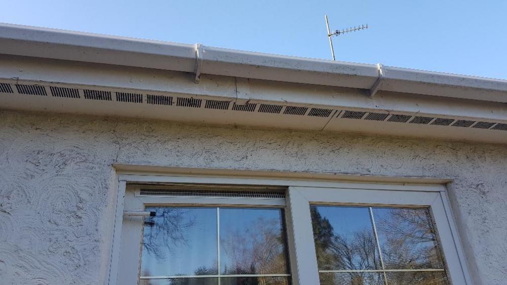

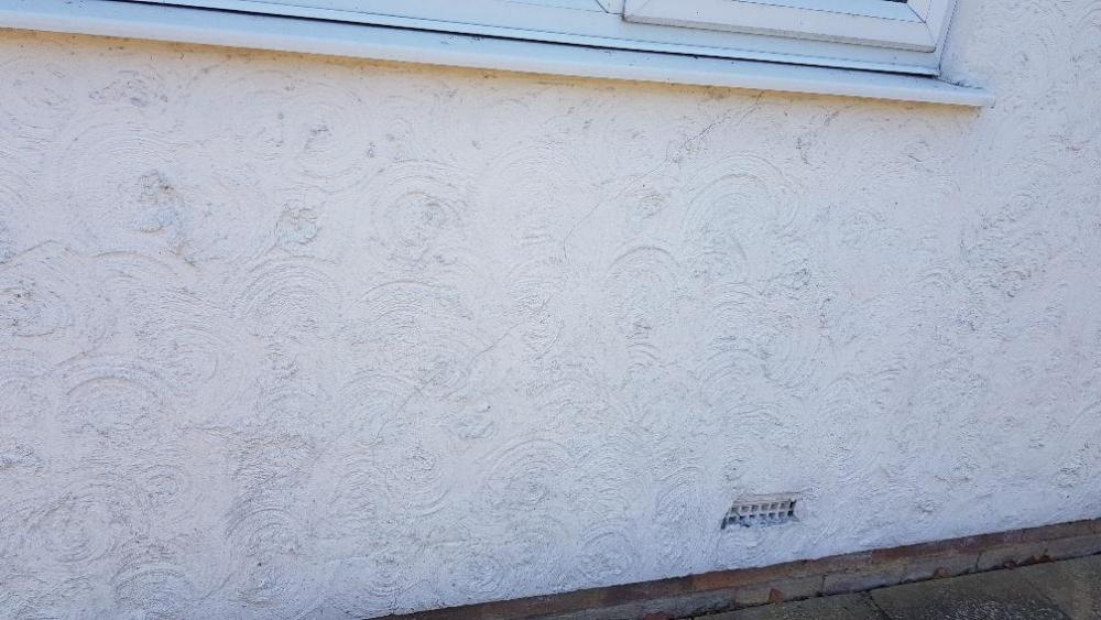

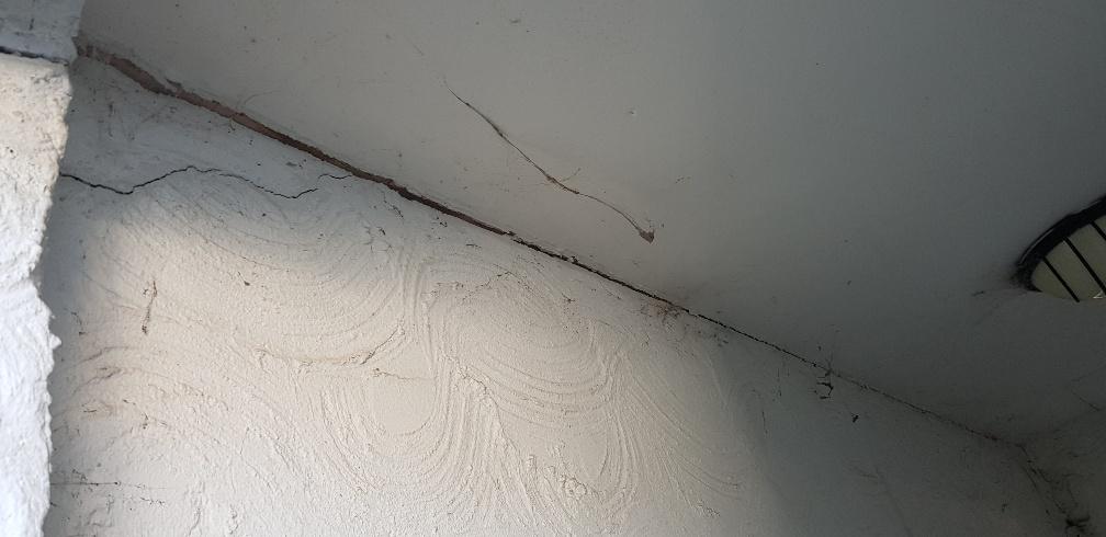

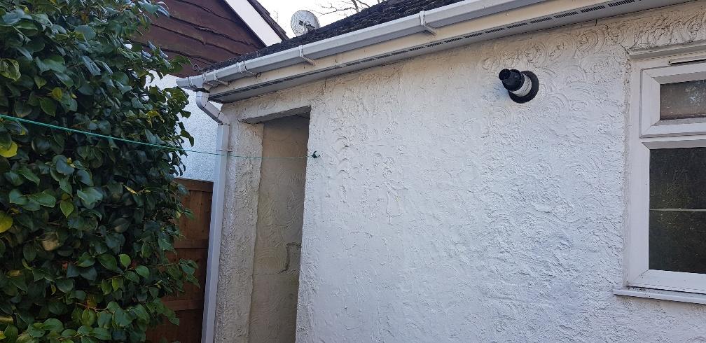

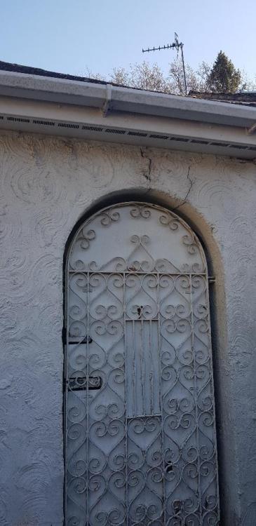

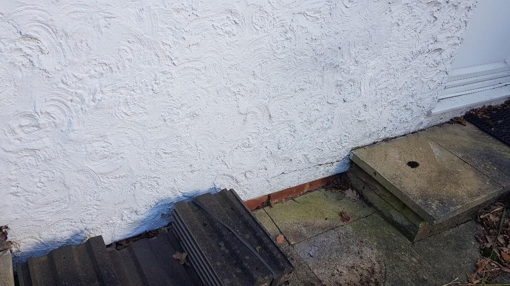

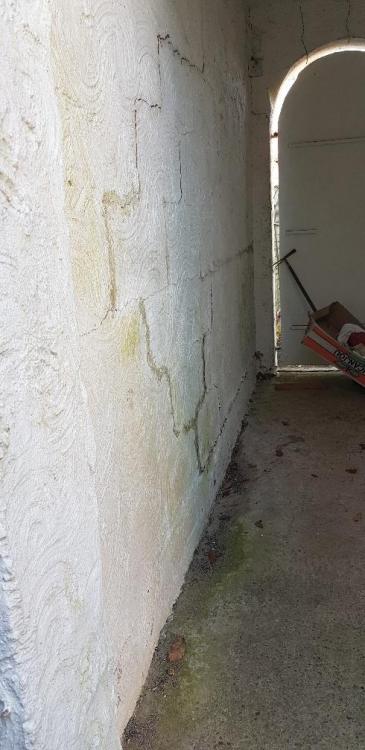

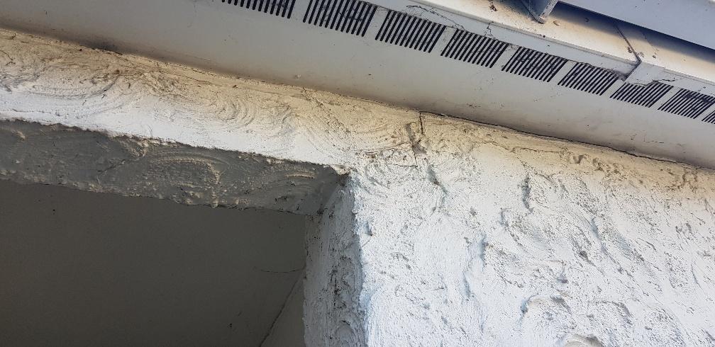

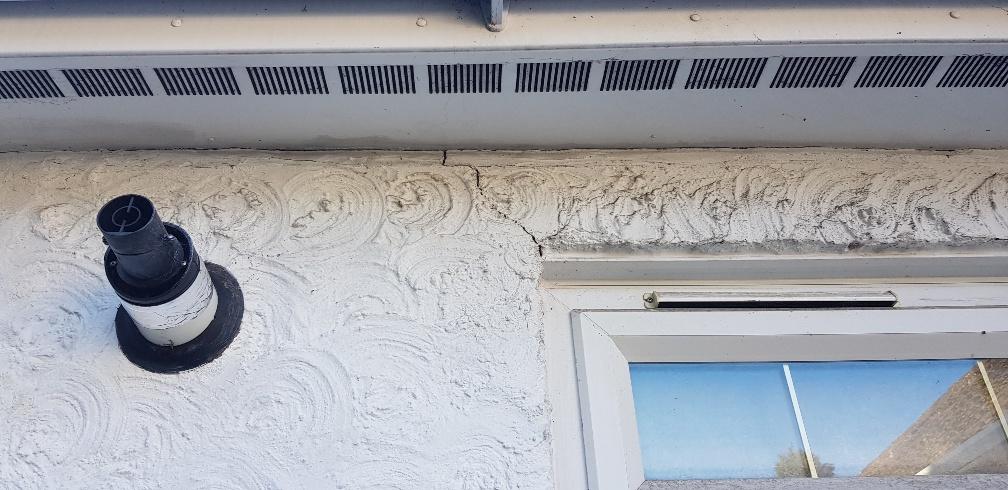

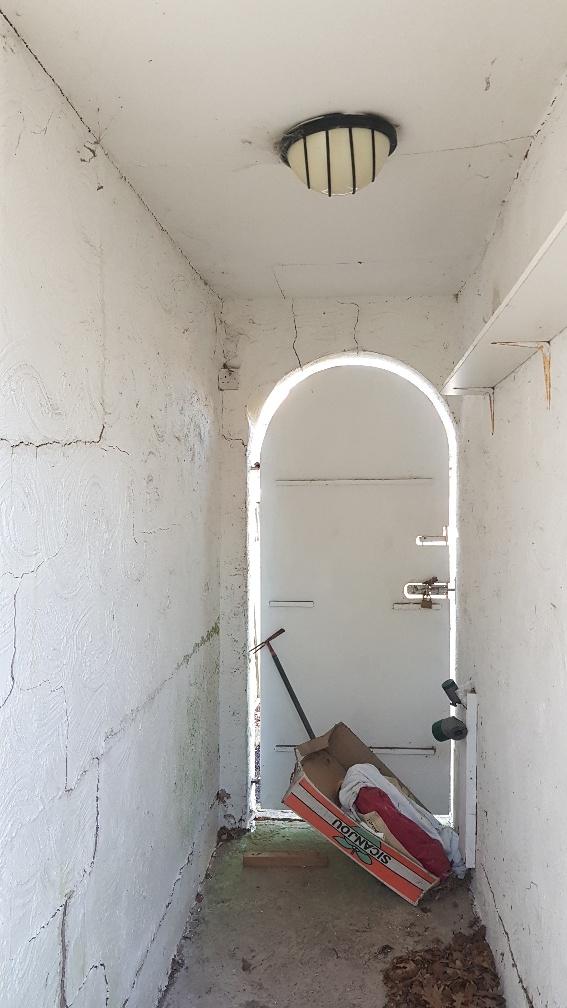

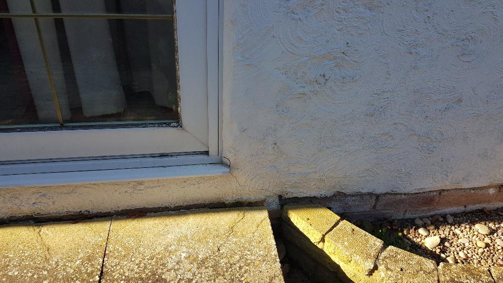

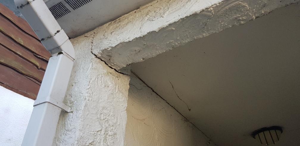

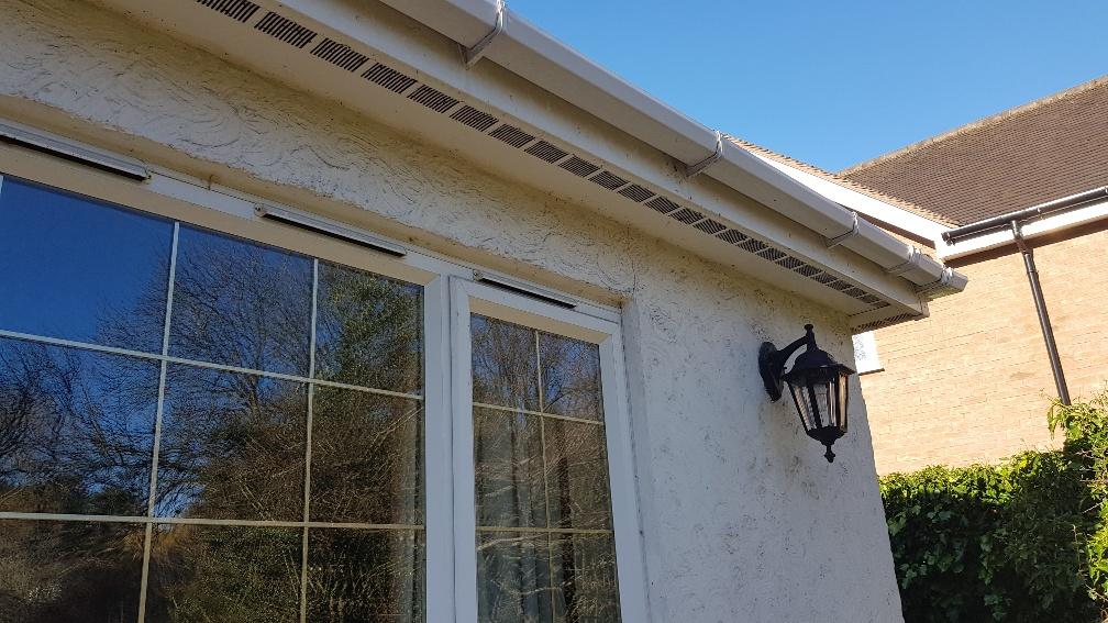

Hi. Please see attached the images relating to cracks in the extension areas. Internally the entire wall is covered by the wall paper and I cannot see any crack other than some minor cracks on the ceiling here and there (potentially age related). Cracks are the most significant in the extension. On the main house, there are cracks on the external render mainly around the top and bottom of windows/door either side. The images below are only for the extension. I will post separately crack on the external render of the main house.
Please could you let me know your thoughts if this could isolated to only extension and if can be fixed by rebuilding with local piles in the extension area without need to underpin the entire house?
Also, based on the second post below, are the cracks on the remainder of the bungalow something to worry about?
PS: I will be contacting the structural Engineer for his opinion. The purchase is expected to complete in Mar 2022. I did not go for the structural survey initially as I intended to demolish the house but the plan to refurbish it initially and see how things progress hence keen to ensure that structurally any issues are identified and dealt with before completion.

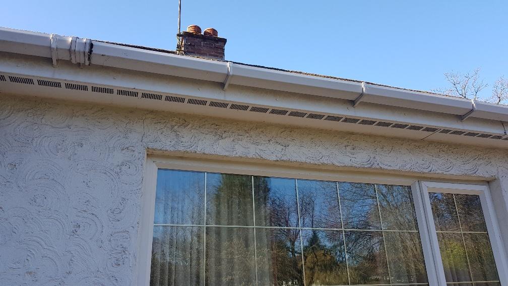

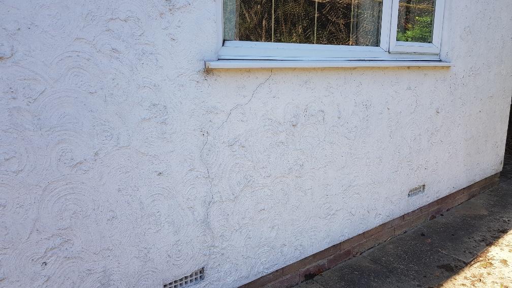

Photos of the main house attached. Any help would be greatly appreciated.
I’m not a SE, so no idea really. But based on my own experience of subsidence in a house of a similar age and style, I think that apart from where that tunnel is, none of this looks too serious. Most of your cracks (apart from that tunnel) appear to be close to windows or door arches.  It is more likely that the lintels have rotted or given way slightly, or just shrunk a bit, as lintels in 1920s and 1930s houses were made of wood, which obviously isn’ta great material for a lintel when it is c. 100 years old.
it might be a case of removing the render, then use helibars to stitch the underlying brick work together and possibly also replace the lintels, though this isn’t always necessary. My SE designed a fix like this for the front facade of my 1930s semi when we discovered the brickwork had cracked around the windows after removing the render.

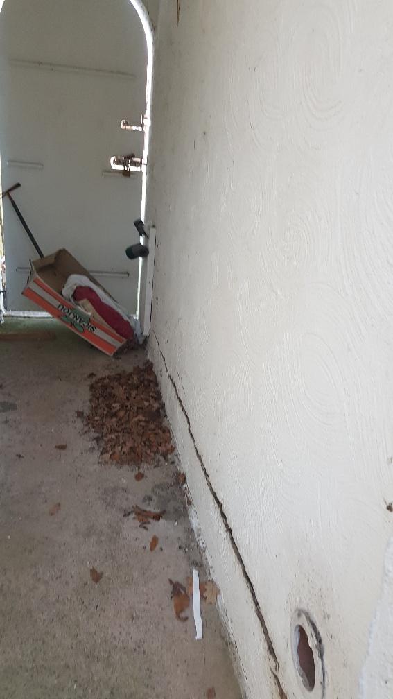

As for the tunnel, that doesn’t look great. But could look worse than it is!
Edited by Adsibob

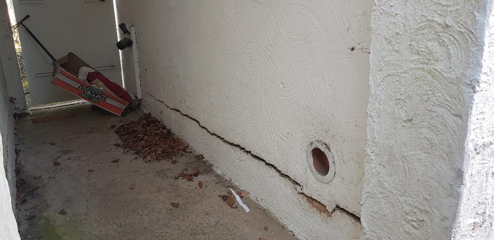

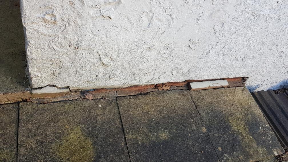

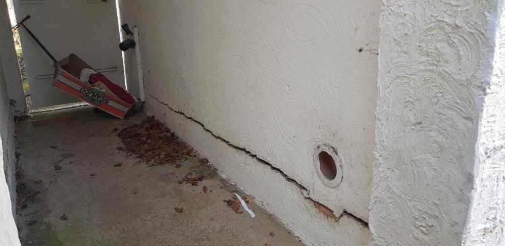

Not much to add either but i would be more looking at the 7th image, where the crack runs horizontally and appears to widen to one end.
Money spent on a proper survey  will allow you to sleep at night. Nowt worse than not knowing....
Arch too close to corner to be viable, flank wall to passage lots of cracks, looks like moving but could be wind, physical damage, poor foundations
side wall of house , crack at low level looks like push from inside, chipboard floor suspected but needs investigations

what crack are they talking about, there are lots of cracks
If you are buying, then surely your offer is subject to survey? Get a survey from a decent surveyor and ask him to focus on the issues that really matter: subsidence and damp and wood rot. Then see what his survey says and then decide. A little bit of settlement won’t stop you from getting insurance. Subsidence might, and that is when it becomes problematic to sell. Alternatively, if it is fixable with a a few linear metres bit of underpinning or helifixing, then it’s not such a big deal, and you can get a SE to issue a certificate of structural adequacy to enable you to get insurance. Armed with a survey, you can get a quote for the work and the certificate and go back to the vendor and ask for a discount to account for all of that.
Doubt you’ll get a surveyor to ignore that big horizontal crack - that could well be subsidence from leaking drains below the concrete slab all round the house. I’ve seen whole sections disappear and the concrete acting like a bridge ..!
If you’re talking about underpinning then you will need deep pockets as it could be £20-30k and you’re already bidding over the odds. Working in that “tunnel” would be entirely manual and you would have to protect the the other side from subsiding when digging so it may need to be done from the inside.
Not one I would be taking on unless it was £50k under the average for the area as what else needs doing if that’s the mess you can see ..?

It's the cracks in the tunnel area picture 1,5,7 and 8. What I meant was that they would need to pay for the work. I can manage the work. But question is how best to approach it?

I am talking about removing the extension altogether and then rebuilding it with proper auger piles of 11m deep. There are two wall so probably 6piles should be enough but something to be designed by the SE. Then finish with ring beam and extend roof over it. Size of extension requiring the rebuild is 5m by 3.7m. I want to stay away from underpinning as dont want the record tainted as it makes the property difficult to sell, relatively speaking.

Single storey extension I would go for a raft every day of the week - piling will be a huge effort for a small section of building.
I’d also consider the whole lot going if you’re having to do that for such a small part - why the desire to rebuild what is there..?

It's on a very soft clayey land. I have already commissioned GI report and they suggested only way is Auger Piles at 11m or ground improvement work.
