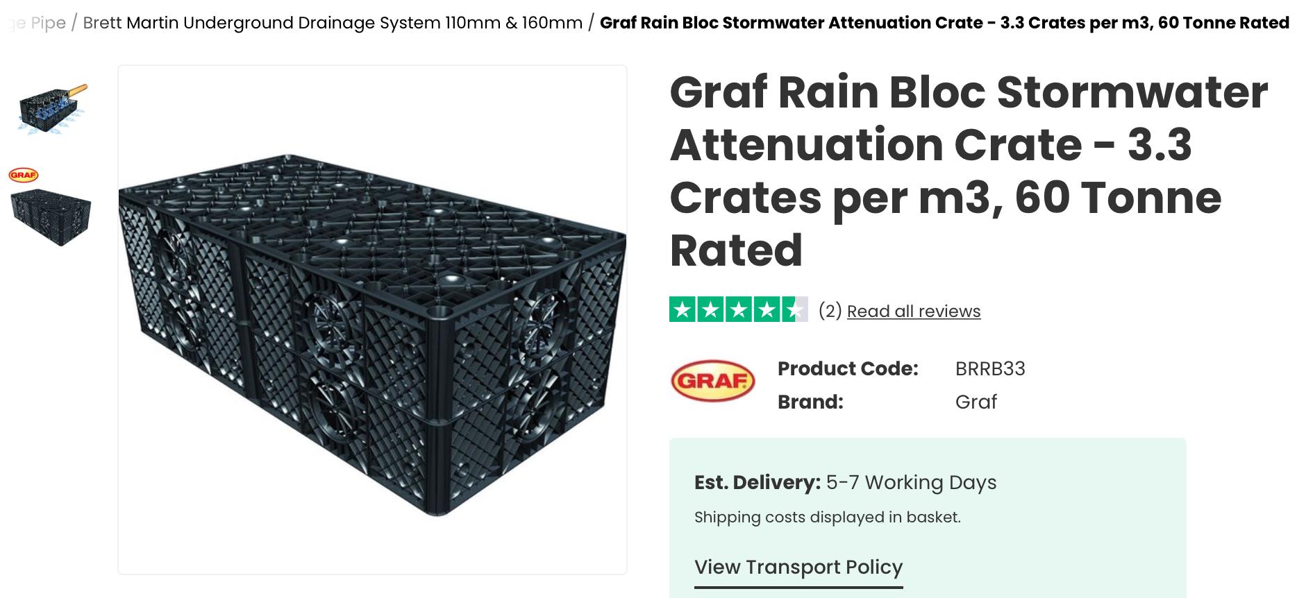

dangti6 Posted February 24, 2022 Posted February 24, 2022 Might be misinterpreting your final statement, but why not use crates? The older method of filling a soakaway with material reduces the volume and therefore requires a larger 'hole'.
catrionag Posted February 24, 2022 Author Posted February 24, 2022 6 minutes ago, dangti6 said: Might be misinterpreting your final statement, but why not use crates? The older method of filling a soakaway with material reduces the volume and therefore requires a larger 'hole'. Apparently we can't have crates since it's under the driveway - supposedly we need the gravel/hardcore in order to support the weight of vehicles. Unfortunately there is no space for it anywhere else on the plot as it would be too near buildings or boundaries.
markc Posted February 24, 2022 Posted February 24, 2022 1 minute ago, catrionag said: Apparently we can't have crates since it's under the driveway - supposedly we need the gravel/hardcore in order to support the weight of vehicles. Unfortunately there is no space for it anywhere else on the plot as it would be too near buildings or boundaries. You could use crates but would then need a load bearing “bridge” to support vehicles. some crates do have a load bearing rating but no idea what it is.
dangti6 Posted February 24, 2022 Posted February 24, 2022 Check the crates data sheets, loads to choose from for trafficked areas and can take many many tonnes.
catrionag Posted February 24, 2022 Author Posted February 24, 2022 So I'd basically been advised by the bloke that's doing our groundworks that we'd need to use a hardcore infill for the soakaway since the driveway is going to be the only access onto site and will need to take the weight of heavy plant/lorries etc. I hadn't realised they would be available rated for such heavy loads, so I'll check back in with him! Otherwise I guess it would mean we'd just need to dig up the driveway again after the build to put the crates in?

Mr Punter Posted February 24, 2022 Posted February 24, 2022 Often the crate manufacturer will give you the design, based on your plan, drained area and permeability. That should satisfy building regs / warrant. 2
catrionag Posted February 24, 2022 Author Posted February 24, 2022 45 minutes ago, Mr Punter said: Often the crate manufacturer will give you the design, based on your plan, drained area and permeability. That should satisfy building regs / warrant. That's excellent to know, thank you!
saveasteading Posted February 24, 2022 Posted February 24, 2022 7 hours ago, catrionag said: filled with hardcore/gravel) If you buy single sized stone, such as gravel, at least 2/3 is stone and only 1/3 is gaps for the water. So you need a lot of it, gravel isn't good under a drive, other crushed stone is expensive, and you also need a porous top surface, Over time even this 1/3 tends to fill with silt. I don't know your builder but it is unlikely he knows all this. Crates can take artics as long as you get the right ones. The shallow ones allow the water to disperse into a greater area of ground, but are more expensive, and depend on porous surface. The boxy ones are fed from drains. Whichever method, you have to allow for the amount of rain and the percolation. The builders merchants (especially the drainage ones) can get the sums done for you, if you know the input numbers.
