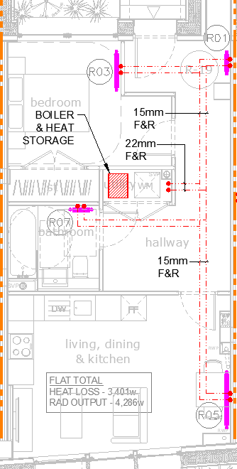

Installation seems flawed, uninsulated house with those little radiators? In new build developments with all their insulation we are seeing little 3500BTU rads and that includes a percentage of space for the calculated space heat loss and was based on a delta of 60°. I just can't see how that stacks up.

That isn't a rule of thumb, that is calculated room by room heat loss and a sized radiator, on new builds you cannot get by with rule of thumb anymore as you have SAP calcs and CO2 targets and council schemes and standards now. So this installation is systemically flawed.

I think you have misunderstood me.
I said the installation seems flawed, and you replied, "Yes but a rule of thumb that makes it "seem" flawed might not reflect reality. I gather that they were of the opinion that those rules of thumb weren't helping the industry, in the light of newer, more efficient HPs and better weather comp. So they did some calculations and used their office as a test to verify."
My reaction was based on you making the comment "rule of thumb", you have assumed that I am basing my response on rule of thumb heating requirement, as a building services consultant I spend my life calculating things, I don't do things by rule of thumb. So for clarity, no rule of thumb, calculated area heating based on calculated heat loss.
My reference to SAP calcs and LA requirements etc. was to point out that rule of thumb heating installations are not done anymore on new builds. Yes, there was a time when a plumber would look at a space, apply some typical figures and work out the heating requirements for a building and that was fine, it was just the done thing, energy was cheap and no one cared about CO2.
Now steering this back round to the point I am making, this installation seems flawed and I cannot see how it stacks up, here is a brand new flat in London, insulated to the hilt, it still needs PV on the roof to offset CO2 to achieve the required DER:
This is based on maintaining a room temp of 20°. Note the heat input required for this PIR air tight box...
