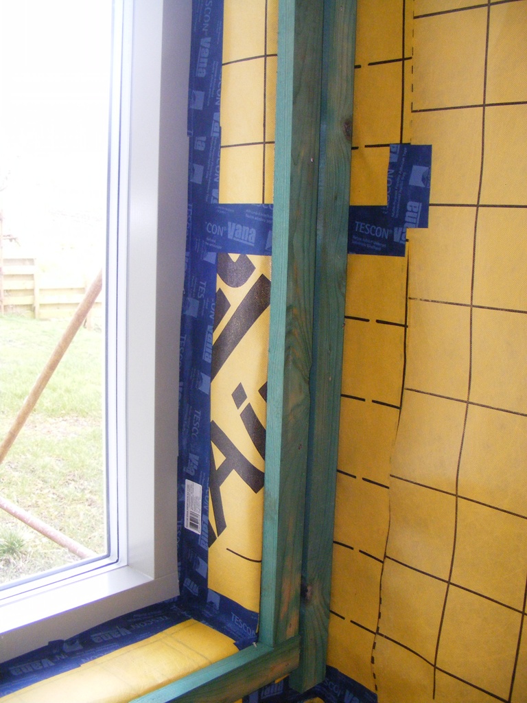

ProDave Posted February 21, 2022 Share Posted February 21, 2022 My No 1 tip, since you didn't mention it, is a service void. So as you line your entire house, with the air tight membrane, and all joints taped, you fix vertical battens at 600mm centres. This gives you a void to run cables and pipes without any of these penetrating your air tight layer. Only services that must exit the building penetrate the air tight membrane and are sealed where they do so. Some examples: 1 Link to comment Share on other sites More sharing options...
SuperJohnG Posted February 21, 2022 Author Share Posted February 21, 2022 (edited) 5 minutes ago, ProDave said: My No 1 tip, since you didn't mention it, is a service void Ah yes - I have one. After VCL exactly that next step, I was actually considering the electrical first fix then battens but the joiners want battens then just say to cut out the cable ways for the safe zones but does concern me as the VCL might get damaged at thats point. I see you have yours cut out there Dave during battening ? Also that you have 25mm battens I thiughtbthese would be too small for a service void for cables...isn't fitting cables in a 25mm deep box a nightmare for ring main? Edited February 21, 2022 by SuperJohnG Link to comment Share on other sites More sharing options...
ProDave Posted February 21, 2022 Share Posted February 21, 2022 1 minute ago, SuperJohnG said: I was actually considering the electrical first fix then battens but the joiners want battens then just say to cut out the cable ways for the safe zones but does concern me as the VCL might get damaged at thats point. Tell the joiners to stop being lazy. CUT the battens and leave gaps at 450mm above FFL and 1150mm above FFL as you can see in my first picture. Those are socket height and switch height are where you are most likely / be allowed, to run cables horizontally. Cutting battens as you fit them and leaving that small gap gives space for cables, and no danger of damaging the VCL when drilling the battens. and if the gaps end up not being used then no harm is done. It also makes it easy to use all your battens with no waste. 1 Link to comment Share on other sites More sharing options...
Thorfun Posted February 21, 2022 Share Posted February 21, 2022 12 minutes ago, SuperJohnG said: Also that you have 25mm battens I thiughtbthese would be too small for a service void for cables...isn't fitting cables in a 25mm deep box a nightmare for ring main? this is exactly what I was going to ask! I remember @ProDave saying that 25mm battens plus the 12mm plasterboard fits a 38mm backbox perfectly. am I misquoting you Dave? But I also note that many others have used 38mm x 50mm battens. as an electrician @ProDave which is best (or your preference) and why? Link to comment Share on other sites More sharing options...
ProDave Posted February 21, 2022 Share Posted February 21, 2022 I used 25mm battens almost everywhere. 25mm battens and 12mm plasterboard is a near perfect match for a 35mm back box. I even managed carefully to run 15mm copper pipe in a 25mm service void. I only used 45mm battens in the utility room where I had 22mm copper pipes to fit, and those, with fittings, simply would not fit a 25mm void. 1 1 Link to comment Share on other sites More sharing options...

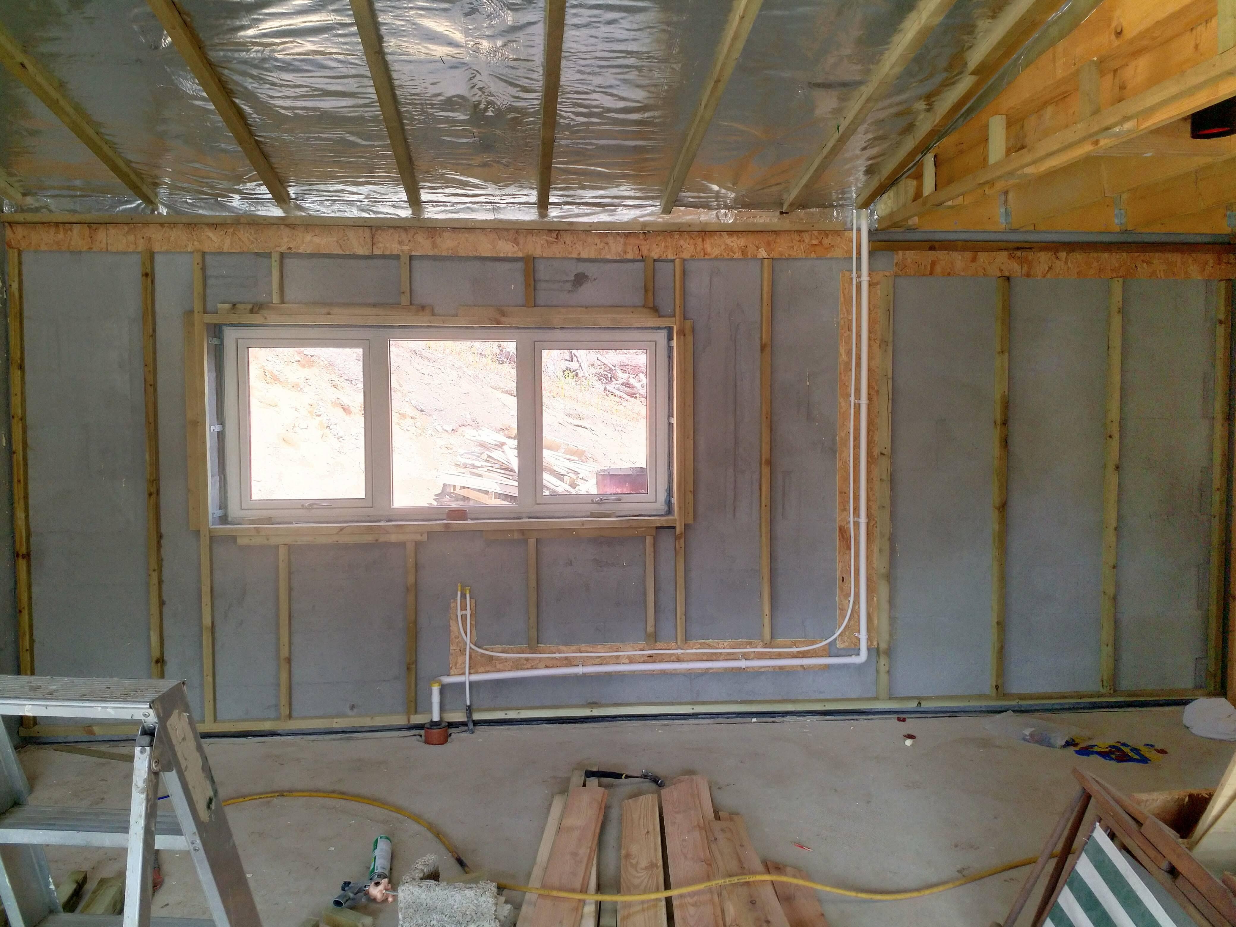

JohnMo Posted February 22, 2022 Share Posted February 22, 2022 Slightly different approach. Parge coat, service battons screwed to Durisol through parge coat, used a hybrid sealant at all screws. Made plates at top of wall for electrician to run wiring, same for where plumbing was running so all clips were secured to OSB, instead of direct to the wall. Below bottom horizontal battons, foam filled and airtight paint. 50mm battons everywhere. Link to comment Share on other sites More sharing options...
