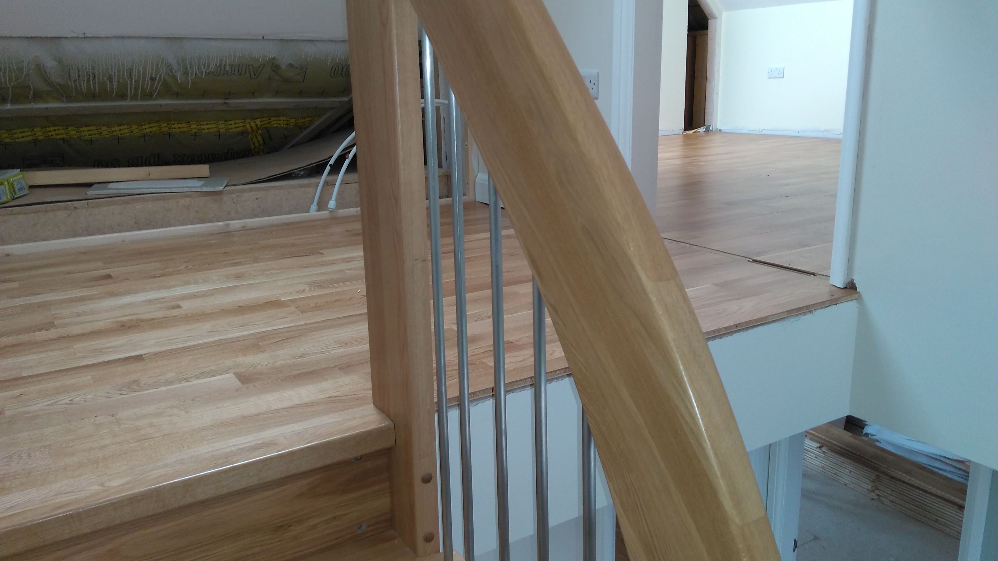

Stones Posted May 1, 2017 Share Posted May 1, 2017 See picture below of how we did ours, exactly as you propose: 20 mm top oak tread. 2mm underlay and 18mm oak flooring. Expansion strip over join. Link to comment Share on other sites More sharing options...

Stones Posted May 1, 2017 Share Posted May 1, 2017 No, its just been oiled with Osmo, the same as the oak. Works surprisingly well visually, something a bit different. Link to comment Share on other sites More sharing options...

JanetE Posted May 2, 2017 Author Share Posted May 2, 2017 12 hours ago, Stones said: See picture below of how we did ours, exactly as you propose: 20 mm top oak tread. 2mm underlay and 18mm oak flooring. Expansion strip over join. What was the profile of this expansion strip? Was it glued down? Link to comment Share on other sites More sharing options...

Stones Posted May 2, 2017 Share Posted May 2, 2017 (edited) 11 hours ago, JanetE said: What was the profile of this expansion strip? Was it glued down? T bar solid oak profile. Push fits into a plastic channel fixed to the subfloor. Sits 4mm proud of the finished floor. https://www.luxuryflooringandfurnishings.co.uk/brushed-and-lacquered-solid-oak-t-profile-door-bar-to-match-oak-flooring.html Edited May 2, 2017 by Stones Add link 1 Link to comment Share on other sites More sharing options...

Gone West Posted May 3, 2017 Share Posted May 3, 2017 12 hours ago, Stones said: T bar solid oak profile. Push fits into a plastic channel fixed to the subfloor. Sits 4mm proud of the finished floor. I'm a bit surprised that isn't considered a trip hazard especially as it's at the top of the stairs. Link to comment Share on other sites More sharing options...
Nickfromwales Posted May 3, 2017 Share Posted May 3, 2017 10 hours ago, PeterStarck said: I'm a bit surprised that isn't considered a trip hazard especially as it's at the top of the stairs. Not just me then Link to comment Share on other sites More sharing options...
Stones Posted May 3, 2017 Share Posted May 3, 2017 10 hours ago, PeterStarck said: I'm a bit surprised that isn't considered a trip hazard especially as it's at the top of the stairs. You've gone and said it now! Doubtless there will be a spate of tripping incidents in the next few days. In all seriousness, can't say there has been any issue and the Building Inspector was happy. As a consequence of your post, I've tried to catch my toe / foot on the strip but with rounded edges, it doesn't seem to be an issue. 1 Link to comment Share on other sites More sharing options...
jack Posted May 3, 2017 Share Posted May 3, 2017 Based on where it is, it's pretty unlikely you'd trip on it. You'd usually place your foot close to the top of the stairs (when going down). By the time your toe getsto the raised bit, your foot is decelerating, with the toe higher than the heel. It'd be just about impossible to catch it, but even if you did, there's no momentum to cause you to trip (you don't trip over things in front of you unless there's a lot of momentum). On the way up, your foot is raised over the last step and above the raised bit, then lowered onto it with little to no forward motion. Again, no way of tripping. I had the same concerns with the slight lip where our carpet joins our top step, but it just hasn't ever been an issue. Link to comment Share on other sites More sharing options...
