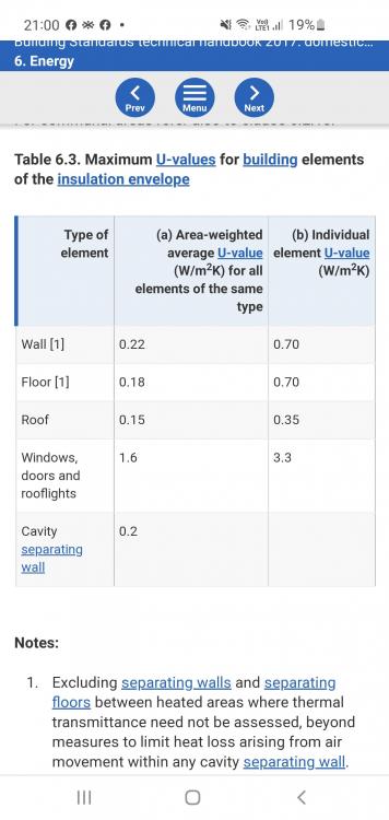

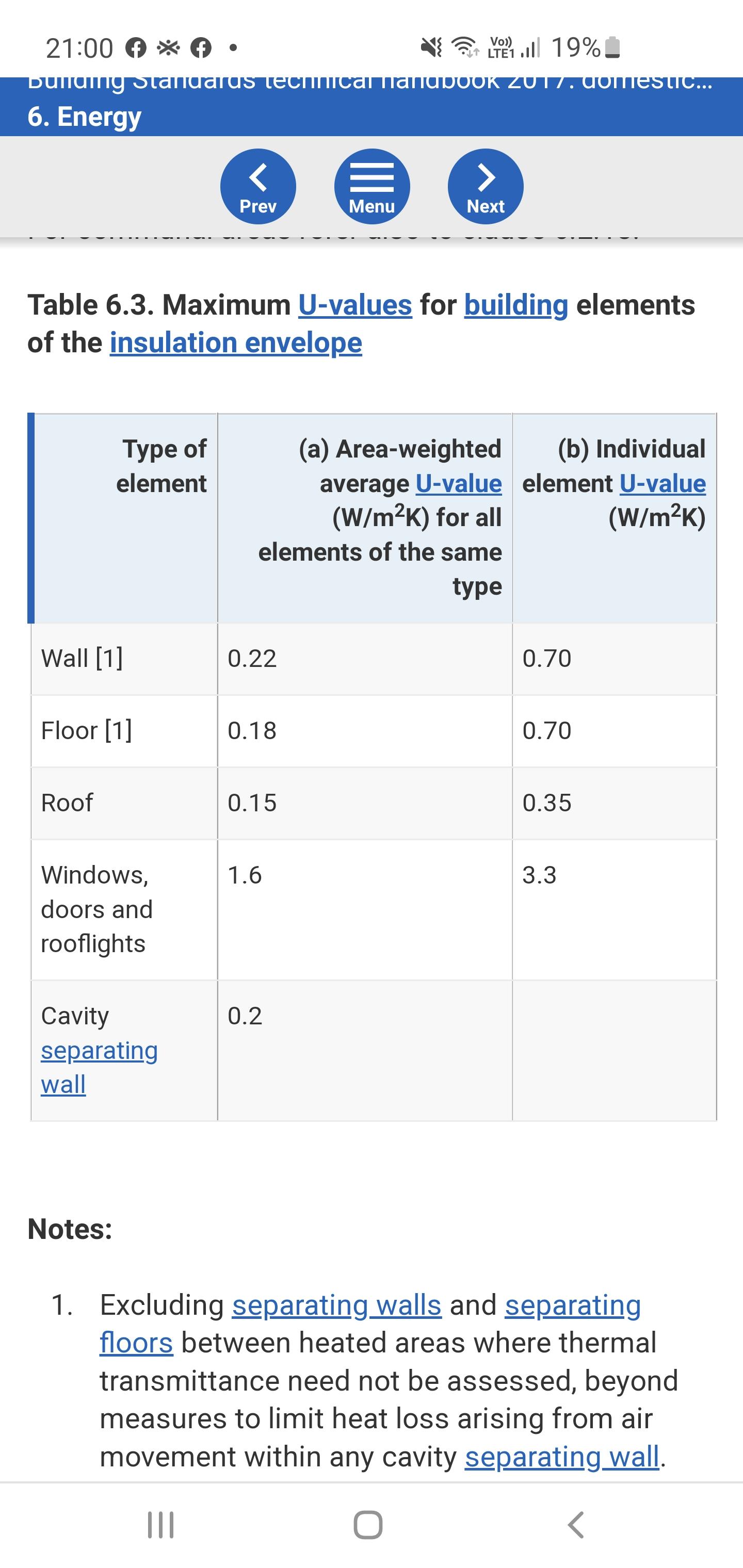

SuperJohnG Posted February 20, 2022 Posted February 20, 2022 Scottish regs attached.. 5 minutes ago, hb1982 said: 150mm in general is an overkil Overkill why?
