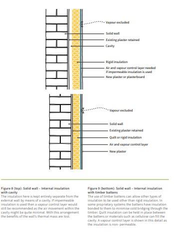

SimonD Posted February 17, 2022 Share Posted February 17, 2022 11 hours ago, bighouseproblems said: Yeah we have 9 rooms to retrofit, the smallest room apart from the bathroom is probably 4mx4m. The reason for not going natural is for a few reasons 1. Finding people who will do it contacted a few explained never heard back. 2. Cost which would be substantial 3. Noise levels the house is like a bomb shelter but we do have heavy goods vehicles coming past at times and would like it as quiet as possible. 4. Lastly I am starting to think about future proofing the house for solar and ashp with energy rates being what they are. £2,500 energy bill for the last year lol will probably be £5,000 this time next year ha. So in essence it's about coming up with a common sense solution that can be executed over the whole house in a relatively timely manner. Fair enough. 10 hours ago, saveasteading said: From recent reading, a masonry wall with lime mortar is going to breathe outwards. I can't see that encouraging evaporation into a warmish internal void is a good thing. Yes, the wall can breathe outwards, but I'm not sure where you're reading information that implies encouraging evaporation to a warmish internal void isn't a good thing. Once you install the IWI the internal temperature of the wall reduces, especially in winter and that in turn reduces the capability of the wall to dry out to the inside but it will also likely affect the ability of the wall to dry to the outside and potentially introduce frost risk. Current best practice guidance says to allow solid walls to breathe to both sides using some kind of moisture open insulation buildup and if you don't use a moiture open system then ventilate between the . Without the correct IWI system buildup, using something like cavity batts may not be suitable at all. If the insulation does not absorb any moisture, then that moisture may collect as condensation and then run down the insulation inside the wall and collect there and it has nowhere to go. For me there are some fundamental aspects missing from the puzzle you are both trying to solve. The first is airtightness which has the greatest single effect on retrofit energy performance, so first look at your strategy for airtightness. Second is moisture management or the hygrothermal properties of the system buildup. Here are some quotations giving current guidance on best practice for solid wall IWI, with links below: Quote 44. The lowest risk designs for internal wall insulation are consistent with the existing moisture strategy of the building. For solid walled (traditional) buildings, this is likely to be moisture open, so capillary active insulations (such as woodfibre) and vapour open adhesives and finishes shall be chosen. This does not involve the use of vapour barriers7, but will include an air barrier. This allows drying to both sides of the internal wall insulation and therefore maintaining the moisture balance within the wall. A Bristolian’s Guide to Solid Wall insulation contains more information about this approach and illustrates a series of vapour open designs for internal wall insulation.8 45. The risk of interstitial condensation with internal wall insulation can be high due to warm internal air passing through or around the insulation and airtightness layers and condensing on the cold wall, and/or from external moisture within the masonry. The addition of a vapour barrier inside internal insulation (IWI) on solid walls used to be regarded as essential, partly due to inappropriate moisture risk assessment methods. However, it is now agreed that, in many cases, this may cause more harm than good. Therefore, a moisture open internal wall insulation build-up is recommended in the insulation of solid walls, or alternatively a moisture closed system with a ventilated cavity (of at least 25mm) on the cold side. Quote Insulation thickness • Do not target a finished (i.e. post- insulation) wall U-value of lower than 0.6 W/m2K – this typically means a maximum insulation thickness of around 60mm. This is because the more insulation you put on the wall the greater the heat resistance and the colder the wall, thereby reducing drying potential and increasing condensation risks. In addition, heat loss modelling has demonstrated that, due to unavoidable thermal bridging with IWI, applying larger amounts of insulation will generally have reduced effectiveness (i.e. there is an optimum insulation depth, beyond which the cost-benefit ratio reduces signifcantly) Quote • All sources of acute damp should be explored and addressed before installing IWI. The wall should always be dry on the inside (and most of the way through to the outside) before any IWI installation Quote Moisture quality of insulation system Always use ‘moisture-open’ insulation systems for IWI, to ensure that walls can dry to the inside as well as the outside of the building – this will help minimise the risk of moisture-related problems outlined previously. Using moisture-closed insulation systems reduces the wall's capacity to dry, which is particularly important if the wall is wet in any way due to driving rain, residual damp, or condensation. In this case, ‘moisture open’ means both vapour permeable and capillary active. If insulation systems are not capillary active then further advice should be sought – if in doubt, check and consult expert advice. Links: https://assets.publishing.service.gov.uk/government/uploads/system/uploads/attachment_data/file/1019707/iwi-guidance.pdf https://sdfoundation.org.uk/wp-content/uploads/2018/01/2015_bristolsolidwallinsulationguidance.pdf Along with all of this, it is imperative that you consider your ventilation strategy along with your retrofit measures. I'm not sure where either of you are getting your information about IWI systems and their appropriateness on solid walls, but it does seem to deviate from know best practice! The final bit is to get the hygrothermal performance of your IWI properly modelled using something like WUFI. 1 Link to comment Share on other sites More sharing options...
bighouseproblems Posted February 17, 2022 Author Share Posted February 17, 2022 1 hour ago, SimonD said: Fair enough. Yes, the wall can breathe outwards, but I'm not sure where you're reading information that implies encouraging evaporation to a warmish internal void isn't a good thing. Once you install the IWI the internal temperature of the wall reduces, especially in winter and that in turn reduces the capability of the wall to dry out to the inside but it will also likely affect the ability of the wall to dry to the outside and potentially introduce frost risk. Current best practice guidance says to allow solid walls to breathe to both sides using some kind of moisture open insulation buildup and if you don't use a moiture open system then ventilate between the . Without the correct IWI system buildup, using something like cavity batts may not be suitable at all. If the insulation does not absorb any moisture, then that moisture may collect as condensation and then run down the insulation inside the wall and collect there and it has nowhere to go. For me there are some fundamental aspects missing from the puzzle you are both trying to solve. The first is airtightness which has the greatest single effect on retrofit energy performance, so first look at your strategy for airtightness. Second is moisture management or the hygrothermal properties of the system buildup. Here are some quotations giving current guidance on best practice for solid wall IWI, with links below: Links: https://assets.publishing.service.gov.uk/government/uploads/system/uploads/attachment_data/file/1019707/iwi-guidance.pdf https://sdfoundation.org.uk/wp-content/uploads/2018/01/2015_bristolsolidwallinsulationguidance.pdf Along with all of this, it is imperative that you consider your ventilation strategy along with your retrofit measures. I'm not sure where either of you are getting your information about IWI systems and their appropriateness on solid walls, but it does seem to deviate from know best practice! The final bit is to get the hygrothermal performance of your IWI properly modelled using something like WUFI. Thanks Simon I am now reading through this doument link. I am also thinking of knocking up a rig something like a reasonable sized wooden frame which i can mount to an outside wall on the inside layer some osb or plasterboard off cuts with insulation and then a VCL layer and then seal it to the wall and possibly grab a govee hygrometer and place it inside. It won't be a true representation but i may give an indication of things alongside when i remove it after a week or two i can inspect it for moisture. Link to comment Share on other sites More sharing options...

saveasteading Posted February 17, 2022 Share Posted February 17, 2022 8 hours ago, SimonD said: IWI systems and their appropriateness on solid walls, but it does seem to deviate from know best practice! I'm grateful for this and previous links. Other than this, everything I have read suggests an inner timber structure, containing insulation, and wrapped with vapour/airtight barrier. I can't see how the above extracts allow this standard industry construction, of full-fill cavity insulation. attached picture. 9 hours ago, SimonD said: Insulation thickness • Do not target a finished (i.e. post- insulation) wall U-value of lower than 0.6 W/m2K – this typically means a maximum insulation thickness of around 60mm. This statement is rather shocking. Where does it come from? I think 600mm of 3 core masonry is reckoned to provide 0.6 in itself. Thinking while typing..... if there is no air gap, then there can be no evaporation. . Link to comment Share on other sites More sharing options...

SimonD Posted February 18, 2022 Share Posted February 18, 2022 4 hours ago, saveasteading said: Until this last year I knew very little about stone buildings, but rather a lot about modern buildings. I expected to find readymade reports with the obvious solution for converting a stone farm building into residential. No, there are many expert reports, and any number of firmly held views, but they vary considerably. Amazing project by the way. Love the building and what you're trying to do. I'm rather jealous (or is that just Stockholm syndrome from difficult projects?). Anyway, yes there are varied views and this is partly because we still don't fully understand the hygrothermal nature of buildings. However, there is a certain consensus building, especially with regards to retrofit in older buildings which is evidence based as opposed to firmly held views. I think the situation is improving from where it was even 5 years ago. Generally, it does seem to be falling on the side of moisture open materials to reduce risks. 4 hours ago, saveasteading said: My findings include. Lime mortar is essential for breathing as well as for allowing movement. Not a problem. Granite is brilliant at not absorbing any rain, so most rain runs off. ditto not absorbing general dampness. Dense sandstone almost as good. The 600mm wall construction includes a central core of rubble which is 40% lime mortar, and this helps control dampness and heat loss. The insulating effect of a thick masonry wall is very much better than the standard formulae allow. Problem dampness in such buildings fizzles out at about 1m above ground level. (All the above dependent on good lime mortar and drainage.) I'm with you on much of this although I'd say the one thing missing is salts and their effect on moisture within the walls. Your 1 st meter or so of dampness is likely to contain quite a bit which will soak up more moisture and delay its drying out, but with also add to the amplitude of damp/dry cycles. 4 hours ago, saveasteading said: Conflicting views include: To keep the moisture out of the building, add a 1m layer of bitumen tanking to the inside of the wall. (Aberdeenshire references). OR don't do such a silly thing, as it keeps your wall damp, Encourage inward air movement through multiple holes in the wall base, venting through cavity to eaves. (Argyll references, incl Bldg control) OR Don't do this as you are losing all the insulation benefit of the masonry, and bringing damp outside air to the inside. Use warm batten method, as all the evaporation will be outwards. OR Don't do this as it is better to have an air gap and air flow. BUT the latter will encourage evaporation inwards to the warmer void, which would otherwise permeate outwards. Some of this is evidence based, some of it isn't. I think there is a fair wind blowing in the direction of the principle of not to tank the inside of the wall with imperveous materials on an old building such as yours. When you speak of bringing damp outside air in and encouraging evaporation to the warmer void which would otherwise permeate outwards does not follow the typical laws of vapour pressure in buildings. Typically, although not exclusively or always, a house will have a higher vapour pressure to the inside than to the outside. This typically means that the moisture will travel outwards where the air is for the most part dryer. So whilst the wall may be able to dry to the inside, this vapour will travel towards the outside, by whichever means of least resistance - this may be through the walls, or through the ventilated cavity, or even a window. 4 hours ago, saveasteading said: And there is more. The conflicting 'solutions' lead me to believe that I am as right as anybody else. I'd like to clarify, just in case it's needed, that I'm not suggesting your solution is wrong. I'm merely pointing out that there may be problematic details in what you're proposing that unecessarily add risk to your solution when it comes to moisture. For me the consensus is pretty clear. You either go for a solution that is attached directly to the wall and takes the form of a moisture open (vapour and capillary open material),, if suitable on your wall depending on its dampness, or you go for a separate inner leaf which provides a ventilation cavity, which may use a vcl, or maybe not. 4 hours ago, saveasteading said: I'm grateful for this and previous links. Other than this, everything I have read suggests an inner timber structure, containing insulation, and wrapped with vapour/airtight barrier. I do hope they're of assistance because I know what a pain this process can be. An inner timber structure could very well work, and as I said, I'm not dissuading you from this. The question is more what the correct detail needs to be for the buildup. 4 hours ago, saveasteading said: I can't see how the above extracts allow this standard industry construction, of full-fill cavity insulation. attached picture. It's because we're talking a completely different context. To quote another source (link below): Quote Most insulation systems are designed and developed solely to limit heat loss and to avoid interstitial condensation from water vapour generated internally. They do not take account of how they affect the movement of moisture and salts already in a traditional wall. So they can easily: exacerbate existing problems create new problems, such as the displacement of damp and salts and the decay of timbers in contact with the walls create health risks for the occupants, for example from mould growth be affected by the moisture, reducing their performance and sometimes failing entirely Where walls have been damp for a long period of time it can take years for them to dry out. The selection and design of insulation must take account of the drying-out process, both before and after installation, and the presence of residual damp and salts. Link: https://historicengland.org.uk/images-books/publications/eehb-insulating-solid-walls/heag081-solid-walls/ Another link is re solid wall insulation is Scotland but a bit more out of date: https://www.changeworks.org.uk/sites/default/files/Solid_Wall_Insulation_in_Scotland.pdf Do not confuse modern new buildups with what might work on a historic building - that's what has caused so much historical damage in the first place. 4 hours ago, saveasteading said: This statement is rather shocking. Where does it come from? I think 600mm of 3 core masonry is reckoned to provide 0.6 in itself. This is from one of the referenced sources of the current government best practice guidance I linked to. If you read the document I link to above from Scotland, a similar point is mentioned: that in some circumstances using thinner IWI is better due to the problems associated with cold bridgig etc. so more insulation becomes counter productive. Given the value you can get from your existing 600mm walls, have you looked at using a moisture open solution that could go directly on the wall? This to me seems like an ideal candidate, at least worthy of serious consideration as it seems to mitigate many of the issues you face with having an internal stud wall IWI. It is also supported by a sigificant volume of current guidance. I appreciate this is different from @Gus Potter's excellent suggestion, and think it would be worthwhile exploring detailed buildups with each system to compare the various costs, complexities, outcome and viability of each side by side. There is also the slightly crazy option of leaving the wall uninsulated for now until the walls dry out and then consider your options further down the road. 1 1 Link to comment Share on other sites More sharing options...

SimonD Posted February 19, 2022 Share Posted February 19, 2022 (edited) 15 hours ago, saveasteading said: In what way is this fundamentally different to our situation? It's because you're dealing with a wall that's been there for 140 years and is built with different materials that deal differently with moisture. Hence why you can't just supplement a partial newbuild wall buildup onto this existing wall. Remember, your full fill cavity batt wall buildup will still need a cavity tray and means to direct any collected moisture out of the cavity - this would cleary be problematic, as you've found, with your existing wall where the moisture has nowhere to go should it collect on the inside. This is quite likely given the complexities of detailing vapour control within such a retrofit project. This is where capillary open materials work well because they effectively absord this moisture and pass it through their structure to a dryer atmosphere. 15 hours ago, saveasteading said: And to tick off 2 things that occurred re previous messages. 1. risk of the dampness freezing in the outer wall because it will be cold....It has been exposed to the weather, in and out, for 20 years, and was a draughty shed for 120 years before that. 2. Salts forming.....again it has been there for 140 years and any salts will be long gone. Okay, so the wall has been exposed to the elements for its entire life and may potentially have gone through many freeze/thaw cycles already. Maybe this isn't therefore an issue in your particular case, but it is relevant to anyone else looking to do a retrofit in an existing solid wall house (which is totally relevant to the op). The salts have potentially accumulated with the wall for its lifetime due to the buildings historical use but either way it's currently speculation and due to experience better to assume the presence of the salts rather than not. In your particular case, however, it's important to consider how your conversion project is going to change the environmental conditions for the walls as you're going to be adding both heat and moisture, and vapour pressure etc. to a wall that has not ever been subjected to this. Therefore, understanding and considering things like interstitial condensation risks and moisture transport within and through those walls in light of the new conditions is essential. Edited February 19, 2022 by SimonD Link to comment Share on other sites More sharing options...
SimonD Posted February 19, 2022 Share Posted February 19, 2022 19 hours ago, SteamyTea said: There the damp/water takes longer to dry on my bathroom tile grout, mould forms. What stops mould forming with this sort of wall makeup? Or does no one ever check? There are plenty of studies to understand this, but it would require a veritable tome, but in brief: If you have a wall built using waterproof principles such that it is designed not to absord or allow ingress of moisture then any and all moisture released into the building requires removal entirely through ventilation (regardless of the means of ventilation). With a moisture open wall, the materials in the wall can absorb peak loads of moisture released into the building and then slowly release than moisture back into the atmosphere. It's works similarly to decrement delay in insulation and has the effect that it flattens the relative humidity curve within the house. If the entire wall buildup uses moisture open materials, the pore structure will allow the moisture to travel through the entire wall structure too. From studies it has been found that hygroscopic buildups can reduce relative humidity within the building by as much as 25%, which will obviously reduce risks of mould formation. Not only that, it reduces total ventilation requirements, the capacity of which is typicaly designed in order to remove moisture from the building. The other side to it is that materials like lime plaster inhibit the growth of mould and bacteria. Link to comment Share on other sites More sharing options...
