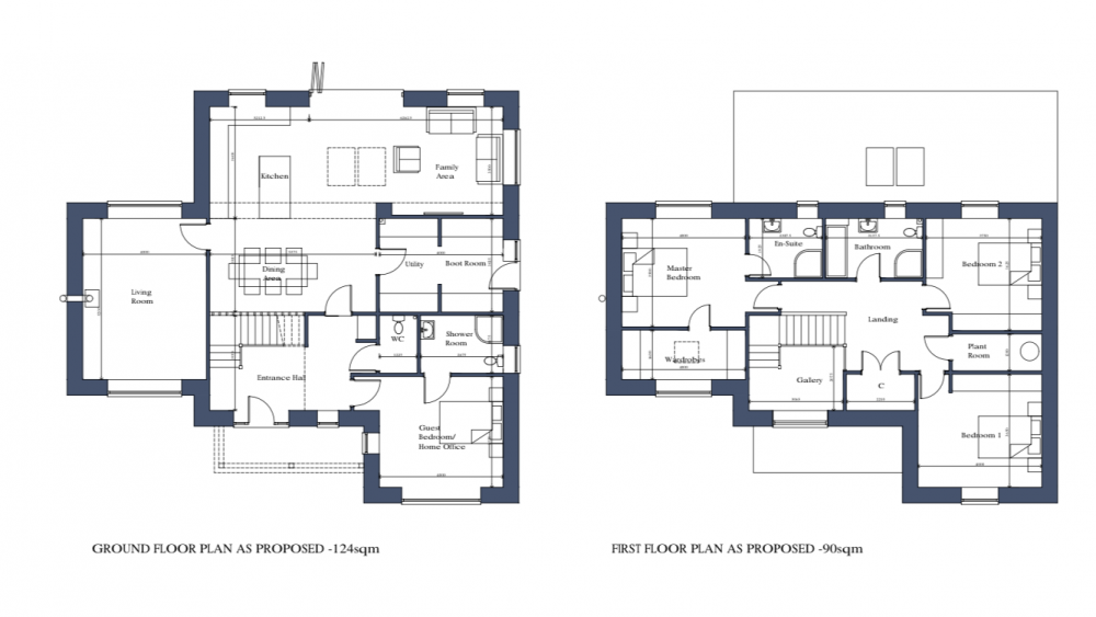

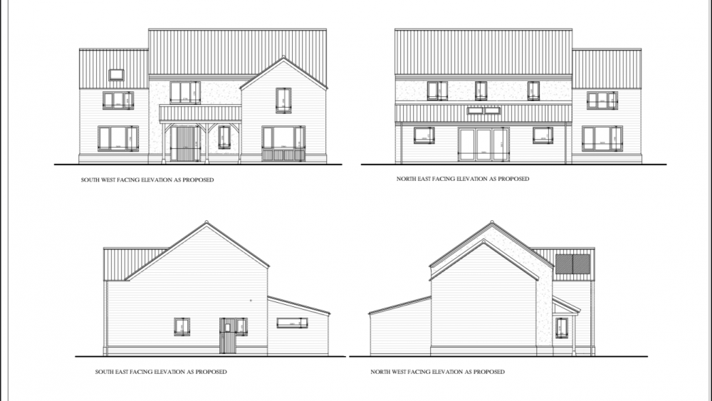

Rishard Posted February 13, 2022 Share Posted February 13, 2022 Having built several extensions and barn conversions, it’s time for my own self build! I’ve been using this site for the last year getting upto speed with similar approaches and practices. I’m through planning and lining up our next few moves. I opted for an ‘almost passive house’ style build with plenty of insulation and reduced thermal bridging details having consulted the green building store during our design process. Having worked and built several projects I’ve seen the varying scale of acceptable build quality in real site practice. Being my own project I’m hoping to achieve near passive standards without the certification process. Our site has a few limitations due to neighbouring houses shading and the classic north facing garden. We are also in a conservation area. All this being said, we have planning. My first question to the forum would be on PHPP. We did plan to model the house but can’t get this done till summer with GBS. I have other architects who could help but at a large cost. I know some people have been happy to progress based on tried and tested detailing ect. Is it worth the spend for piece of mind? Is it too late in the game to make vast changes to our approved planning anyway? Would love to hear peoples views on this phase. One issue I have would be to accurately size our space heating needs without understanding the predicted building performance. Slap me if I’m over thinking so I don’t overspend! Cheers Link to comment Share on other sites More sharing options...
ProDave Posted February 13, 2022 Share Posted February 13, 2022 Hi and welcome There is a heat loss spreadsheet made by @Jeremy Harris on here that many including me have used to model our heating needs and it proved very accurate. This is something you can do yourself. As to actual performance, that is largely down to detailing, it is possible to fit insulation so badly it might as well not be there if you don't care or don't know what you are doing. Where are you building and what construction method? 1 Link to comment Share on other sites More sharing options...
tonyshouse Posted February 13, 2022 Share Posted February 13, 2022 I generally advise a building physics model of the house, this has generally informed additional shading, reducing the size of dangerous west facing glazing. will tell you exact heating demand and how much overheating you will get, I used TAS and paid but a good friend ran the excellent Hot 2000 a Canadian open source programme now hot 3000 I think, will help and both my models informed no formal heating needed, max heat demand for whole house 100W in October, maximum on coldest night etc all very useful Link to comment Share on other sites More sharing options...

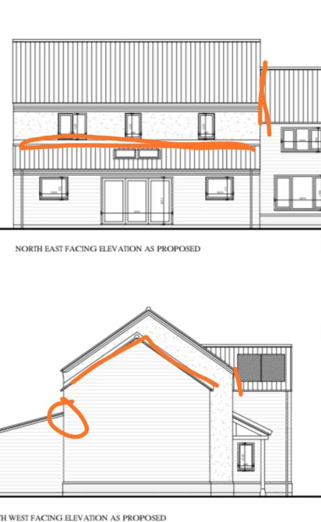

Rishard Posted February 13, 2022 Author Share Posted February 13, 2022 Great, I’ve read about people using this spreadsheet. Is it fairly manageable for a builder? Construction will be. Block, full full cavity, block. There will be a brick plinth detail and a combination of render and cladding. On plan we have 300mm dritherm cavities following the Denny dale approach. Metal web joists, glue lam ridge beams with potentially warm roof vaulted ceilings. Plywood window reveal boxes and triple glazed windows. Dense block for walls with a course of thermal block work at concrete slab and above a steel to carry part of the 1st floor. 1 Link to comment Share on other sites More sharing options...

Gus Potter Posted February 13, 2022 Share Posted February 13, 2022 (edited) What's you gut common sense telling you? If you have lots of west facing glazing then overheating is a significant risk. If you are trying to shave a bit of the capacity of the heating system to deliver / make savings.. then.. if you have kids the doors get opened and left opened! Teenagers tend to open a window to have a fag or throw up out of them after socialising, you may too! Lastly remember that from time to time we may get 15 -20 deg Celcius.. would be a shame if this happened at Xmas when you have all the family round and you can't warm the house up for those who are frail say. Seriously though North light glazing is a cracking concept particularly if you are say a painter..or the like. Edited February 13, 2022 by Gus Potter 1 Link to comment Share on other sites More sharing options...

Rishard Posted February 14, 2022 Author Share Posted February 14, 2022 (edited) @Gus Potter- my gut feeling is to try have it modelled. The main reason being this is my first low energy build. Although I’m confident with the detailing and build-ability of the project I have little understanding what this may look like in terms of its efficiency. Knowing some of the figures would help inform how best is can heat the building. Likewise, I’m not trying to scrimp on having a sensible heating system that can deliver heat when it’s needed. I have small children who will one day be those teenagers you talk of! I have a readily available supply of wood offcuts from my work so did think of a small log burner. I know this may be seen counterintuitive but just a thought. I’ll await other peoples views on this…. We have no west facing glazing due to neighbouring boundaries to west and east. Glazing to both north(garden) and south. Edited February 14, 2022 by Rishard Link to comment Share on other sites More sharing options...
