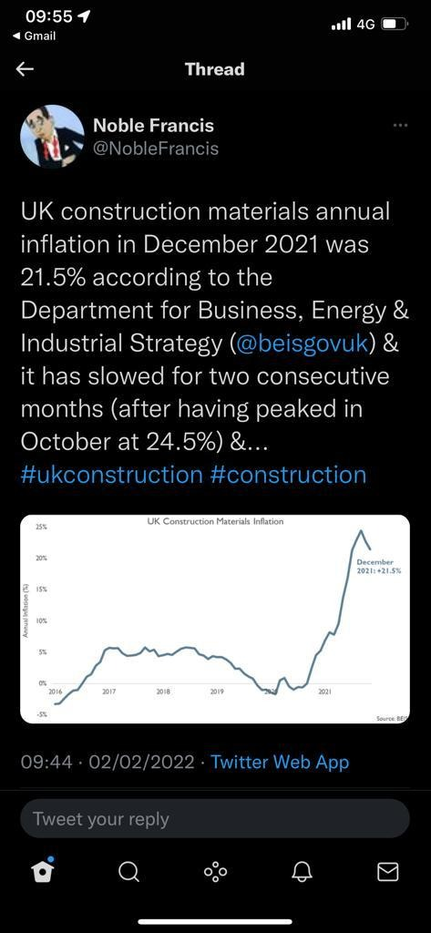

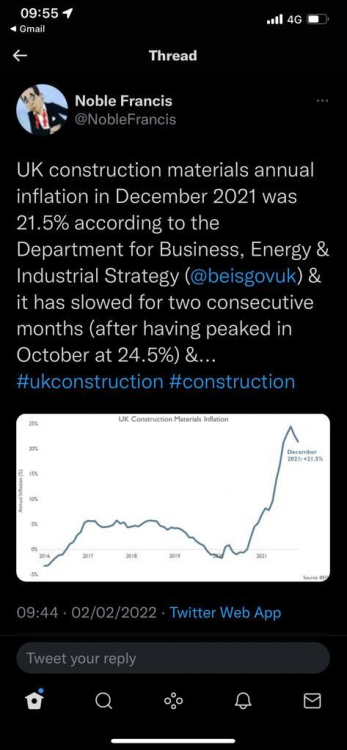

puntloos Posted February 5, 2022 Posted February 5, 2022 (edited) So, we've gracefully exited 2021 now. Was wondering as the title says: How much did build cost estimates go up over 2021? (e.g. tendering 'today' vs tendering 'last year', everything else being equal) And are there any outliers? E.g. "wood went up 300%, while the rest of the prices are only 5% more"? Edited February 5, 2022 by puntloos
nod Posted February 5, 2022 Posted February 5, 2022 I think the labour is about the same Some materials up But others like timber falling quickly
puntloos Posted February 5, 2022 Author Posted February 5, 2022 (edited) 1 hour ago, nod said: I think the labour is about the same Some materials up But others like timber falling quickly One builder told me it has always been that way anyway (pre-covid), material costs vary a ton, but there's always one (group of) things that is unusually high. I'm sure covid raised the 'overall price' by more than you would expect (which is my question - 15% then?), but I think we're behind the big peak. Edited February 5, 2022 by puntloos
puntloos Posted February 5, 2022 Author Posted February 5, 2022 Interesting. And what % of build cost is materials? I imagine 66%? So if build 2020 is 500,000 then that would be 333,333 materials, 166,666 for labour -> build 2021 333,333 * 1.215 = 404,999.595 + 166,666 = 571,665 - that's about 15% Of course there's always some generic inflation etc, but I can probably keep it under 20% then?

puntloos Posted February 6, 2022 Author Posted February 6, 2022 21 hours ago, ProDave said: I find it hard to quantify material rises last year. Most of what I was buying was timber, and it was not just the cost, but for much of the year timber was simply hard to find and it was a case of get whatever I could from whichever merchant had it. No chance to play them off against each other to get the best price when only one of them had it and they knew they were the only one. Interesting point, but is that fact reflected in the BEIS prices that @Dave Jones quoted? It's all well and good if the "sawmills" have increased their prices by 21%, but if this one shop that actually has the wood raises their asking price far beyond that since desperate builders will pay it.. is the real price more like 30% extra? Or is that 21% the effective price after all the theoretical 'gauging' that happens?

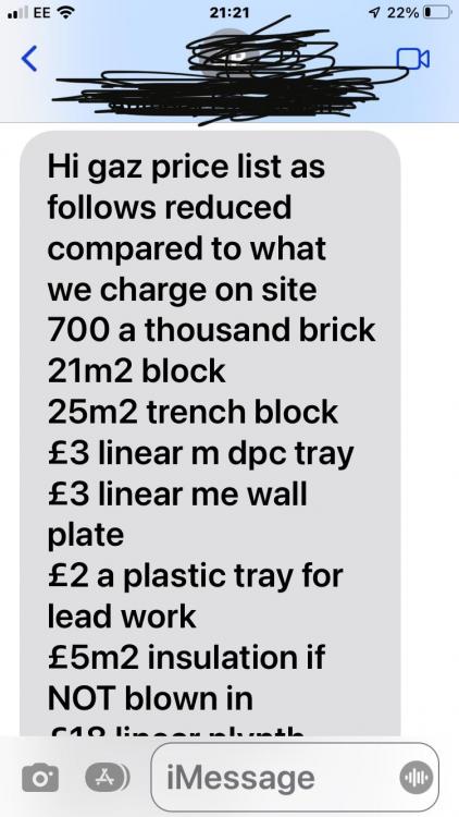

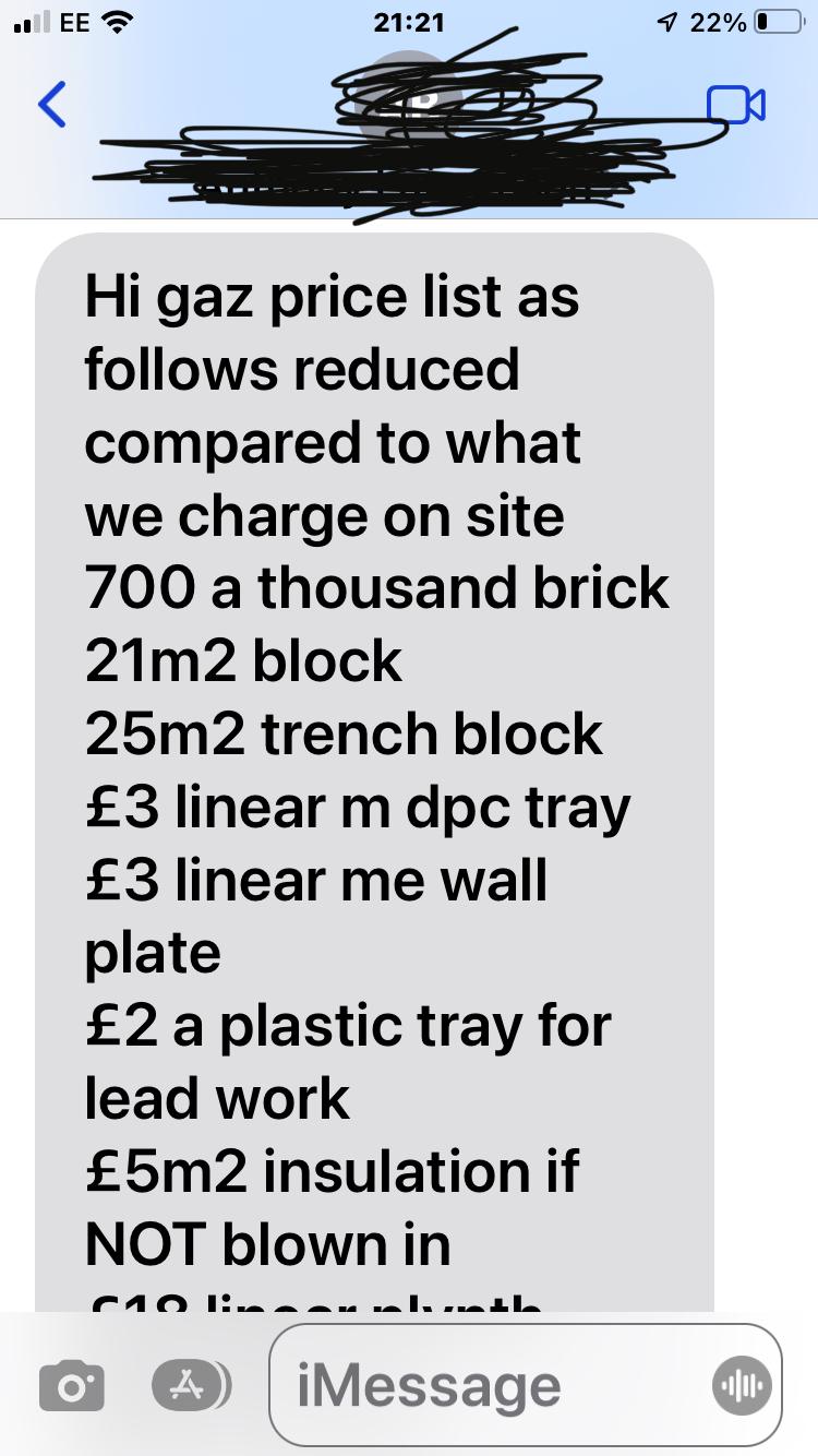

nod Posted May 20, 2022 Posted May 20, 2022 1 hour ago, SuperJohnG said: Fuel prices is just going to drive so much costs now. What a crazy time to be in...brexit...covid....war/ energy cap prices..and so it goes Many many suppliers are milking it 9p a liter difference between two independent garages lintel quite over a grand difference between two quotes same product BB 1400 difference between two quotes both selling Armstrong beams

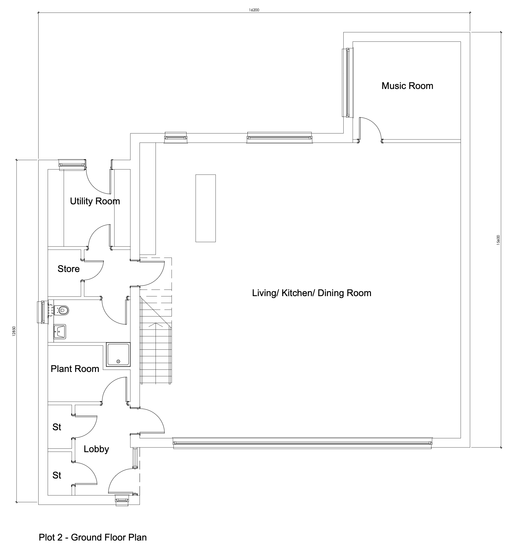

AliG Posted May 21, 2022 Posted May 21, 2022 4 hours ago, ProDave said: So plots there are 10* the cost of plots here, which is insane as built houses are not 10* Houses in this street would go for around £500 a square foot, one of the highest in Edinburgh for houses, and it has permission for a 3700sq ft house. Really weird design though, I'll post the ground floor. It would probably be worth around £1.5m (Value per sq foot falls over 3000sq ft, plus the odd design). It's a 0.22acre plot, same size as my parents' but we only have permission for 2000sq ft and paid half as much three years ago. A house with the same size of plot in the next street was just sold for £715k and they are knocking it down to build around a 2500sq ft house. They have paid way over the odds I think. This would suggest even £800k is doable for the site.
