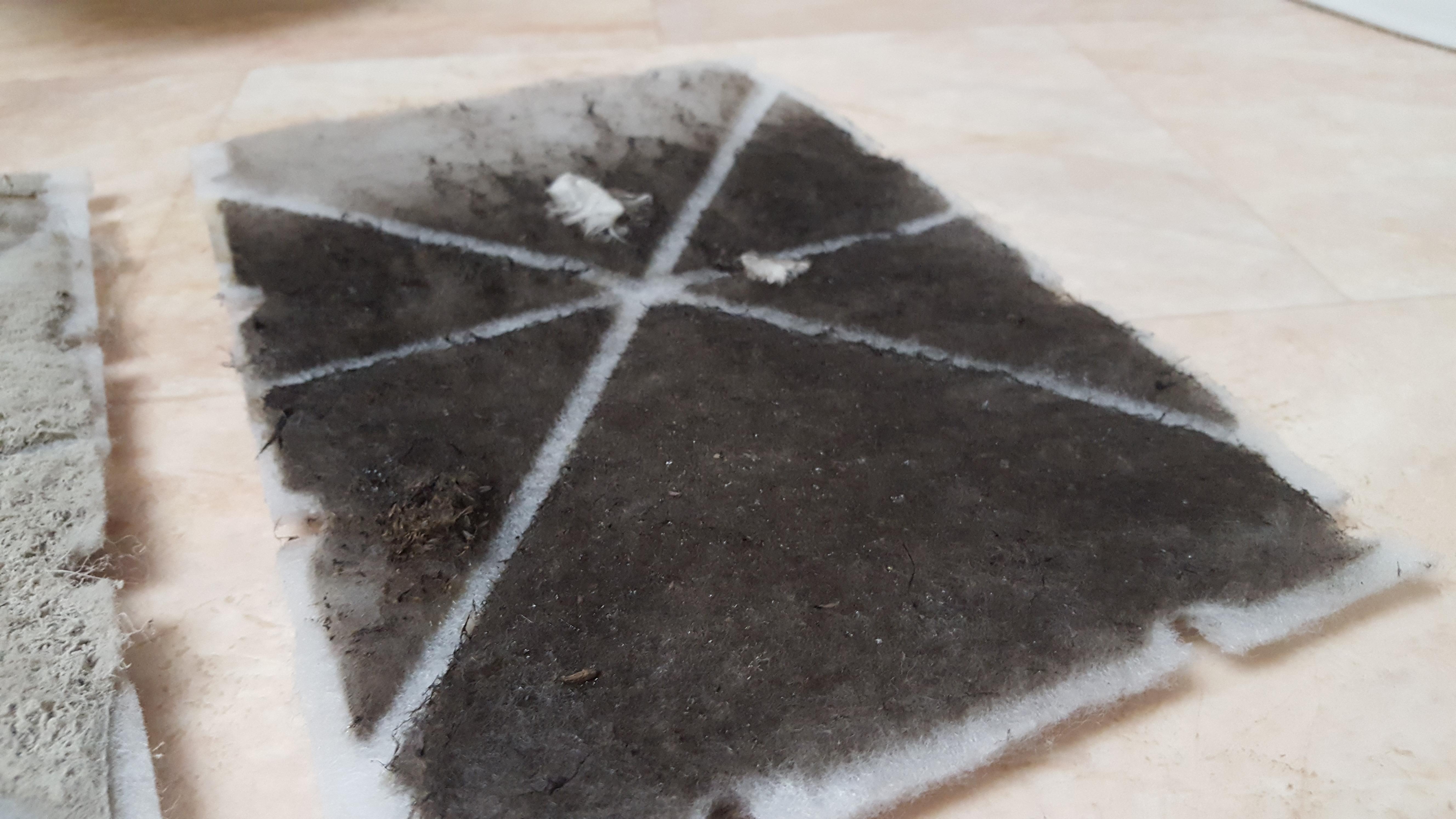

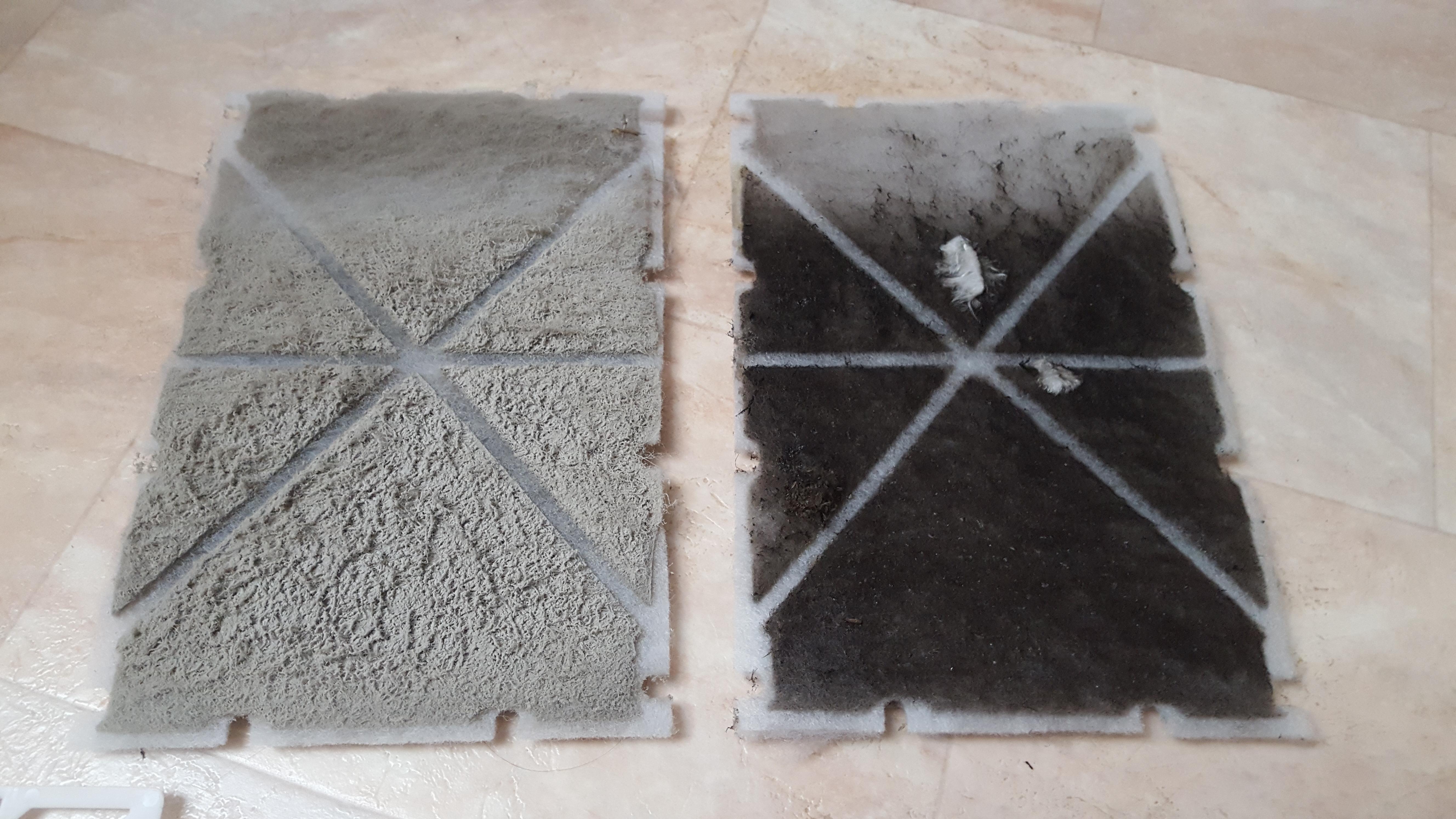

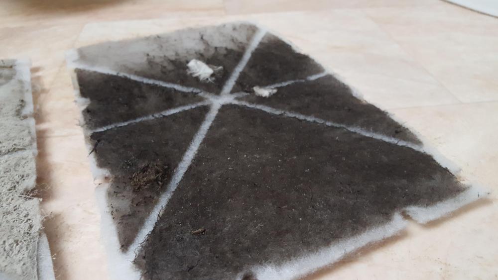

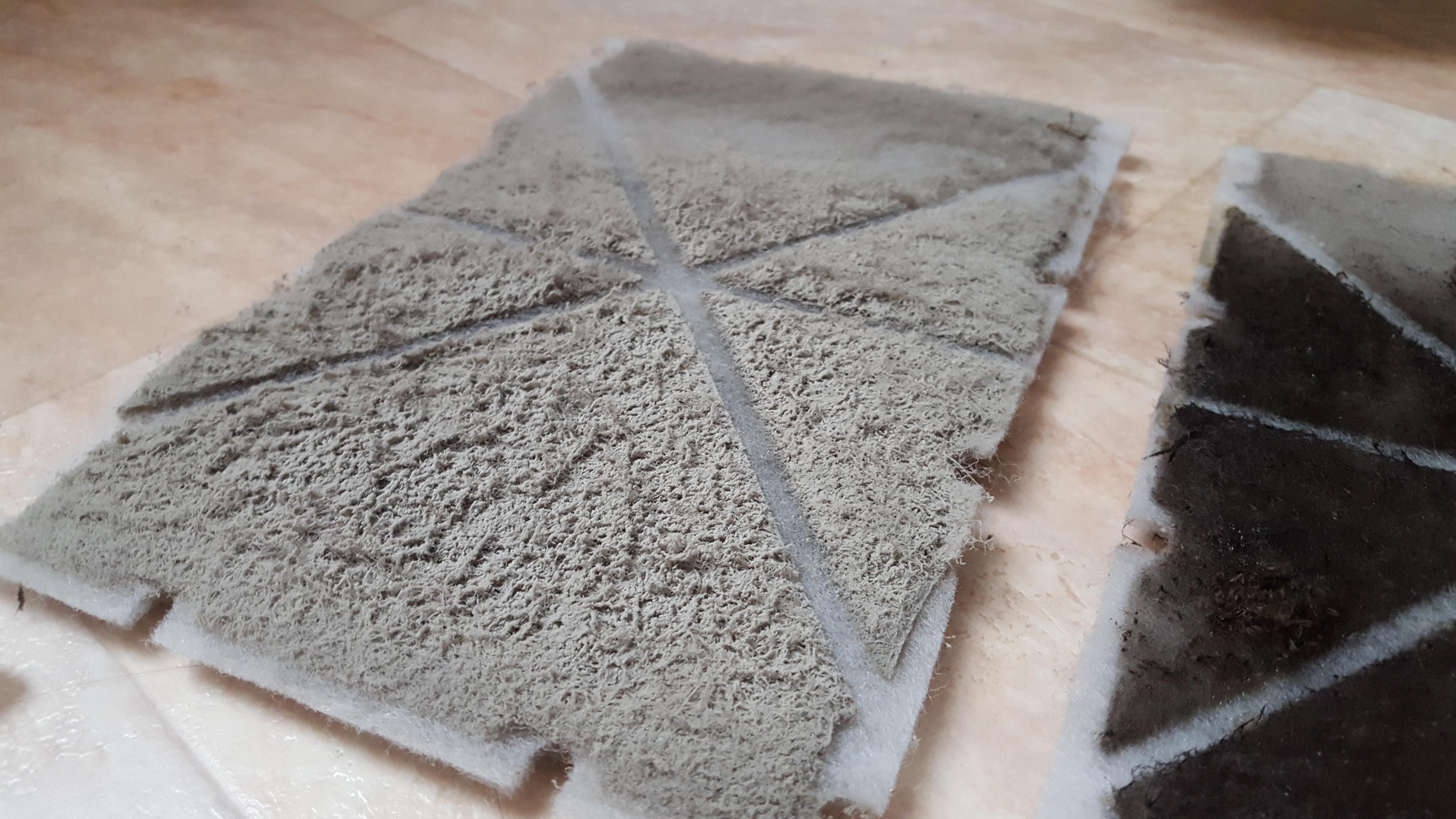

Just to close this off, I bought a square metre of 10mm G3 filter media from Just Fans for £8.34 and this should last me quite some time even if I do decrease the service interval which I think I ought to from the state of the old filters I removed! (L = internal extract, R = external intake)
I can't work out how long my unit has been in, but it could be over a year and I've been doing a fair bit of renovation work inside. I'm going to go with a six month interval now and see how things look then, adjusting depending on what I find (and reminding myself how cheap bulk-bought filter media is).
