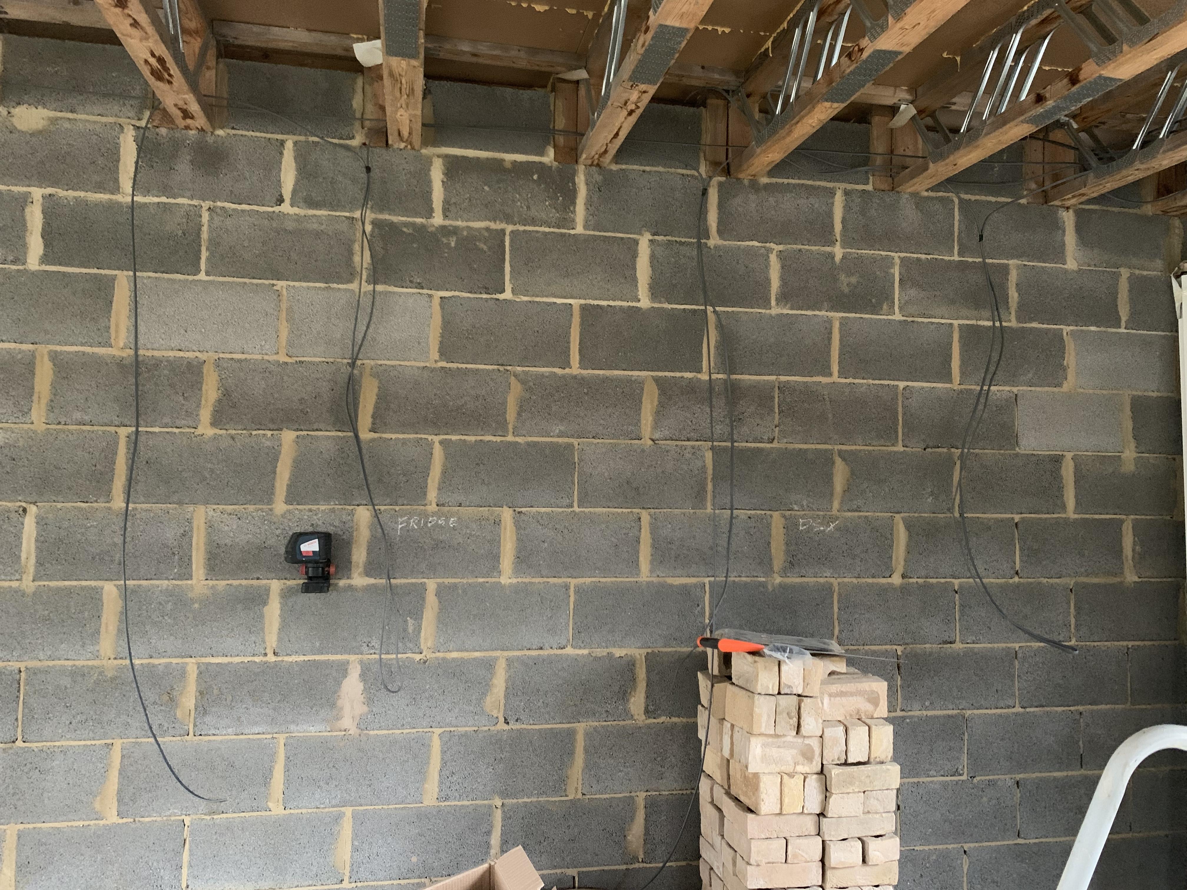

James94 Posted January 23, 2022 Share Posted January 23, 2022 (edited) Are we worrying for no reason? In the middle of having first fix electrics and got to the kitchen and he wants to do a separate radial for ovens and fridge freezer in 2.5mm. He says he’s done the calculations and this is all it requires. the pics show cables hanging In position and similar to what we want ovens like. Edited January 23, 2022 by James94 add pics Link to comment Share on other sites More sharing options...
ProDave Posted January 23, 2022 Share Posted January 23, 2022 Ovens don't actually use that much power, typically 2kW for a single oven. It is hobs that draw much more power. If you feel more comfortable and future proof use 4mm or 6mm for an oven feed, nothing wrong with being too big. Link to comment Share on other sites More sharing options...
James94 Posted January 23, 2022 Author Share Posted January 23, 2022 @ProDave thanks for the quick reply, been looking at the Bosch 8 series steam oven, oven, microwave/ovens, some are total kw 3.3 , 3.6kw Are these type low consumption? I might speak to him Wednesday and ask him to use 4mm, does a radial make any difference to having a ring? having an induction job in island on its own radial in 4mm. regards. James Link to comment Share on other sites More sharing options...
Dan F Posted January 23, 2022 Share Posted January 23, 2022 A lot of the new ones do have pyrolytic cleaning and/or fast heating modes though, and therefore are up to 3.7kW (16A). If you don't know what oven you are getting yet, you should ensure he allows for 16A. I would personally expect, and insist on, 4mm for anything that may be up to 16A. That is what our electrician has used. 1 Link to comment Share on other sites More sharing options...

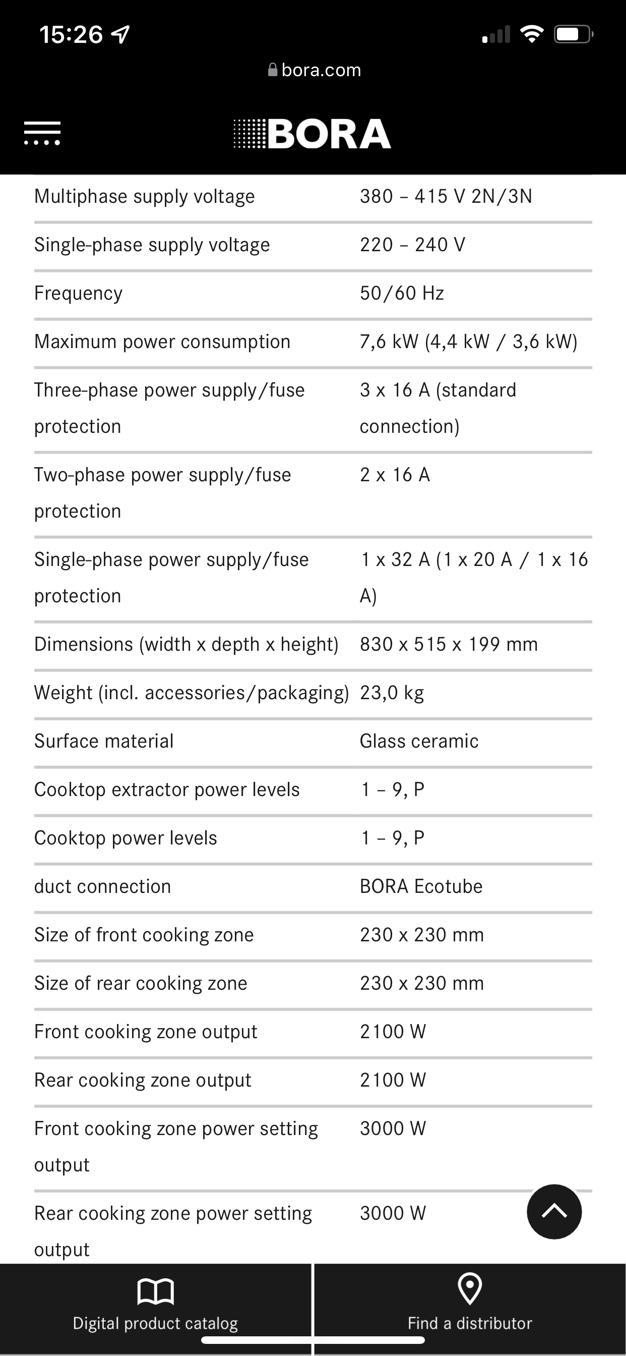

James94 Posted January 24, 2022 Author Share Posted January 24, 2022 Multiphase supply voltage 380 – 415 V 2N/3N Single-phase supply voltage 220 – 240 V Frequency 50/60 Hz Maximum power consumption 7,6 kW (4,4 kW / 3,6 kW) Three-phase power supply/fuse protection 3 x 16 A (standard connection) Two-phase power supply/fuse protection 2 x 16 A Single-phase power supply/fuse protection 1 x 32 A (1 x 20 A / 1 x 16 Don’t understand these figures, our property will be single phase. How many wires will the hob require, at the minute the electrician has laid a 6mm cable.There will be plug sockets in the island too. regards. James Link to comment Share on other sites More sharing options...
Mr Punter Posted January 24, 2022 Share Posted January 24, 2022 9 minutes ago, James94 said: Don’t understand these figures, our property will be single phase. How many wires will the hob require, at the minute the electrician has laid a 6mm cable.There will be plug sockets in the island too. regards. James The 6mm T&E will be fine for this. The Sparky should make the choices on cable sizing, runs, isolation etc. It is his job to know. 1 Link to comment Share on other sites More sharing options...
Luke Salter Posted January 24, 2022 Share Posted January 24, 2022 for the X Pure... its one 32amp supply. 7.6kw. the info you have listed is for the Bora Classic . Link to comment Share on other sites More sharing options...
James94 Posted January 24, 2022 Author Share Posted January 24, 2022 Oh didn’t realise just got details from here, says x pure at top of page. https://www.bora.com/gb/gb/cooktop-extractor-systems/bora-x-pure/product/puxa/ so we will keep the 6mm he’s running to hob and ask him to change the cookers cable to 4mm. he has done all calculations and seem very knowledgeable, I don’t like questioning him but I just thought the cookers wire was to small.I’ll just say I want to future proof. Regards. James Link to comment Share on other sites More sharing options...
PeterW Posted January 24, 2022 Share Posted January 24, 2022 Why upgrade to 4mm for a single oven ..? A 2.5mm cable will handle 23-25A, and a number of the Bosch units come with a fixed lead that is only 1.5mm anyway. Up to 4.5kW then you are in the boundaries of a 20A RCBO, 20A isolator and 2.5mm cable 1 1 Link to comment Share on other sites More sharing options...

Nickfromwales Posted January 26, 2022 Share Posted January 26, 2022 Don’t be surprised if the electrician asks you if want to take over the installation on his behalf!! The guy will be qualified, working to the spec of the fixed equipment and appliances that YOU have give to him, and will have installed what is correct. 2.5mm2 radial to each oven with its own 20a DP switch is absolutely spot on for anything up to the 16a requirements. Converting now to 4mm is just a waste of time and money. On 24/01/2022 at 18:44, Dan F said: I guess our electrician used 4mm because he was considering the 2.5mm 17A minumum rating (?). Now we’re getting silly ?. That’s for adverse installations. Never once have I heard any domestic sparky quote or install to that allowance. Cables for domestic ask for an ambient of 20oC to be used, then possibly grouping factors etc may then affect the outcome, but a good sparky will mitigate that simply with segregation. Stick with the 2.5mm and get yourself off to the pub 1 Link to comment Share on other sites More sharing options...
