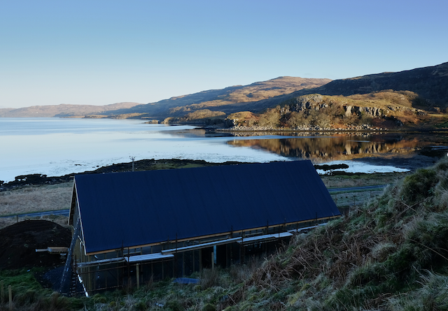

Grian Posted January 22, 2022 Posted January 22, 2022 (edited) I want to establish a small accommodation unit adjacent to my recently completed house in order to create an income stream. It would share water, electricity and septic tank with the house, and would sleep two, with en-suite, wood stove and very basic kitchen facilities. I will need planning permission but would hope that having a small 'moveable' building as per caravan regs I would only need to involve building control in relation to connecting to drainage. My location is perfect and demand for accommodation exceeds supply. An idyllic shepherd's hut or bothy would be just the thing, but my budget does not stretch to the ready made options. I hope it might be possible to have a local builder make one more cheaply... I know someone who is very good and reasonably priced who has said they could be involved. However it would be their first mobile/moveable hut, and I don't have any plans to work from that have been tried and tested, either in terms of layout or construction. Can anyone offer advice please? I really need this project to succeed and am feeling a bit daunted and unsure whether it would be best to take on extra debt and just buy something... I personally have no diy skills, so besides labouring all I can contribute is enthusiasm and tea and cake! Many thanks Edited January 22, 2022 by Grian

ProDave Posted January 22, 2022 Posted January 22, 2022 Take a read of this blog He did it all himself, design and build. That is a build complying with the definition of a "caravan" so only needed building control for the drainage connection. 2
Grian Posted January 22, 2022 Author Posted January 22, 2022 Many thanks @ProDave I'll have a look now.
Grian Posted January 22, 2022 Author Posted January 22, 2022 24 minutes ago, ProDave said: Take a read of this blog He did it all himself, design and build. That is a build complying with the definition of a "caravan" so only needed building control for the drainage connection. It is a beauty, but I am missing how it is made so that it can be removed in no more than two sections? I did only get a couple hours sleep so I may be extra unobservant today!!
ProDave Posted January 22, 2022 Posted January 22, 2022 1 minute ago, Grian said: It is a beauty, but I am missing how it is made so that it can be removed in no more than two sections? I did only get a couple hours sleep so I may be extra unobservant today!! I think the theory is the stilts it sits on are not part of the building. He discussed it with his BC and agreed if you got a big enough crane and a big enough low loader, you could pick the whole thing up in one piece and put it on the low loader. The low loader would never get up the slope and out of the gate but that didn't seem to bother anyone. 1 1
saveasteading Posted January 22, 2022 Posted January 22, 2022 6 minutes ago, ProDave said: if you got a big enough crane Thanks for that link, it is a splendid achievement and an interesting situation re planning. If it lifts with a theoretical crane, is it heavy enough to sit tight in a gale? For that size of building, the steep roof and the void under, there could be a lot of uplift. Not likely to blow away but could move on the plinths. I think I would provide ties down to the footings, just in case. 1

Gus Potter Posted January 22, 2022 Posted January 22, 2022 Hello Grian. You could have great fun with this. I've been lucky enough to have dabled in this on the structures side on and off over the years; light weight cold formed steel / TFstructures, high end man caves etc, it's enjoyable. In terms of proving it is "movable" then if you made the main section no wider than 2.9m then this would fit on the back of a low loader without being classed as an abnormal load as I understand? I wonder if you could also build it with extra modules, like those mobile homes that once parked the sides extend out. This would allow you to detach the side modules. Yes, you would need more trips to shift it you started with two modules that are a similar size to a 40 container you could then add bits to provide an improved layout, less corridor and more living space? In terms of how you build something like this.. it looks like you are near a sea loch. I would explore doing it as a TF. You could do it as metal stud ..dry wall idea or thicker cold formed steel sections both with limited life expectancy but TF is more suited to a local builder, (or say a joiner) and more survivable in a marine type environment as it does not corrode. Also, easier to insulate. You could almost panelise it so rather than transporting the modules you diassemble and transport it flat pack style, like a fully serviced module construction. Ideally you want to see if you can keep some residual value in it in case you later want to flog it (to say a self builder here as temporary accommodation! and do something else.. at least any residual value should cover the cost of getting rid of it or upgrading? I'm not a guru on the caravan regs but as I understand it so long as the structure is capable of being moved from one place to another then you are on the right lines. I don't think it's a massive engineering challenge to do TF modules that you shove lifting beams under and crane onto a low loader. If flat pack then four folk can man handle them on and stack. In terms of structural wind loading with a bit of thought you can design and build a strong TF easily capable of standing up in the wind. The big thing is you need it to be light weight so you can man handle it.. but then it wants to fly away in the wind! Also for simplicity and to keep the cost down you probably want to put a flat roof on it.. which is hard to insulate and ventilate. But.. the roof can be an inverted warm roof. Here you have a roof as follows;.. could be exposed timber on the underside (saves the cost of the ceiling) , then say 18mm marine ply, the water proof layer (say EPDM single ply membrane a pondliner almost), then the insulation and say paving slabs on top. The paving slabs act as the sound proofing so folk don't get woken up with the hail, the rain and birds tramping about on the roof at 5.00 am in the summer. The slabs also help act as ballast to stop the whole thing lifting in the wind and the insulation flying away. When you want to move it you take off the slabs, recycle.. either flog the insulation or recycle. 1
