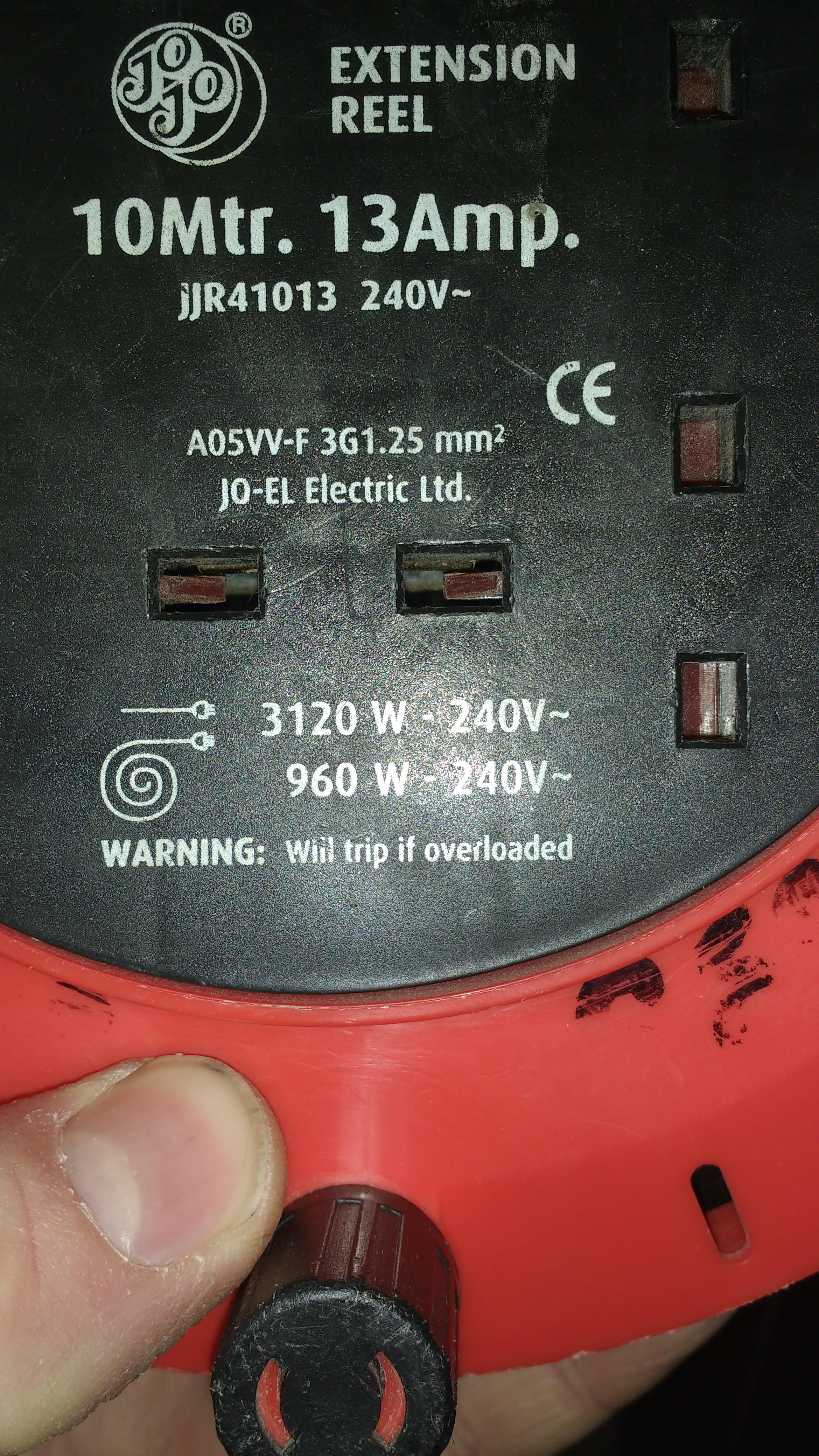

Onoff Posted January 20, 2022 Share Posted January 20, 2022 Should be a label on the lead given the wound and unwound loading. Something like this: Link to comment Share on other sites More sharing options...
