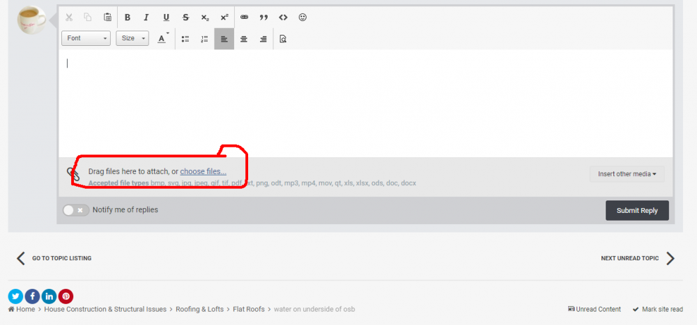

TANK Posted January 17, 2022 Author Posted January 17, 2022 sorry I don't know how to upload photos unless they have to be through a hosting site? it doesn't show a great deal tbf anyway.
TANK Posted January 18, 2022 Author Posted January 18, 2022 when I click choose files to attach it literally does nothing at all.
steveoelliott Posted January 18, 2022 Posted January 18, 2022 3 hours ago, TANK said: when I click choose files to attach it literally does nothing at all. Can you drag the files in?

TANK Posted January 22, 2022 Author Posted January 22, 2022 On 18/01/2022 at 15:01, steveoelliott said: Can you drag the files in? I'm on the mobile site not the pc
