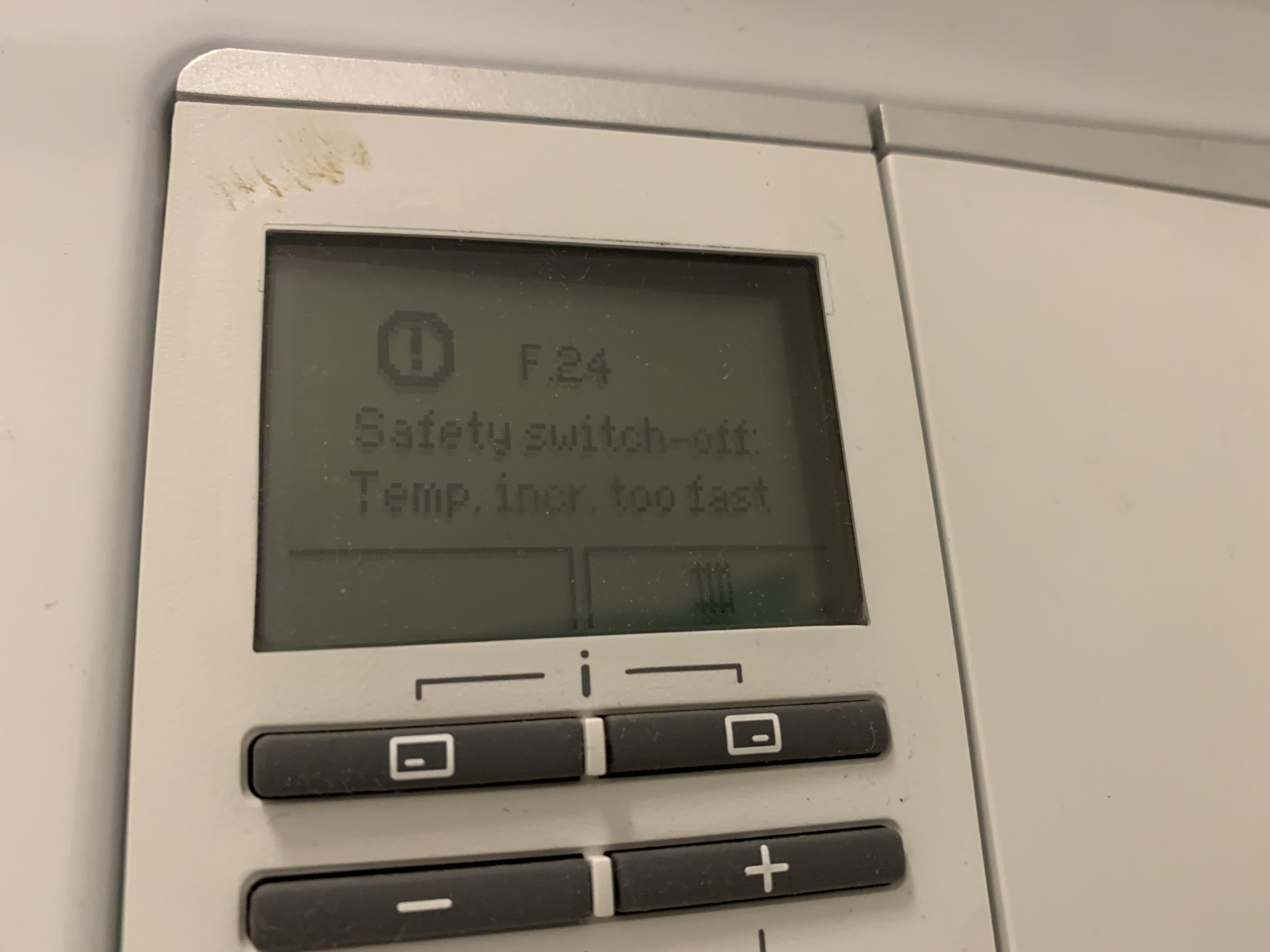

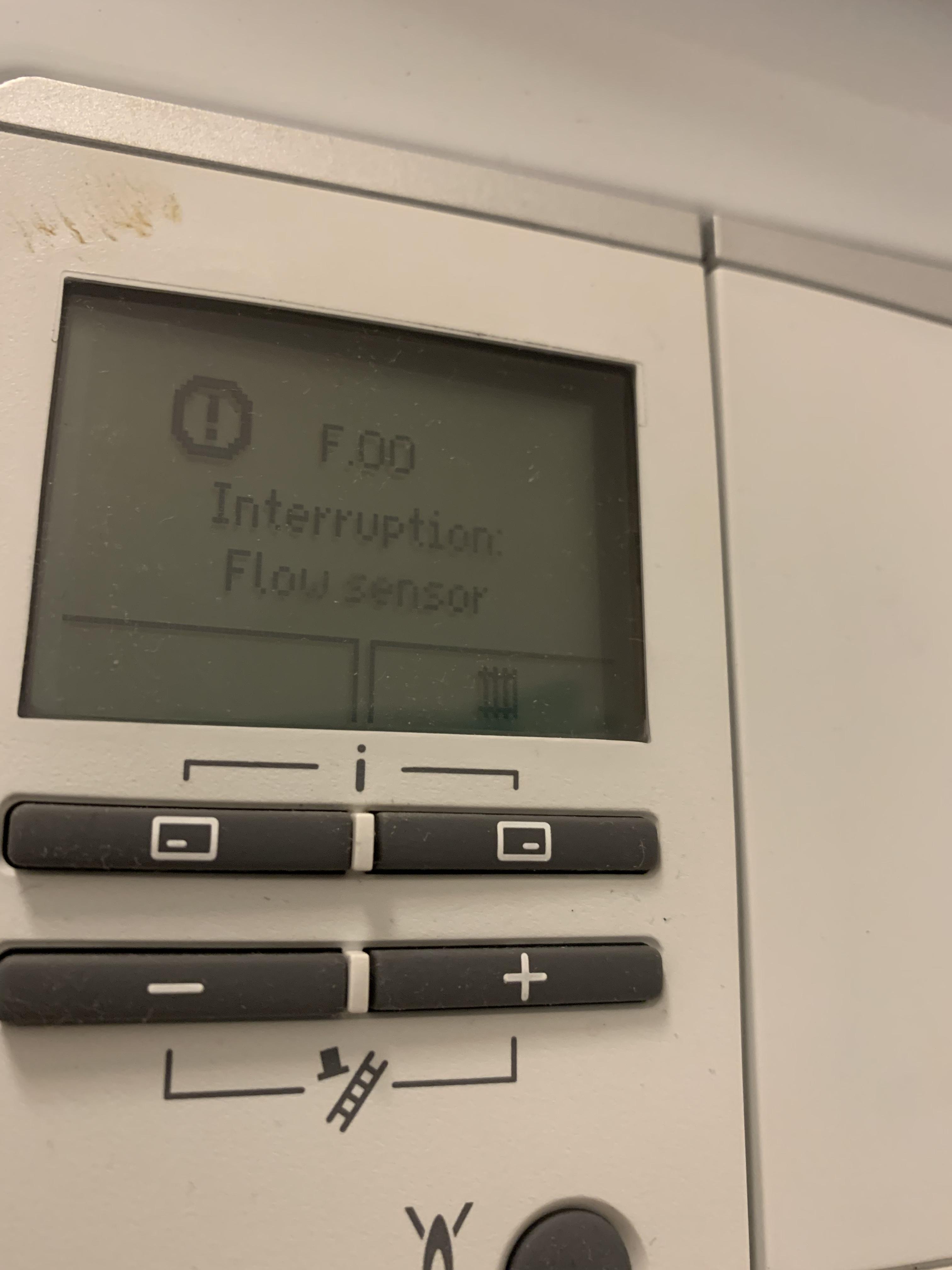

Adsibob Posted January 18, 2022 Author Share Posted January 18, 2022 And it’s broken again. With a new PCB, we can at least see what error it is reporting. It seems to be so excited to have recovered that functionality that it’s reporting two: time to call out the engineer again! What fun it is having a Vaillant. 1 Link to comment Share on other sites More sharing options...
Pocster Posted January 18, 2022 Share Posted January 18, 2022 23 minutes ago, Adsibob said: And it’s broken again. With a new PCB, we can at least see what error it is reporting. It seems to be so excited to have recovered that functionality that it’s reporting two: time to call out the engineer again! What fun it is having a Vaillant. As you say , at least you have errors reported …. A temperamental boiler reporting no error codes is worse . Valiant engineers in my experience of using them for decades are usually pretty good . Link to comment Share on other sites More sharing options...
Radian Posted January 18, 2022 Share Posted January 18, 2022 Probably just needs air bleeding. Must have been drained down to replace divertor valve. Some naughty air still hiding in primary somewhere. Link to comment Share on other sites More sharing options...
MJNewton Posted January 18, 2022 Share Posted January 18, 2022 A Google search suggests that first error might be a loose/disconnected flow temperature sensor. Perhaps that itself might then also cause the second error? Link to comment Share on other sites More sharing options...
