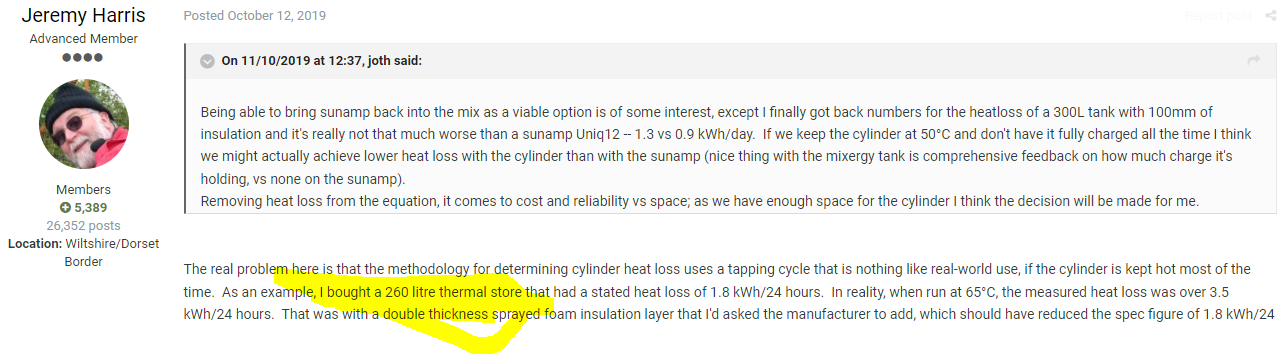

dpmiller Posted January 17, 2022 Share Posted January 17, 2022 13 hours ago, Iceverge said: HOLD PRESS!! No need to reinvent the wheel. Thermal Stores and heat pumps are already a thing. https://www.thenaturalenergycompany.co.uk/shop/index.php?route=product/product&product_id=300 Physiologically I like the idea of not keeping 300l of hot water at 3 bar all day every day in an UVC. Relying on over temp and over pressure valves for safety seems like it's an inherently less safe solution than an open vented Thermal store in the case of run away immersion etc. While the case for solar PV over thermal is well proven the thought of being able to pick up a couple of cheap panels and a pump and rig a drainback system is nice. However I don't know of anyone who uses a thermal store with a heat pump. @Jeremy Harris had issues but I think that was probably because his TS was too small (210l or 250l I think) for an ASHP (needed to be run at high temps for sufficient hot water) and suffered high heat losses in a very low energy demand house leading to overheating. Yep, I'm using a TS on the heatpump, all seems to work well enough. But hang on a mo... That Daikin unit seems *very* familiar. Looks like someone in Germany spent a lot of time :ahem: "inspecting" a Harlequin Heatstream tank... Link to comment Share on other sites More sharing options...

Iceverge Posted January 17, 2022 Share Posted January 17, 2022 It certainly looks similar with connections on the top and a rounded square design. Do you have the Heatstream @dpmiller? My only concern is the headstream would run out of puff very quickly with only 210l. I must admit I like the polyethylene casing and stainless steel coils. It sounds very durable. Unfortunately no solid fuel connection is possible which is one of the big advantages of thermal stores if you like burning stuff. Link to comment Share on other sites More sharing options...
dpmiller Posted January 17, 2022 Share Posted January 17, 2022 @Iceverge no I'd planned around the Heatstream, but multi coil versions were discontinued ( Although RED still use them) and I changed to a bespoke unit from World Heat. Link to comment Share on other sites More sharing options...
