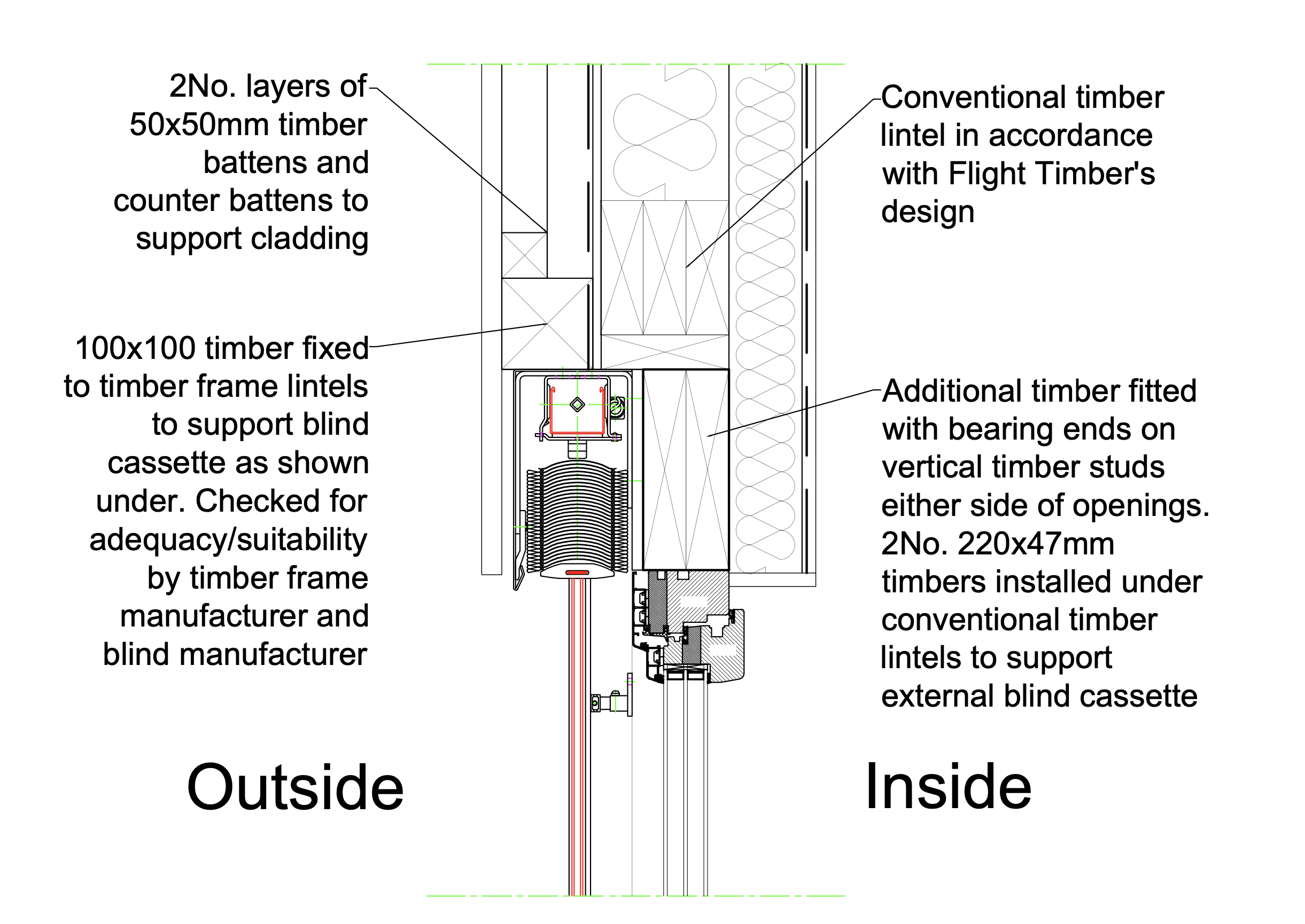

Thorfun Posted January 21, 2022 Share Posted January 21, 2022 this is how ours have been designed to fit. the timber frame company created the window openings wider and taller to accommodate the additional timber above and to the sides and I fitted that after the TF was erected and before the windows were installed. 1 Link to comment Share on other sites More sharing options...

thefoxesmaltings Posted January 22, 2022 Author Share Posted January 22, 2022 On 21/01/2022 at 11:47, Thorfun said: this is how ours have been designed to fit. the timber frame company created the window openings wider and taller to accommodate the additional timber above and to the sides and I fitted that after the TF was erected and before the windows were installed. Really helpful Thorfun, appreciate you sharing this drawing. Any issues with the blinds knocking against the windows and causing noise when it's windy outside? Link to comment Share on other sites More sharing options...
Thorfun Posted January 22, 2022 Share Posted January 22, 2022 35 minutes ago, thefoxesmaltings said: Any issues with the blinds knocking against the windows and causing noise when it's windy outside? I'll let you know when they're installed. ? but they're on vertical rails so I don't expect there to be any issues https://www.warema.com/en/venetian-blinds/basic-external-venetian-blinds.html Link to comment Share on other sites More sharing options...
IanR Posted January 22, 2022 Share Posted January 22, 2022 9 minutes ago, thefoxesmaltings said: Am I understanding the drawings correctly that the blinds are external to the building fabric? Just wondering if you've had any issues with wind causing them to knock against the windows... My installation is external to the wall structure, but within the timber cladding. You can see on Thorfun's install, it's sculpted in to the structure, and more efficient for overall wall width, but requires more of a local compromise on insulation thickness. The cladding details in my previous message were an early study before actual cladding sizes and windows were agreed. The final install did a better job of integrating the side channels and getting a bit more insulation against the frame, behind the cladding. I've never had any issues with the blinds touching the windows. They do get raised if there's a "blust" of wind over 36mph, and up to that speed they're surprisingly robust, even on the 5m spans on some of my larger windows. You can have versions that run on tensioned wires, that span top to bottom, and you can align these to the vertical mullions on the window, but I wanted as little of the blinds noticeable when raised as possible. 1 Link to comment Share on other sites More sharing options...

Dan F Posted January 22, 2022 Share Posted January 22, 2022 (edited) 1 hour ago, thefoxesmaltings said: Really helpful Thorfun, appreciate you sharing this drawing. Any issues with the blinds knocking against the windows and causing noise when it's windy outside? We used roughly the same detail. The timber frame company then supplied the frame with the recess made to measure. We actually made the recess slightly deeper and had the Roma blinds supplied with pre-fitted insulation on the rear of the blinds boxes (to make up for the loss of insulation in the window head). With the insulation in place the blinds are sat slightly further off the font of the windows, not that they would ever touch the window anyway. Our (Roma) blinds came pre-attached to the windows which made things so much easier and ensured that the blind head and length and everything was all supplied to work together ouf of the box. We also used a type of slat called CDL which i) is more stable in the wind ii) does a fairly good job of blacking out internally which is good for bedrooms. I found Roma fantastic: - They have a very comprehensive Kompendium with all technical details, max wind loads and options all explained in detail. - They have ton of options to customize things - They have an online CAD tool to design blinds, visualize in 3D, and then download in AutoCAD format to incorporate in your drawings. Only caveat with Roma is that they don't supply direct to U.K. I don't thnk. Ours were supplied with Gaulhoffer windows, after @Bitpipe did a stellar job of recommeding and demoing them to us ? Edited January 22, 2022 by Dan F 1 Link to comment Share on other sites More sharing options...

thefoxesmaltings Posted January 23, 2022 Author Share Posted January 23, 2022 16 hours ago, IanR said: My installation is external to the wall structure, but within the timber cladding. You can see on Thorfun's install, it's sculpted in to the structure, and more efficient for overall wall width, but requires more of a local compromise on insulation thickness. The cladding details in my previous message were an early study before actual cladding sizes and windows were agreed. The final install did a better job of integrating the side channels and getting a bit more insulation against the frame, behind the cladding. I've never had any issues with the blinds touching the windows. They do get raised if there's a "blust" of wind over 36mph, and up to that speed they're surprisingly robust, even on the 5m spans on some of my larger windows. You can have versions that run on tensioned wires, that span top to bottom, and you can align these to the vertical mullions on the window, but I wanted as little of the blinds noticeable when raised as possible. Really helpful and good to know about the robustness of the blinds. Will check out Hunter Douglas and I'll certainly have a discussion and run this past our architect. Thank you for the additional photos. Link to comment Share on other sites More sharing options...
thefoxesmaltings Posted January 23, 2022 Author Share Posted January 23, 2022 16 hours ago, Dan F said: We used roughly the same detail. The timber frame company then supplied the frame with the recess made to measure. We actually made the recess slightly deeper and had the Roma blinds supplied with pre-fitted insulation on the rear of the blinds boxes (to make up for the loss of insulation in the window head). With the insulation in place the blinds are sat slightly further off the font of the windows, not that they would ever touch the window anyway. Our (Roma) blinds came pre-attached to the windows which made things so much easier and ensured that the blind head and length and everything was all supplied to work together ouf of the box. We also used a type of slat called CDL which i) is more stable in the wind ii) does a fairly good job of blacking out internally which is good for bedrooms. I found Roma fantastic: - They have a very comprehensive Kompendium with all technical details, max wind loads and options all explained in detail. - They have ton of options to customize things - They have an online CAD tool to design blinds, visualize in 3D, and then download in AutoCAD format to incorporate in your drawings. Only caveat with Roma is that they don't supply direct to U.K. I don't thnk. Ours were supplied with Gaulhoffer windows, after @Bitpipe did a stellar job of recommeding and demoing them to us ? Thanks for the detailed info Dan, will take a look at Roma/Gaulhoffer to see if they can put a package together for us. One less contracter to deal with if it can be done all-in-one. Link to comment Share on other sites More sharing options...
