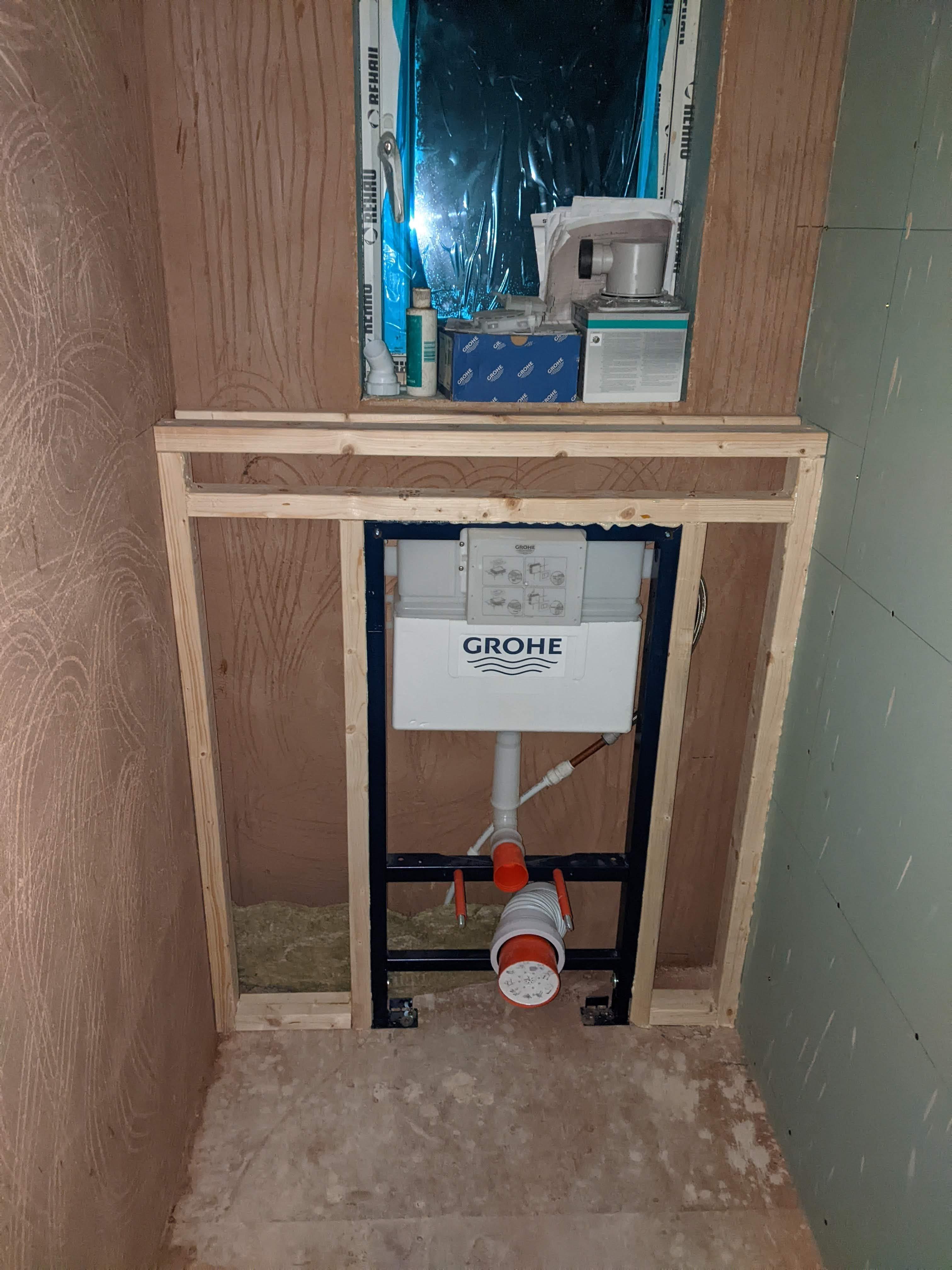

Porthole Posted January 8, 2022 Posted January 8, 2022 Hi Be grateful if you could tell me whether or not a flexible toilet waste pipe is ok to use? The builders have put one in as the hole in the wall is not aligned to the centre of where the loo will be. I just wondered if the inside of the pipe is also corrigated and if this will be quite hard to clean or even smell if toilet waste is caught up in the grooves? Sorry it sounds disgusting but I need to know before they cover it all up! Many thanks!!
ProDave Posted January 8, 2022 Posted January 8, 2022 I would say no in that case. Does the frame not come with a pipe fitted in the exact correct place? most seem to. 2
Porthole Posted January 8, 2022 Author Posted January 8, 2022 Thanks Dave - when you say No - do you mean it shouldn't be used? There is no soil pipe which comes with the frame itself.
MikeSharp01 Posted January 8, 2022 Posted January 8, 2022 You should be fine, its right up against the bowl so easy to clear if it does block but also these are designed to go in these situations - it looks like your incoming pipe does not line up with the frame center so unless you get a multiangle join, which have their own problems or create a offset joiner in solvent weld a flexi pipe is all you have really.
ToughButterCup Posted January 8, 2022 Posted January 8, 2022 (edited) 1 hour ago, Porthole said: Hi Be grateful if you could tell me whether or not a flexible toilet waste pipe is ok to use?... Yes. Provided that it is installed within the guidelines provided by the manufacturer. I had the exact same problem, and it has been solved in the exact same way. Installed by a reputable plumber with me in the room at the same time. I've thrown the guidelines away, so I can't be sure to remember the details - but I do remember one thing : we have to avoid using a rotary rodding system. So, once a week, a drop of dilute bleach, loo seat cover always down, objects that could by accident easily fall in, stored elsewhere. Edited January 8, 2022 by ToughButterCup
nod Posted January 8, 2022 Posted January 8, 2022 1 hour ago, ProDave said: I would say no in that case. Does the frame not come with a pipe fitted in the exact correct place? most seem to. Plus 1 Use the bend that came with the frame
MikeSharp01 Posted January 8, 2022 Posted January 8, 2022 1 hour ago, nod said: Use the bend that came with the frame Not sure they can. Looks like the holes don't line up so would need a carefully constructed solvent weld assembly to achieve same shape and not sure if connection in wall is accessible.
Ferdinand Posted January 8, 2022 Posted January 8, 2022 Like curry; beware of logs. (I'd say yes you will be OK.)
Porthole Posted January 8, 2022 Author Posted January 8, 2022 Thank you all - much appreciated. Seems a bit wierd putting this in, but looks like it is workable and no other options. Does anyone know if it is corrugated inside or a smooth finish? (Just makes me feel better from hygiene point of view if smooth!)
saveasteading Posted January 8, 2022 Posted January 8, 2022 You are there, so why not get your hand in the pipe and see what the inside is like? These are really for problem solving, not new work, but perhaps your drain was already there.
Porthole Posted January 9, 2022 Author Posted January 9, 2022 THank you for your reply, There is a cover in front of the pipe but I guess I can get inside if it is taken off. Yes drain was already there so saved coring another hole in the wall.
Nickfromwales Posted January 10, 2022 Posted January 10, 2022 I've been fitting bathrooms for over 25 years, and have used the flexible soil > pan connectors many many times without ever having a single recorded issue. The velocity of the flush is more than ample to see the bi-products of lunch exiting at enough pace to be washed away / over the riffles of the internal corrugations, and as there is a water trap in the bottom of the pan, there specifically to isolate the stench in the soil pipe, hygiene or smell etc will never be a concern. I've removed WC's where these types of connectors have been installed, and whilst there is 'evidence' of what has been travelling through them over the years, I have never ever seen one that has made me think the aforementioned'items' have been hanging around. The supplied pan connector that these guys have abandoned would typically leave a fixed socket for the pan to push back on to. As there is now a flexi in its place you ( they ) will have to pull the flexi out to install it onto the pan, immediately before pushing the pan back onto the bolts and fixed flush water pipe socket. That is the only annoyance when doing this, and you ( they ) need to 100% sure the flexi is firmly pushed onto the WC outlet. I do not use any silicone lubricant when doing it this way so the rubber grips very well. A bit of soapy water helps if it's a struggle, and washed away to leave the rubber friction fix as good as is possible. Express to the fitters tat you wish to know the flexi pan connector has not been installed with such lubricant, as that will stay slippery for a very long time and can proote the connector coming off over time / many flushes. 1

Mike Posted January 10, 2022 Posted January 10, 2022 (edited) Agree that it's not a problem. I'd be much more concerned by the use of the flexible connector on the cistern water supply. They are quick, easy and widely used, but tend to degrade with time: Faulty hoses dampening Australian households Edited January 10, 2022 by Mike
Carrerahill Posted January 10, 2022 Posted January 10, 2022 (edited) On 08/01/2022 at 10:01, Porthole said: Hi Be grateful if you could tell me whether or not a flexible toilet waste pipe is ok to use? The builders have put one in as the hole in the wall is not aligned to the centre of where the loo will be. I just wondered if the inside of the pipe is also corrigated and if this will be quite hard to clean or even smell if toilet waste is caught up in the grooves? Sorry it sounds disgusting but I need to know before they cover it all up! Many thanks!! More or less every toilet in the land is connected with a piece of this - they are sold as flexible pan connectors, ideally it would have been dead straight but these flexible pipes are to allow flexible fitting like this, even in a bang on install I would expect a piece of flexi to go from the soil pipe to the pan. When I took our old toilet pipe out the flexi was remarkably clean, what you think of as solid doesn't' remain solid for long... Edited January 10, 2022 by Carrerahill
