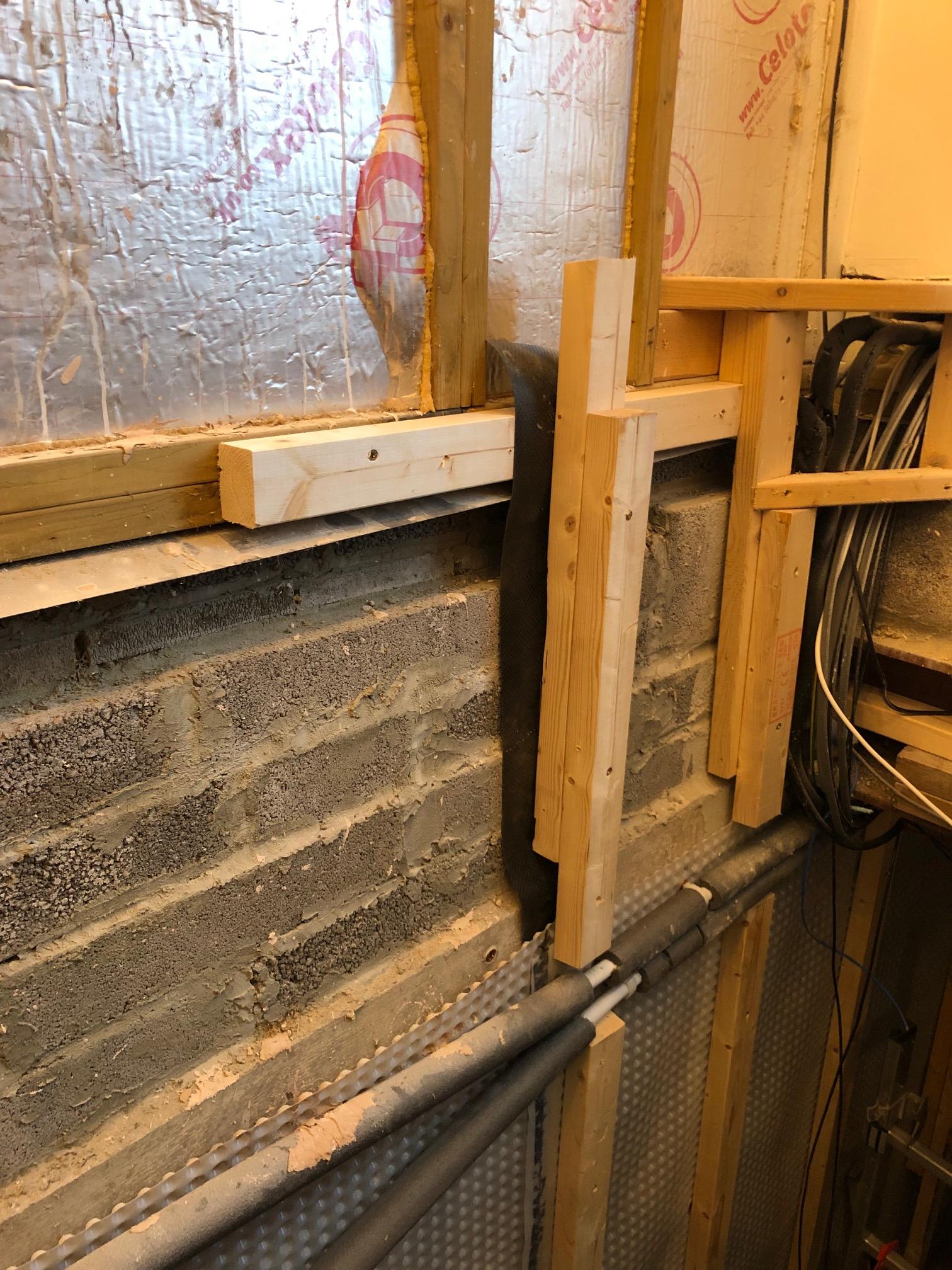

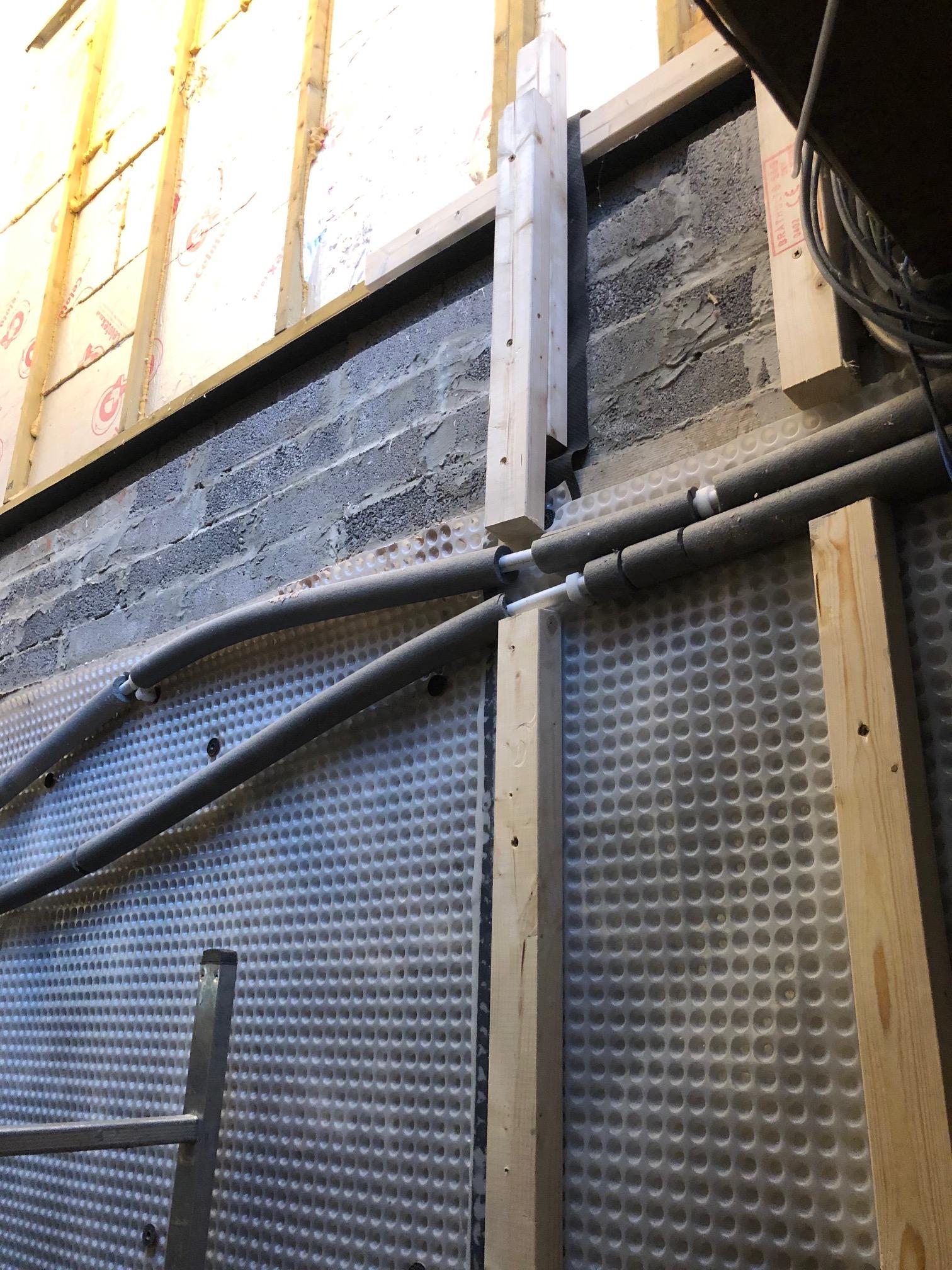

Pocster Posted January 5, 2022 Posted January 5, 2022 SWMBO wanted this and I've considered the amount of pain ; financial and time wise. Needless to say I lost the battle! The wall in question is approx 7m high and 4m wide. I have to bridge different wall 'levels' i.e. not level. As you can see below ground ( stud against walled waterproof membrane ) I'm ok. As I get higher the upper house timber frame gets further away from me!! I can bridge to it - but I'm worried that's a lot of weight hanging off timber -> timber -> timber ( the frame! ). I *could* put a horrible ledge step in it just to get over the issue - but that will just collect dust and probably ( once the staircase is in ) be unreachable. Should i worry about the weight?. Gone for 12.5mm tile backboard to support the beast. (expletive deleted) @Onoff and his bits of flints glued in a box - this is where it's at ! ?
PeterW Posted January 5, 2022 Posted January 5, 2022 I would just put a 4x2 framework over the top of all of that and where possible screw it to the existing framework plus the wall using frame cramps to allow you to plumb it perfectly. Then glue and screw the boards to the framework, and then tile it. That won’t go anywhere and will give you the chance to run any other additional services before you board out and it will cover up a multitude of sins…
Pocster Posted January 5, 2022 Author Posted January 5, 2022 39 minutes ago, PeterW said: I would just put a 4x2 framework over the top of all of that and where possible screw it to the existing framework plus the wall using frame cramps to allow you to plumb it perfectly. Then glue and screw the boards to the framework, and then tile it. That won’t go anywhere and will give you the chance to run any other additional services before you board out and it will cover up a multitude of sins… Frame cramps? - allow ME to do it perfectly?? No additional services to cover up - but a multitude of sins for sure. I'm still worried about a lumpy frame effectively 'hanging' off the timber frame. The more I think the more I worry. The upper part (timber frame of the build ) I could just screw the tile backer board straight too (with a few extra noggins) nice and easy. Still tempted by a lip/ledge to avoid 2 ton's of material falling and killing SWMBO....wait a minute...... 1
Pocster Posted January 5, 2022 Author Posted January 5, 2022 44 minutes ago, PeterW said: frame cramps Are you suggesting the timber frame higher up is effectively hanging off L shaped frame cramps?. So the tile backer frame is sat with a gap ( because of the cramps) in front the other frame ???

Pocster Posted January 5, 2022 Author Posted January 5, 2022 I think I know what I will do / attempt. Top part ( timber frame ) 3x2 running horizontal 30cm apart. Then the backer board can attach direct to those ( backer is 120cm x 60cm ); so just noggins at the ends. Lower part just do whatever I want and then just 'ledge' to upper part to suit.

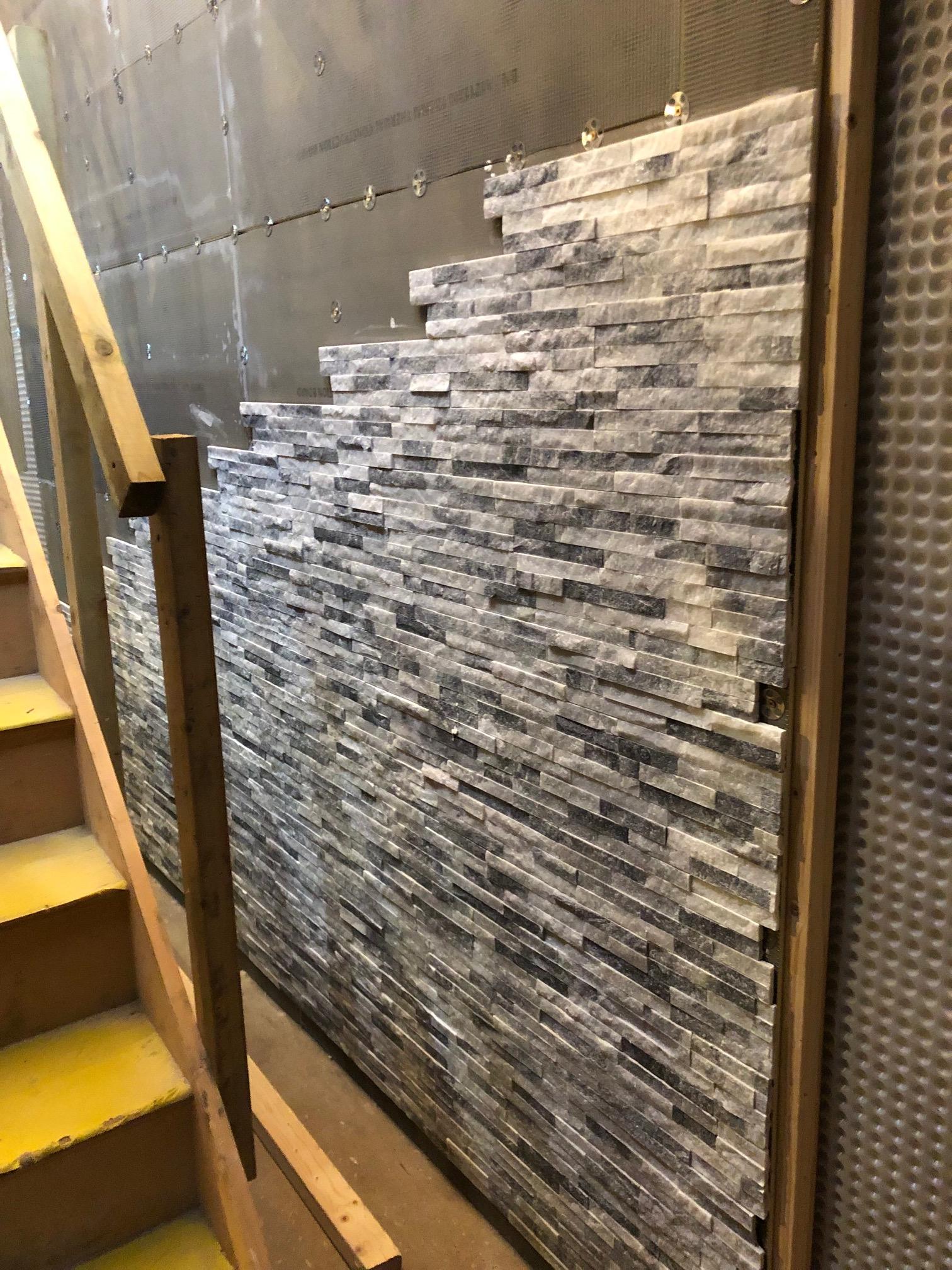

Pocster Posted January 23, 2022 Author Posted January 23, 2022 Started on this beast. 1500 tiles of pain. But starting to look like some wall from Game of Thrones " You Shall not pass!!" 2
