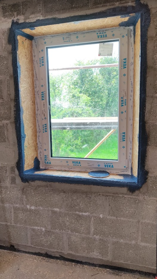

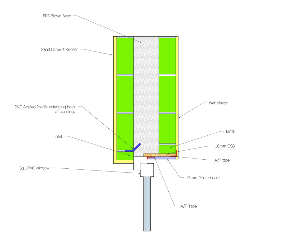

27 minutes ago, matthyde83 said:
Tape window/door frames to ply box, boxes to wall
I did this. Used 18mm OSB. Worked fine. Airtight paint + airtight sealant to connect to walls that had been parged. Tape might have been easier. We followed the Golcar window positioning. It's much easier to build.

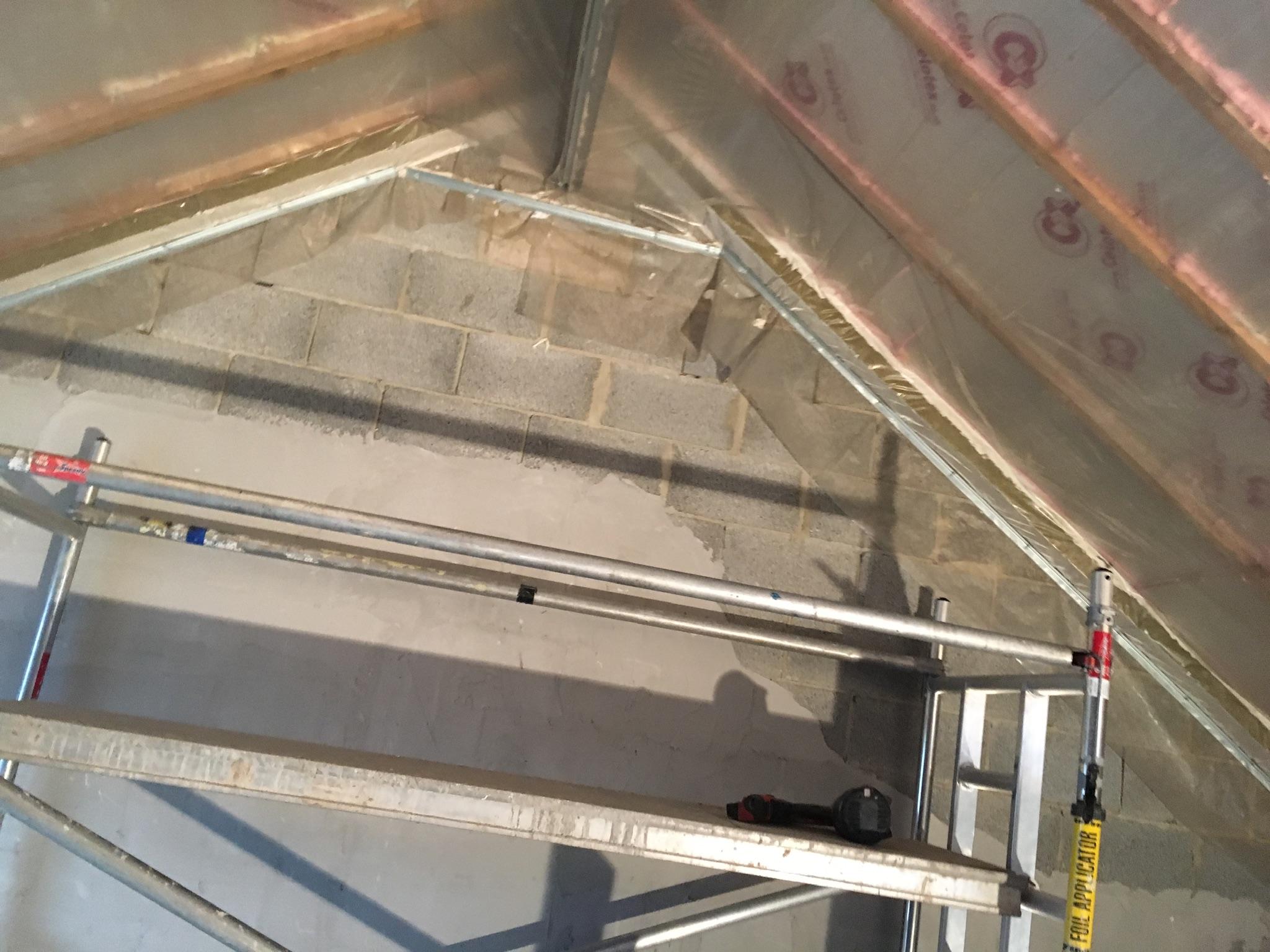

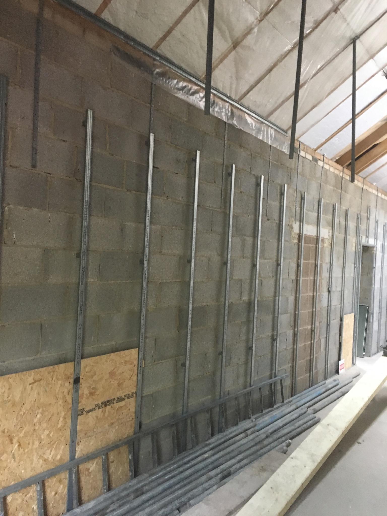

29 minutes ago, matthyde83 said:
Membrane before boarding ceiling on 2nd floor (1st floor also?), taped to wall
Membrane to bottom of trusses. 88mm service cavity for MVHR and wiring on 2nd ceiling, then plasterbaord. It's tricky to detail around the back of conduits from the wall chases into the service void.  Here's what I came up with. It made it easy for the membane to be cut back and not interfere with the chase.

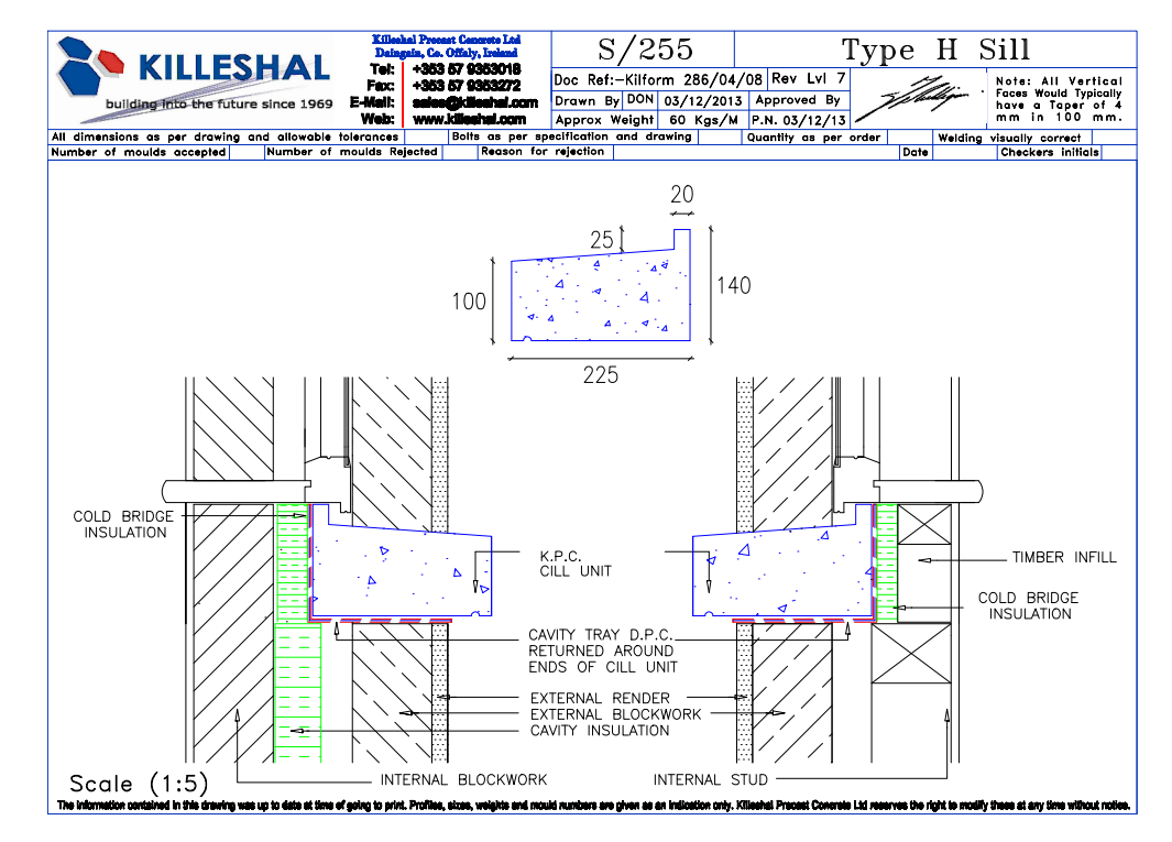

5 hours ago, matthyde83 said:

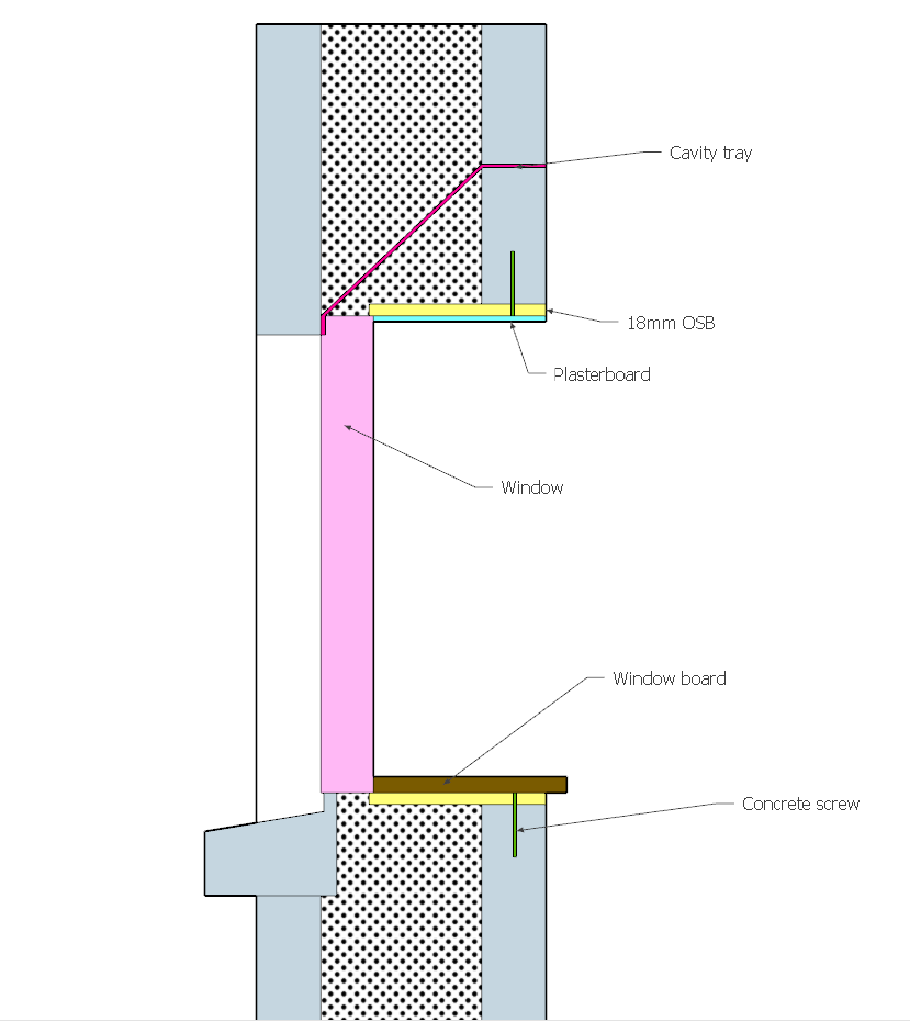

What’s the outside detailing on the windows?  I’d be worried about OSB being exposed? Also how do you seal cavity behind osb for damp and fire? What’s Golcar window positioning?
https://www.greenbuildingstore.co.uk/golcar-passivhaus-windows-doors/ this shows the Golcar project.
Our windows were supported underneath buy the concrete window sill built into the outer leaf and bolted to the outer leaf with angle brackets.  We used these sills which have a thin upstand.
The OSB is overlapping the windows by about 5mm and concrete screwed to the inner leaf. It requires care by the bricky to set back the sill and header the right amount although nothing would stop you building too big and packing it out. The window was installed first. Then the OSB sill and head and finally the reveals. All had to be cut to measure. It was slow, but once screwed in place with brackets was quite rigid. We drilled the OSB to pump eps beads into the area below the cavity tray and under the sill.
As you can see the OSB is still about 50mm back from the outer leaf so doesn't get damp and allows the EPS beads to press against the edge of the window.
There is an alternative and maybe easier to build method here but I preferred the use of OSB to membranes for robustness
https://www.edmondodonoghue.com/build-it-better-window-door-detailing/
Re damp and fire. As I understand it the issue with fire is from the inside the house into the cavity. The plasterboard and skim take care of this. Mineral wool batts are better than EPS beads for fire.
Regarding damp I'm surprised there's not more leaks with plastic dpc used as cavity trays. It's so vulnerable to being damaged during building. In fact,  I would build an angled PVC profile only half way across the cavity into the outer leaf  if doing it again and dispense with the full cavity tray. I sealed the windows to the outer blockwork reveal with airtight sealant and carefully(ish) airtightpainted the PVC windows to the outer blockwork reveals. This was mainly to keep the cavity windtight but has a dual purpose of sealing the window to the outer render in a fashion that won't crack and let water blow in.
I think I’m following the ceiling detail.  So you are sealing bottom of trusses then creating a void for services, avoiding needing to take them through the seal?  So why the OSB?  How do you create the void dropping the ceiling that far?
Yes and put 44x44mm battens x 2 to create an 88mm service cavity.
imageproxy.php?img=&key=f5f06bfe2c42e69c
imageproxy.php?img=&key=f5f06bfe2c42e69cimageproxy.php?img=&key=f5f06bfe2c42e69c
It was a good bit of work but I didn't want to penetrate the ceiling membrane. With the benefit of hindsight, as I did the MVHR myself I would trust myself to seal around the ducting and plenums if it was done in the attic and use a 22mm service void with 22x75mm strapping for the electrician.

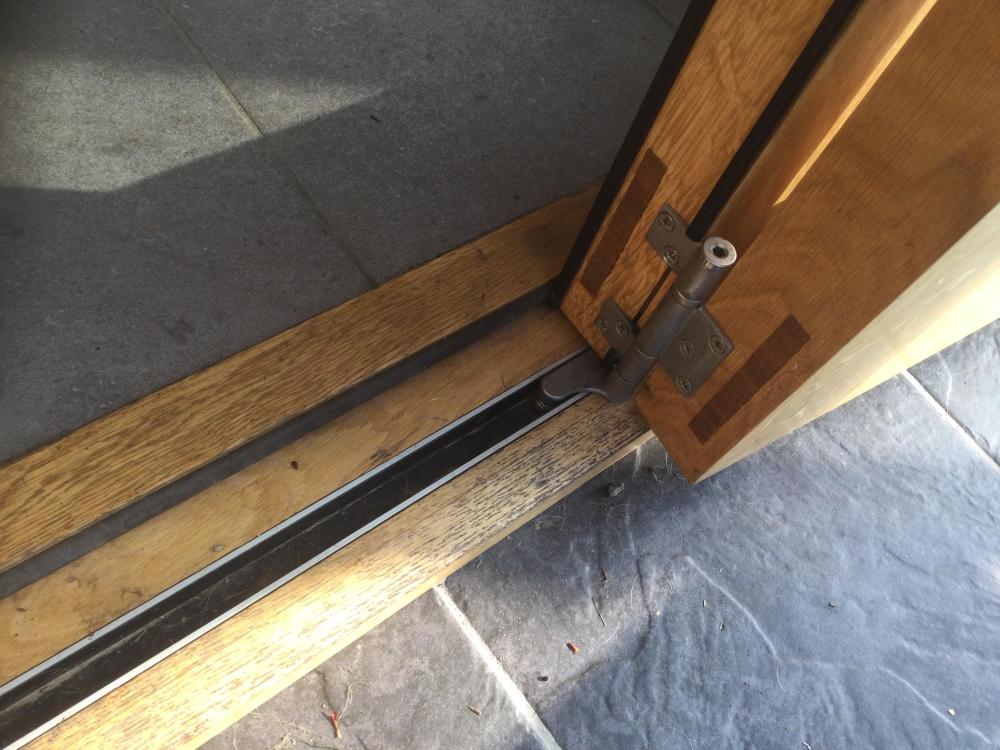

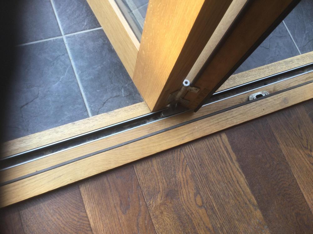

Greenbuildingstore's threshold is as good as any. I bought GRP grating. I did a post on this somewhere recently.
Bifolds. "Sucks through teeth..........."
It can be done. Greenbuildings store achieved 0.18ACH with https://lacunaofdenmark.com/en/lacuna-folding-doors/ . I imagine they're pricey however.
However MOST of them are tragic. if you can live with french doors or tilt and sliders instead it'll be much much cheaper and perform better.  Sliding or brush seals belong in the bin. Compression seals X 3 for every opening.

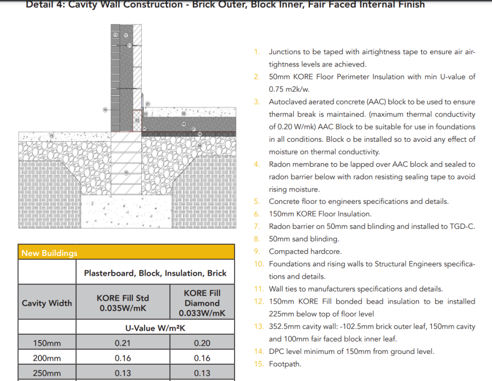

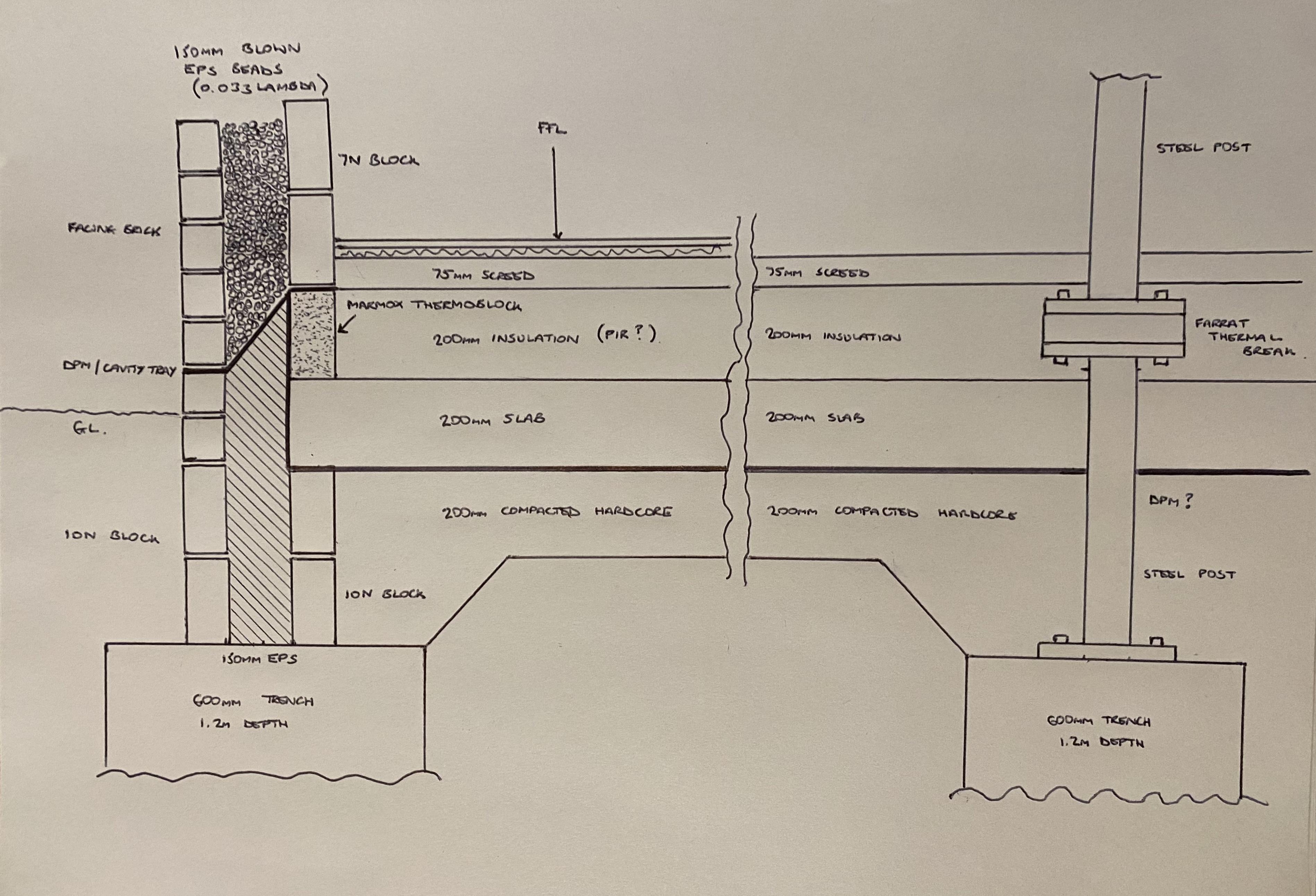

Looking at your plans you'll really need to take care with the thermal bridging.
It's a nice design, in effect its a smaller second story on top of a larger ground floor. The external upper block walls being supported by steel will be the main source of your issues as these will bridge the continuous thermal envelope.  Steel is a tremendous conductor so you could end up with condensation as well as energy loss and discomfort if not attended to.
Ok so you didn’t use the OSB to support the windows then, just for airtightness.  Could you reach in to the cavity to paint the seal to the outer (I’m assuming from the inside? Unless you mean from the outside in which case ours is a brick finish not render).  I like the drilling of the board to pump in EPS under the cavity tray.
One thought I had on the OSB / ply was the ability to build precise openings meaning windows can be ordered up earlier rather than waiting for structure completion given lead times.
Yep I’m thinking of installing MVHR myself so this sounds like a good solution.  Did you have MVHR designed separately or by supplier.  I’ve had a quote from a renewables company that would design, supply and install MVHR, ASHP, UFH and 1st fix plumbing.  But it’s a pretty penny.
Yup it’s occupying a lot of my thoughts without really having a solution atm.  I’m waiting for structural engineer to complete his bit before I then try to work it out / ask for help!!
Correct.
 Yes from the outside. An alternative might be using a proprietary system like that from Illbruck. I've heard good reports.
https://www.illbruck.com/en_GB/solutions/window-installation/brick-block/
Yes. Beware protecting the window boxes whist exposed however.
Eeek! Maybe discuss this with them now. It might avoid a costly redesign. I'm trying to come up with a detail out of interest. I'll see how I get on.

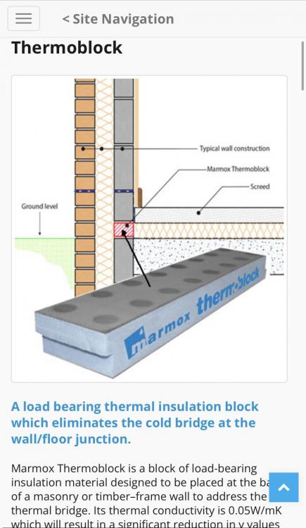

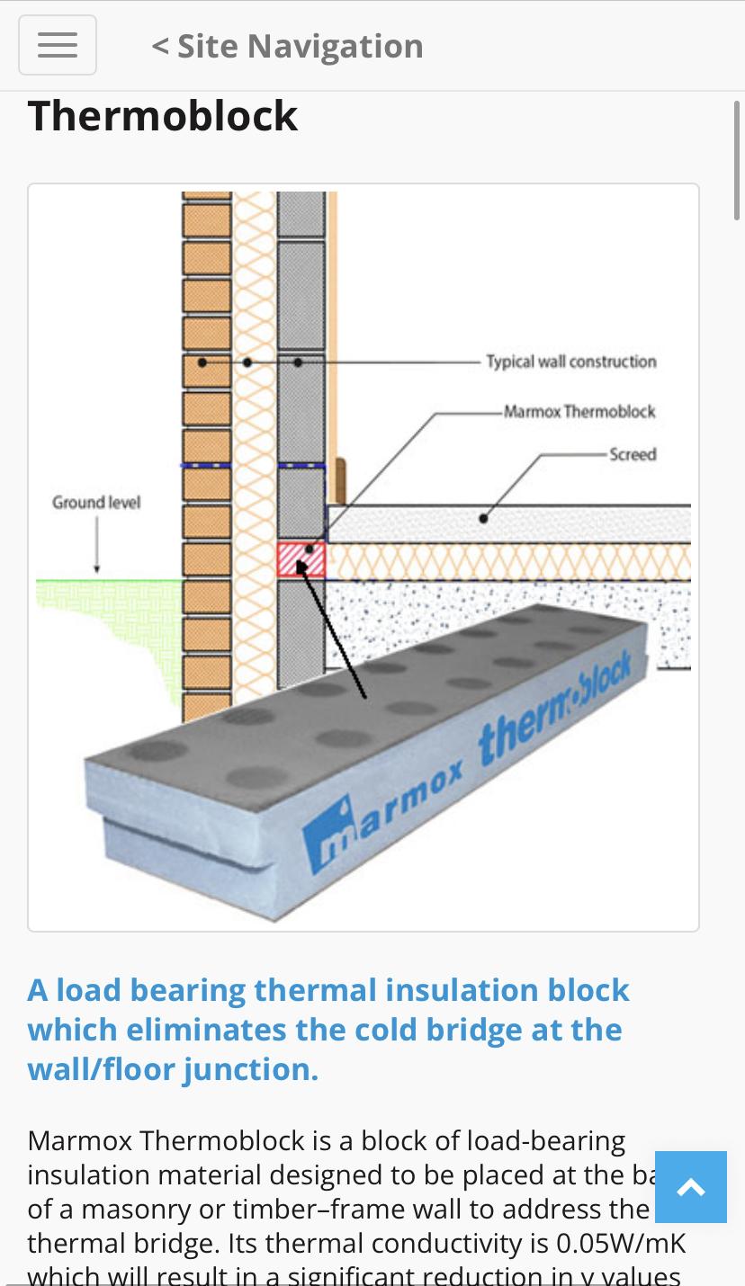

What about something like this??

So I've now received structural calculations.  I think I can decipher some of it but in a 90 page document I'm struggling with a lot of it!
What is evident is although I've brought up thermal bridging there is nothing in here mitigating it.  We have steel connections penetrating the wall for the balcony, steel posts going down to foundations etc.
What next?  I'm not sure who's responsibility it now is to take the structural calcs and turn them into something we can build from.  Do I really need to pay for construction drawings form the architect etc.?  Also whoever that is I now need to take on the journey with thermal bridging...

Structural calcs are there to show what is needed to keep the structure up, how it is done and the nitty gritty details are something else.
balcony support calcs will show what you need, then you need to look at how these can be aesthetically pleasing (or acceptable) and broken thermally broken etc.
same with posts and founds.
don’t think of it as one pig picture, break the structure down into components and taking a look at each of these is much easier and less daunting.

I did my own thermal detailing and the builder was happy to follow it. Normally it would be a part of the job of the architect+team. The structural engineer's main concern will  be to ensure the building doesn't fall down. If you want to get a professional to undertake it I would seek out a passivhaus architectural technician.
Have you considered the option of external insulation, ICF or timber frame. These methods make it easier to cope with any thermal bridges etc but you will need brick slips or similar for the facade/
If you choose to stick with masonry cavity walls a couple of things might make it easier to deal with the steel bridging.
1. Proprietary insulating connections for balconies +columns etc.
2. Using precast concrete beams in place of steel ( cheaper and less than 10% as conductive)
3. Using Marmox thermoblock, perisol or similar as a thermal break above the beams and outer walls.
Beware most of those 90 pages will be standard issue not specific to your house. As for the construction drawings I can't be much help as we have a different process re BC etc in Ireland.
Good luck!
Good luck!
Yep I think it's where I'm getting to tbh.  I think I have my head around where the thermal bridging issues will occur and will just solve them with the builder and suppliers.
I've looked at different build methods but for various reasons we've stuck with masonry and are quite a way down the line.
Thanks for those suggestions, I've been looking at 1&3 and will now look at 2!

So I’ve taken to drawing it up prior to chatting through with builder… thoughts? (Ignore some of my dodgy scaling eg courses not lining up)
