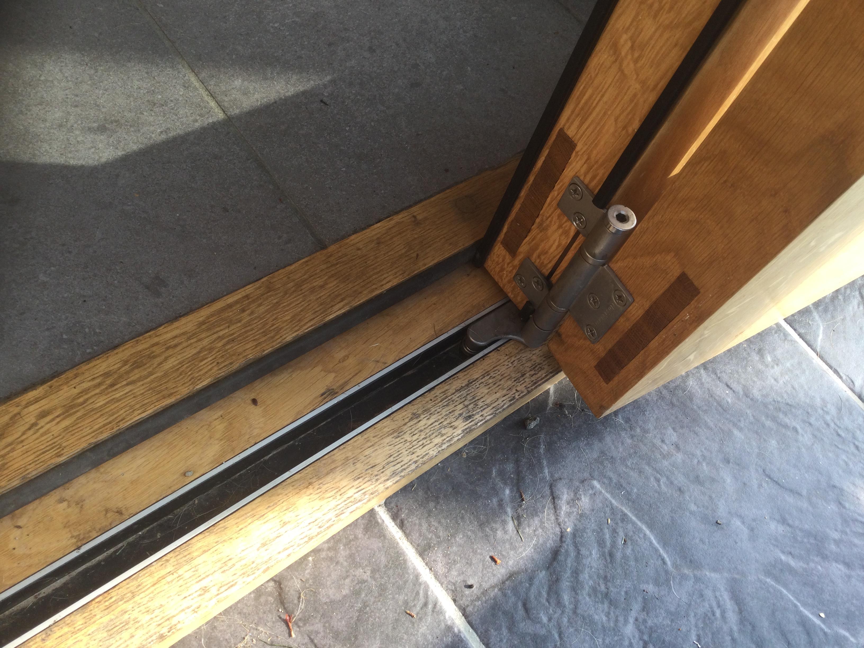

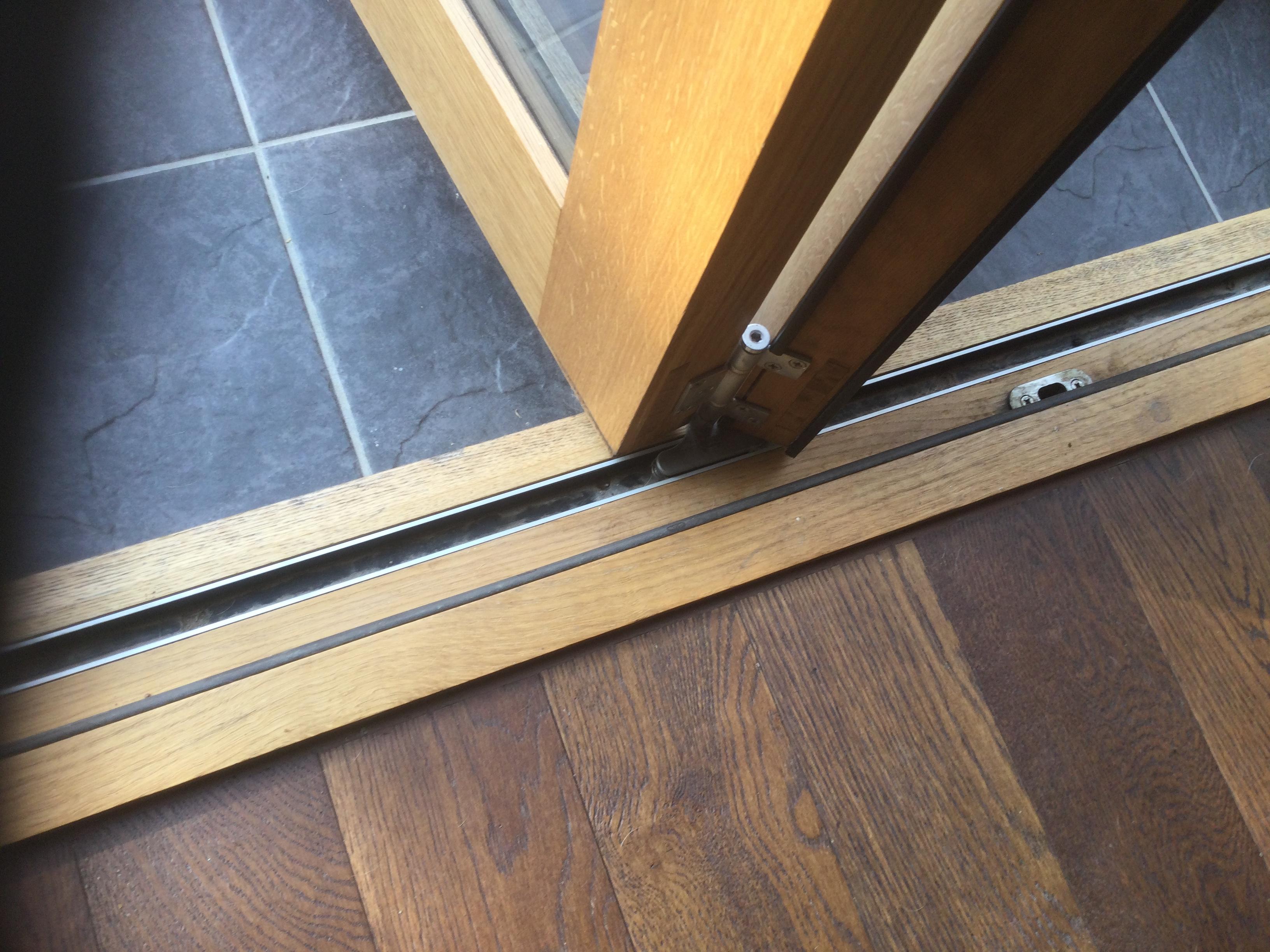

8 hours ago, Iceverge said:
Might you have any geeky close up pics of the seals + mechanisms that differentiate the good from the bad?
Sure, all top hung and fixed to a concrete lintel, compression seals all round .
