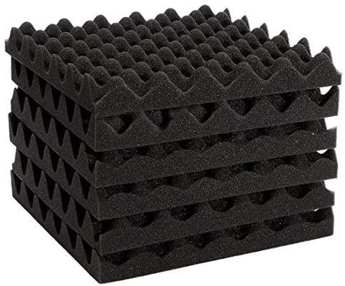

Onoff Posted December 20, 2021 Share Posted December 20, 2021 6 hours ago, puntloos said: Huh. Not a bad idea, but I'm a bit worried about noise levels. But perhaps a painting with a serious backplate can be designed. Which.. kinda is just a door again Maybe some acoustic foam panels would help in the "cavity"? Link to comment Share on other sites More sharing options...
