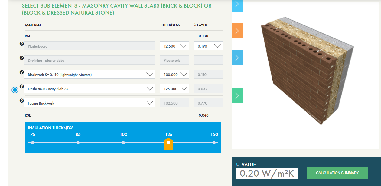

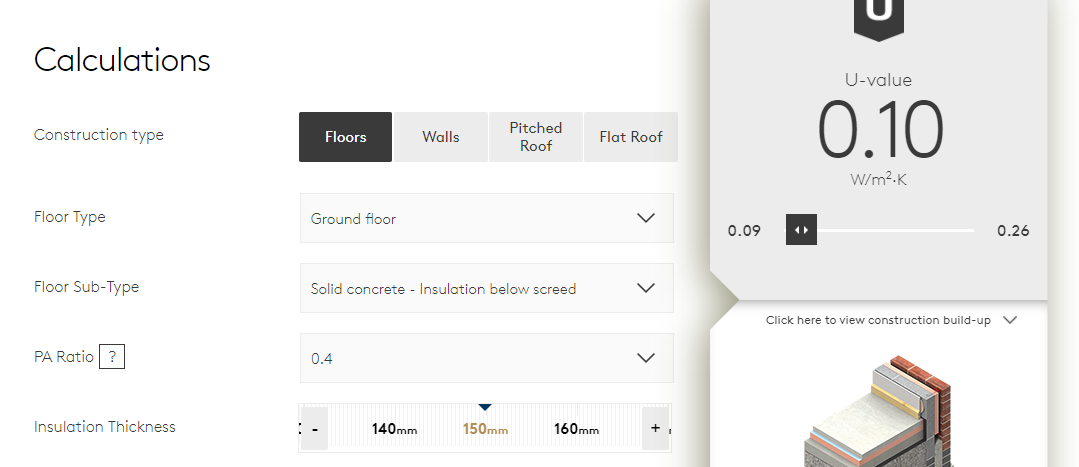

Andeh Posted December 19, 2021 Posted December 19, 2021 (edited) Just looking for general advice! We are at the foundation excavation stage of a 240sqm bungalow, after a last minute refurb --> rebuild change of plans (one of the builders had a cancellation & said he'd do a full rebuild for the price of our refurb if we fitted into his cancelled slot. He was our favoured builder by a decent chunk, so we were/are utterly delighted...but it has meant the architects & builder have had to work overtime in getting all the documentation sorted - hence adjusting insulation details after construction started) As a result, we only recently received our draft SAP calculation of 81 - which I couldn't believe. This was with 125mm full fill cavities. 250mm Jetfloor + 150mm PIR below UFH and 125mm PIR in roof space, MVHR etc - not exactly bare minimum in my mind (though I acknowledge behind BuildHub norms of Passive House standards!!), but I was still very surprised to 'only' get 81. Scores are: Ext Walls 0.22, Floor 0.17, Roof 0.18 Architects have gone away to try and get me a 10% improvement to bring it up to 88/89 (Ecology mortgage as a benchmark, though not using them). However - I looked up the 2019, 3 story, semi-detached naff Persimmon new build we are renting for the duration of the project & was horrified to see it at a 86 EPC rating. I don't quite understand how we are ''only'' at 81 in a £500k bespoke new build with (in my mind) good levels of insulation...yet a mass produced cheapie (£240k for 4 bed...) property in the same locality achieves 86. Does the fact we are building a bungalow impact EPC? Are EPC & SAP the same to compared? How does 250mm jet floor + 150 PIR only get us 0.17!? Hoping to be educated! Edited December 19, 2021 by Andehh

IanR Posted December 19, 2021 Posted December 19, 2021 Your EPC looks around about correct for the U Values. All need to improve. The 250mm Jet floor is 250mm hollow-core concrete is, it not? so not helping with your U value. 150mm PIR on top is insufficient if you wish to build better than building regs. Same for the roof 125mm PIR in the roof just isn't enough, (if you wish to build better than building regs.) As Dave says the walls also need improving, although on a bungalow I'd invest more into floor and roof.

Buzz Posted December 19, 2021 Posted December 19, 2021 1 hour ago, Andehh said: How does 250mm jet floor + 150 PIR only get us 0.17!? It doesn't according to Kingspan , and that is straight onto concrete or B+B .
Andeh Posted December 19, 2021 Author Posted December 19, 2021 (edited) Interesting! Thanks for that, something is wrong there then, as drawings state jetfloor with infill insulation & 150mm rigid insul to achieve! I'll need to investigate Edited December 19, 2021 by Andehh
Buzz Posted December 19, 2021 Posted December 19, 2021 Your wall calculations appear to be out as well , as others have said if you can go for 150mm full fill this will bring u-values down to .17
