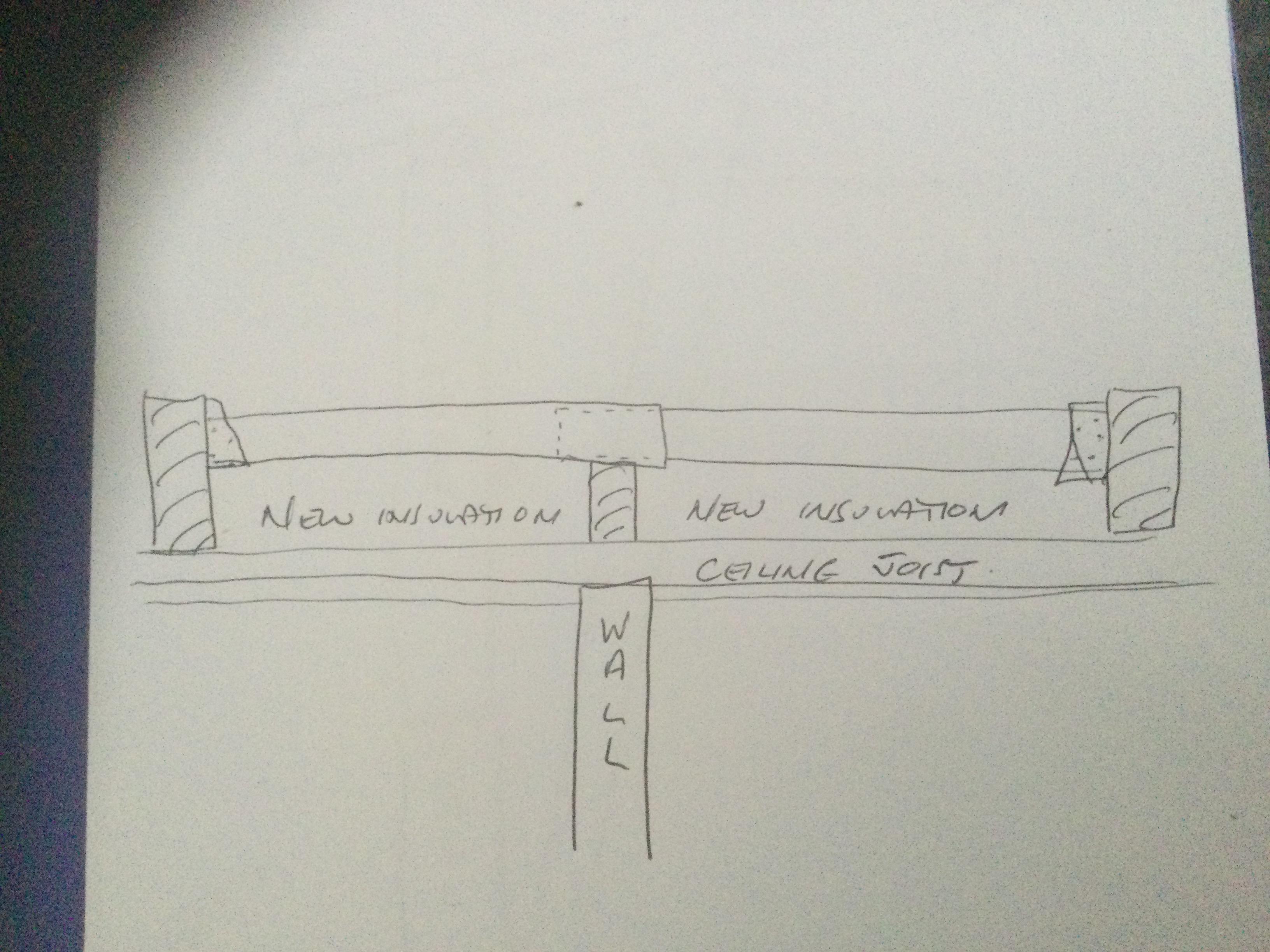

joe90 Posted December 16, 2021 Share Posted December 16, 2021 4 hours ago, ProDave said: would leave the existing poor insulation in place. It would be a mare of a job to remove and dispose of. So just leave it and add more on top. +1, I would use 6 x 2 in joist hangers between those two new timbers, another 4x2 on top of ceiling joists on top of dividing wall to support the other 6x2,s which only need to be half the distance. Link to comment Share on other sites More sharing options...
Onoff Posted December 16, 2021 Author Share Posted December 16, 2021 15 minutes ago, joe90 said: +1, I would use 6 x 2 in joist hangers between those two new timbers, another 4x2 on top of ceiling joists on top of dividing wall to support the other 6x2,s which only need to be half the distance. Do us a drawing will ya? ? Link to comment Share on other sites More sharing options...
joe90 Posted December 16, 2021 Share Posted December 16, 2021 (edited) 1 hour ago, Onoff said: Do us a drawing will ya? ? CAD (crayon assisted drawing ?♂️) if you make the distance from top of ceiling joists to top of new 6x2 the thickness of the additional insulation no wasted space. New 6x2 overlap in the middle so no very long timbers to try to get in the loft. Edited December 16, 2021 by joe90 Link to comment Share on other sites More sharing options...
