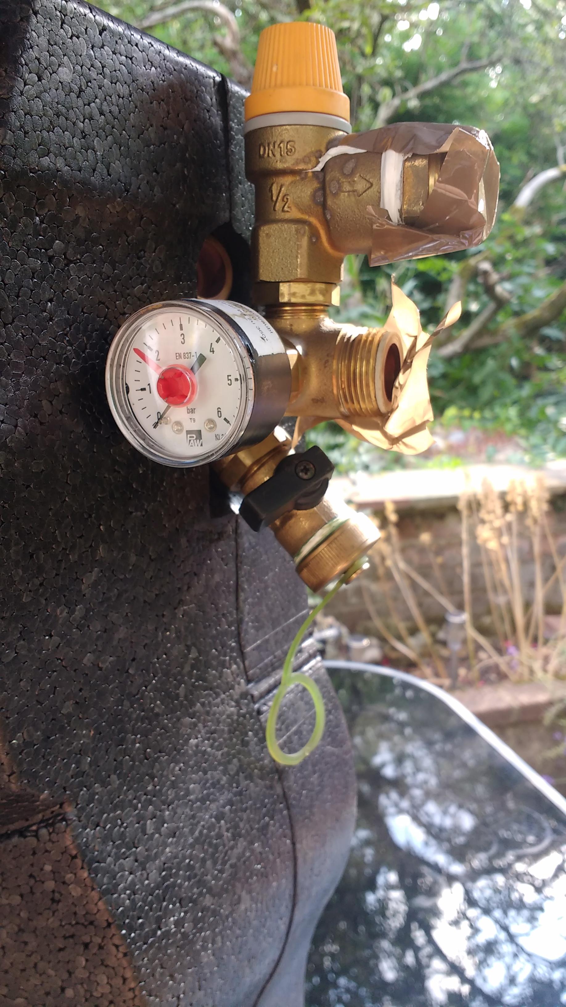

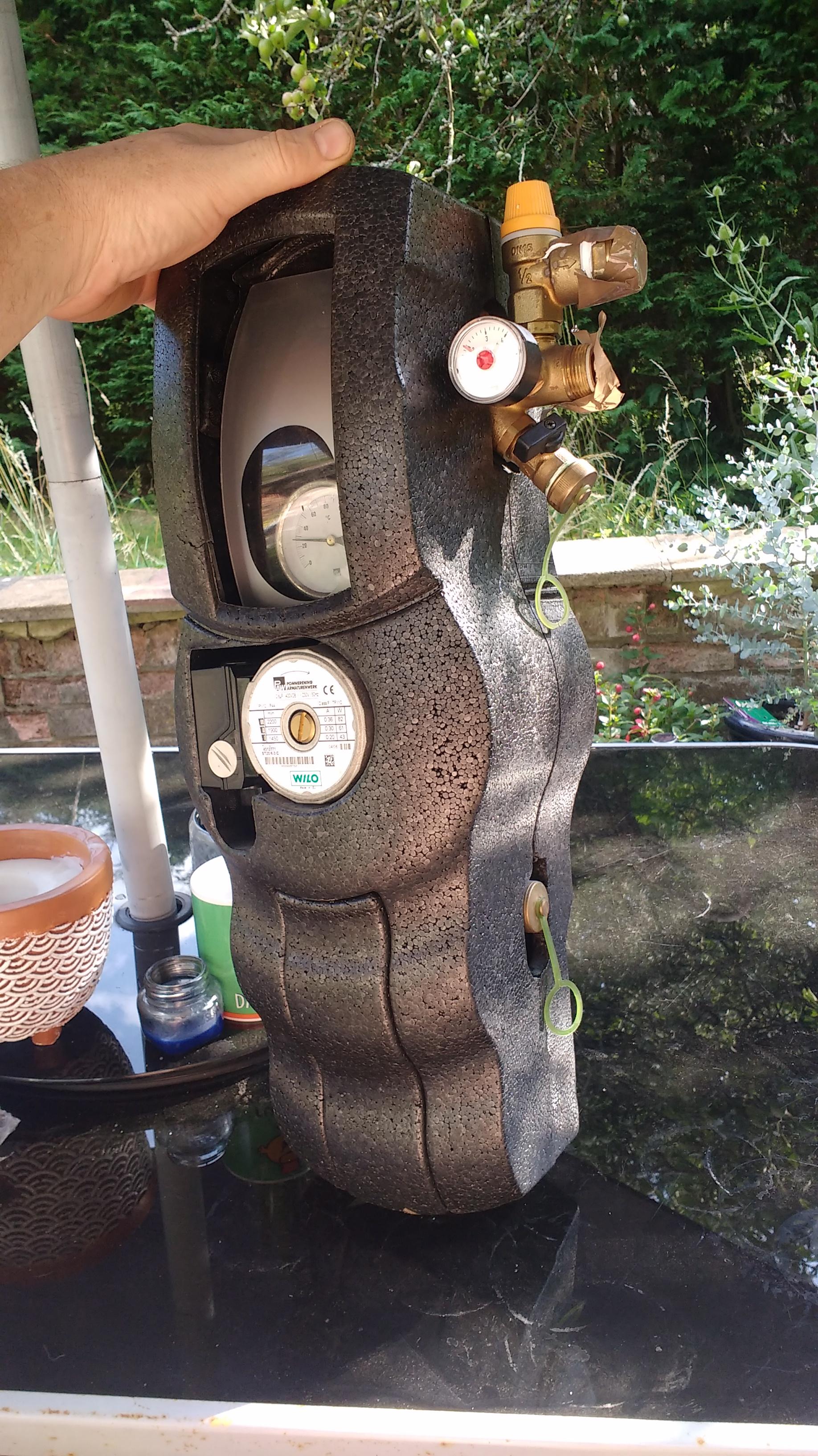

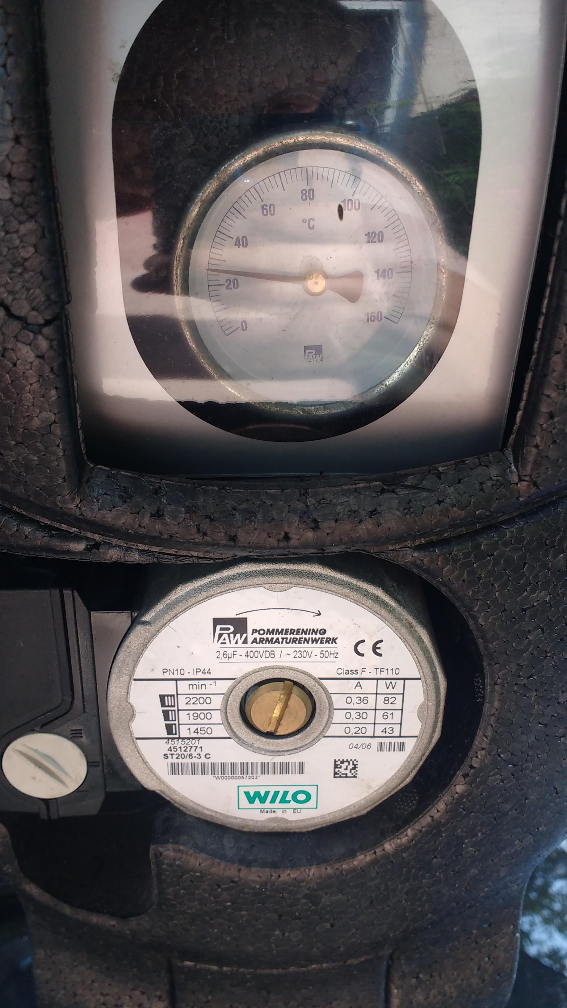

Onoff Posted July 20, 2022 Author Share Posted July 20, 2022 First bits of my solar thermal kit: Link to comment Share on other sites More sharing options...
Ferdinand Posted July 20, 2022 Share Posted July 20, 2022 Just now, Onoff said: First bits of my solar thermal kit: Why is this not made from Guinness cans? 1 Link to comment Share on other sites More sharing options...
Pocster Posted July 20, 2022 Share Posted July 20, 2022 23 minutes ago, Onoff said: First bits of my solar thermal kit: Wtf is it ? Will it generate ufh for the bathroom , that’s all that matters …. ? Link to comment Share on other sites More sharing options...
Onoff Posted July 20, 2022 Author Share Posted July 20, 2022 3 minutes ago, pocster said: Wtf is it ? I genuinely have no idea. Link to comment Share on other sites More sharing options...

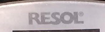

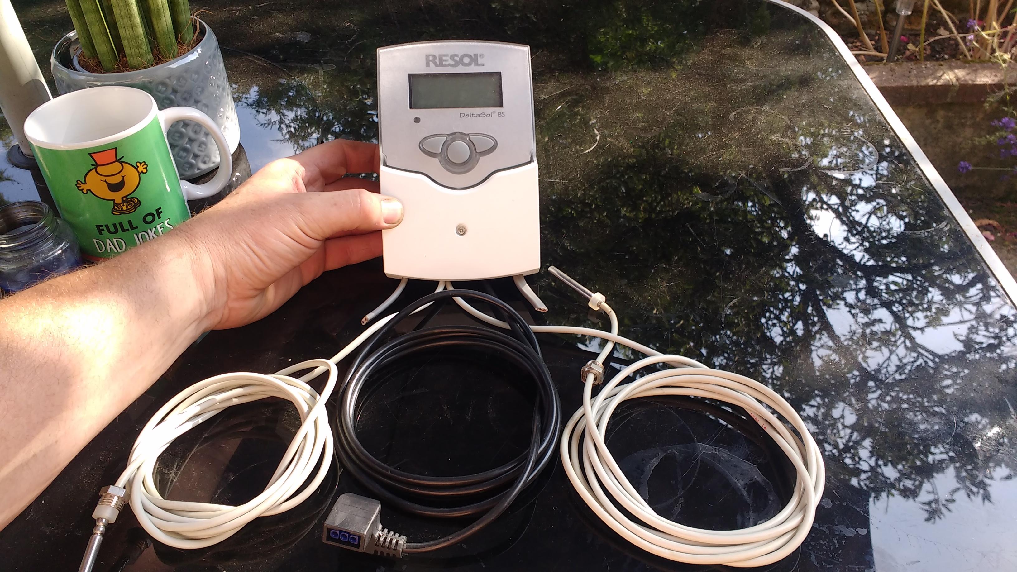

Marvin Posted July 21, 2022 Share Posted July 21, 2022 12 hours ago, Onoff said: I genuinely have no idea. https://www.resol.de › 48005...PDF DeltaSol® BS Plus - Resol 1 Link to comment Share on other sites More sharing options...
SteamyTea Posted July 21, 2022 Share Posted July 21, 2022 Been wondering how that is pronounced. Link to comment Share on other sites More sharing options...
Onoff Posted July 21, 2022 Author Share Posted July 21, 2022 1 hour ago, SteamyTea said: Been wondering how that is pronounced. Like that cream you use; R-Sreeleef" Link to comment Share on other sites More sharing options...
Onoff Posted July 21, 2022 Author Share Posted July 21, 2022 1 hour ago, Marvin said: https://www.resol.de › 48005...PDF DeltaSol® BS Plus - Resol Hoping I might get the original manuals in the next shipment of parts. Link to comment Share on other sites More sharing options...

Onoff Posted July 21, 2022 Author Share Posted July 21, 2022 A good start. Found the manual online for the RESOL Deltasol BS/3 controller. Skimming it at the moment but interesting that it can seemingly be set to divert excess to the CH. Exactly what I was envisioning. 48005410_DeltaSol_BS3.monus.pdf Link to comment Share on other sites More sharing options...
