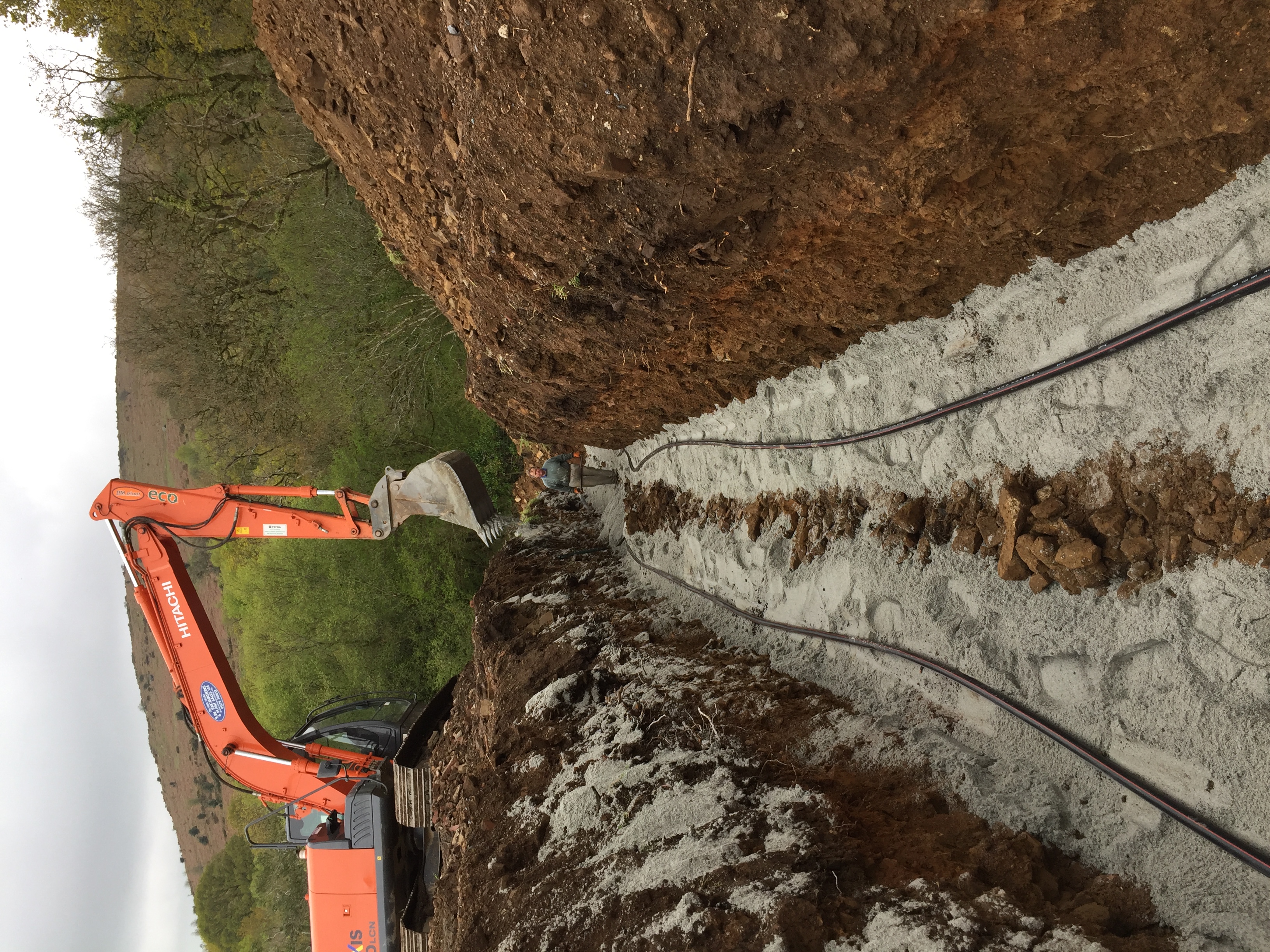

Barney12 Posted May 2, 2017 Author Share Posted May 2, 2017 So after a lot of thinking/deliberating we decided to fit the geothermal heat exchanger. Just the small matter of digging a 50m trench 1.5m deep, 1.5m (ish) wide so we could run the 100m of 32mm pipe. 16 tonnes of sand to bed and cover. All done in one day.........exhausting! 3 Link to comment Share on other sites More sharing options...

Barney12 Posted May 2, 2017 Author Share Posted May 2, 2017 Just now, SteamyTea said: Are you putting in a few temperature sensors? May make for useful data. I did consider it but simply ran out of time to order anything. From everything I've read we have excellent ground conditions for geothermal. How effective the heat exchanger will be is a complete unknown. I'm mainly interested in the cooling rather than heating. This decsion has been my first "gamble". Link to comment Share on other sites More sharing options...
Barney12 Posted May 2, 2017 Author Share Posted May 2, 2017 12 minutes ago, Onoff said: The few on here who have sloping sites that need a lot of terracing etc.....is it I wonder worth laying geothermal pipe then just covering it over if your changing the landscape that much? Dont underestimate the cost of bedding the pipe properly in sand. I wouldn't want to be spending hundreds of pounds on sand bedding for something I "might" use. Link to comment Share on other sites More sharing options...

Declan52 Posted May 3, 2017 Share Posted May 3, 2017 You know how dangerous that is with all the spoil sitting so close to the trench edge. ESP with the first metre of that being made ground. That guy would be squeezed before he had time to say wdf. Link to comment Share on other sites More sharing options...
Nickfromwales Posted May 3, 2017 Share Posted May 3, 2017 3 minutes ago, Declan52 said: You know how dangerous that is with all the spoil sitting so close to the trench edge. ESP with the first metre of that being made ground. That guy would be squeezed before he had time to say wdf. C'mon, at least it wasn't raining. . Link to comment Share on other sites More sharing options...
