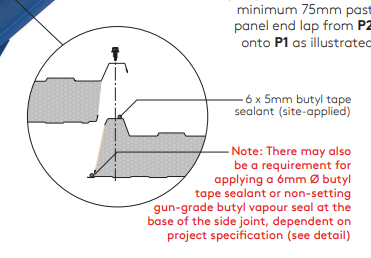

kxi Posted January 5, 2022 Share Posted January 5, 2022 @CalvinHobbes Our building including roof is clad in standard KS1000RW Kingspan panels using 150mm quadcore insulation. https://www.kingspan.com/gb/en-gb/products/insulated-panel-systems/insulated-roof-panels/quadcore-trapezoidal-roof-panels-ks1000rw It is unusual for a house, but very common for other building types. There's another buildhubber who self-installed them on their dairy conversion roof. We don't live in it yet, but so far my quick summary: - Can be very insulating and is inherantly thermal bridge free, though you need to detail this at the edges to avoid the metal thermal bridge of the inner liner - In theory can be very airtight, but there are some issues getting this detailled right - Looks just like metal roofing i.e. very neat, and available in large range of colours, but likely not going to be accepted anywhere but rural I'd guess - Can easy drop in insulated plastic rooflights anywhere. These are not see though but allow you to have natural light wherever you like (subject to planning etc) https://www.kingspan.com/gb/en-gb/products/daylighting-systems/rooflight-systems/daylite-trapezoidal-rooflight-plus-ks1000-dltr-plu - A bit noisy in the rain it seems. If you had an additional layer underneath i.e. plasterboard ceiling, not sure how much this would attentuate this. Crossing our fingers on this one, but many people live in metal roofed houses, and rain noise is one of the sounds people play to help them sleep - Cost effective considering you get all the layers in one go - you get the whole roof build up for the same price (perhaps even cheaper) than a seperate metal roof - Fast to install and in theory fairly simple, but likely not something most builders have done (our cladding was done by firm that does loads of it) - Lightweight and partly self-supporting meaning you don't need as many purlins - Penetrations are tricky, but not impossible - Don't use them for walls (long story) 1 Link to comment Share on other sites More sharing options...

kxi Posted January 5, 2022 Share Posted January 5, 2022 2 minutes ago, Gordo said: the cold humid air came in through panel joints, condensed in the joint and then dripped Our panels have the internal seals inside the joint top and bottom which should keep it air & water tight (each end is also capped off, which now i think about it might not be done well). The cladder warned that IF the outer seal ever water leaked you don't want to trap anything inside them. Hence they sometimes omit the inner seal to allow the joint to drain out. My problem is the inner liner is the air barrier and I want it very airtight, so no way I could omit the seal, so it may just trap any leaks. I'm in two minds about whether we'll need to air tape / sealant it as well from the inside but hope not to. I guess in your case it might have been the outer sealant became brittle after 20 years and started to let in air? Hopefully someone will have come up with a good solution by the time mine starts to leak. Link to comment Share on other sites More sharing options...
Gordo Posted January 6, 2022 Share Posted January 6, 2022 19 hours ago, kxi said: I guess in your case it might have been the outer sealant became brittle after 20 years and started to let in air? Hopefully someone will have come up with a good solution by the time mine starts to leak. The outer metal cladding projects the panel to overlap adjoining panel. The double sided tape failed (other issues as well). Only proper remidy was to relay panels with a butyl rubber tape between overlap (seem that tape is a premium option which is often specified) Link to comment Share on other sites More sharing options...

saveasteading Posted January 7, 2022 Share Posted January 7, 2022 2 hours ago, kxi said: rated at 0.8W/m2k, Good info thanks. The detail you show is better than many, But you need a bigger area than with glass for the same light, so more heat loss. 2 hours ago, kxi said: same lapping with a seal as the metal panels Yes, that is the best detail. But the best steel will last a lot longer than the best polycarbonate (which is much better than fibreglass). Also the screws pull the steel very tight, whereas you have to be gentler and use extra big washers over the plastic. I know that there are many more leaks at skylights than at metal joints. Plus birds sit and peck at the plastic. 2 hours ago, kxi said: how sealant can also be applied at the base of the panel side joint That is new to me. there is a foam compression filler there, so they seem to be acknowledging some concerns. Never had any air test problems due to standard cladding, only when special details had to be formed for aesthetics. When I read your piece I hadn't thought of using these rooflights in a domestic setting, so was thinking of plonked on feature skylights. I agree that metal cladding can look fine for domestic, even in an urban setting, as long as it is like this profile and grey, as it looks like an old zinc roof, only modern. Some of my concerned comments are related to flattish roof slopes, and diminish on domestic looking slopes, but composite is horrible to lift and fix on steep slopes. Link to comment Share on other sites More sharing options...
